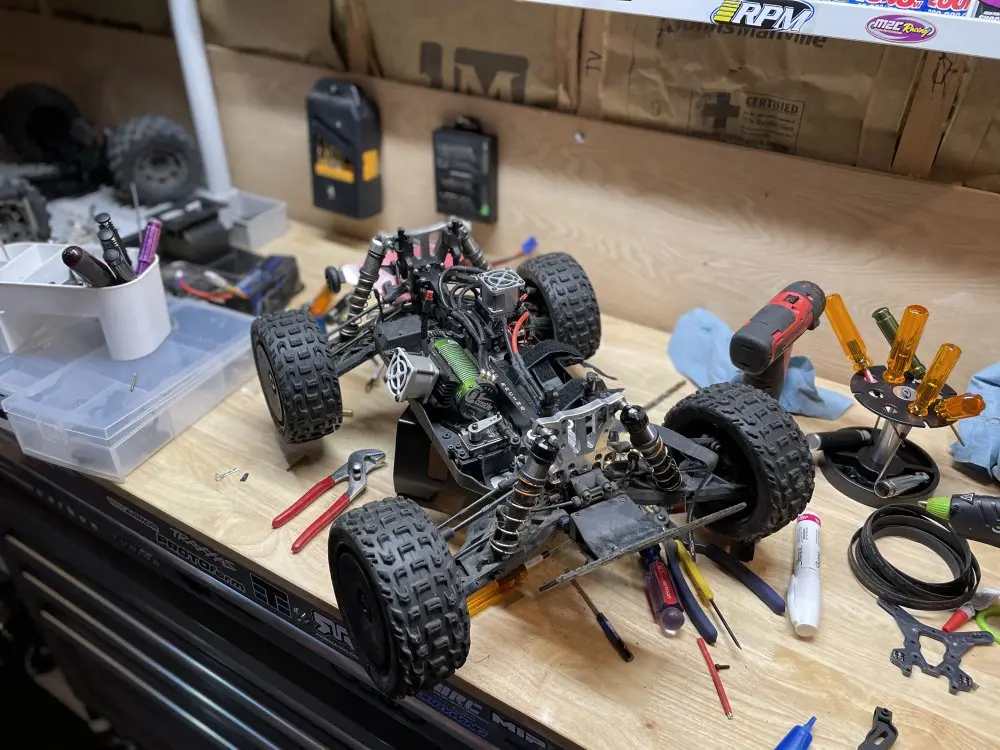

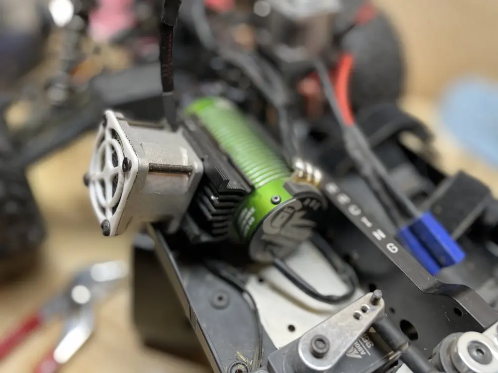

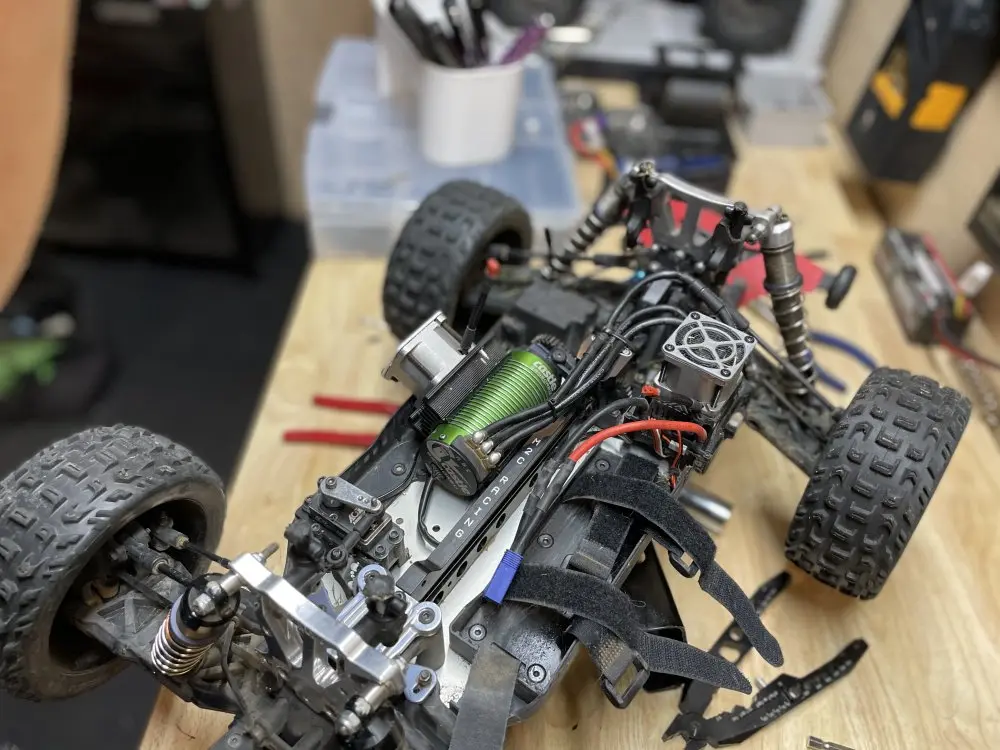

I’ll post up some pics today! I work nights so I just saw your guys comments! Ill post a video up on my channel of a little walk around also!
Tekno_craze
108
92
Here’s some pics! Video should be up soon also!

thanks for taking the time and posting the pics bro. your's looks real similar ;) got mich's heavy duty shock towers and all the braces too. I'll post a pic when I get the 1520 in there. am thinking of relocating the receiver and putting the esc where the receiver is. did you consider that? btw love your fans!
Thanks for the pics. So both the 1520 and 1717 were good choices? Do you think both could be run hard with big tires in hot weather WITHOUT any motor fans? My goal is definitely no motor fans. Maybe the 1717 was overkill for this weight of truck so you'll keep the 1520 in it? ESC can't go in the regular spot with either right?
I personally prefer the 1520 solely because it’s lighter and seems to have a little more top end pull vs the 1717. The 1520 could be run all day without a fan and wouldn’t even break 110, granted you’re only running 4s.
