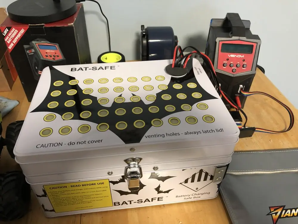

I purchased a Bat-Safe a couple weeks ago. It’s purpose built for charging lipos!
