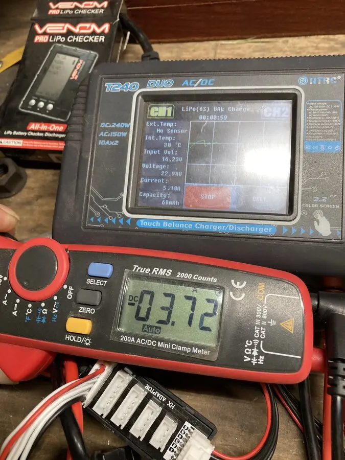

I got a better battery charger now same as shown in the upper picture. 👍
