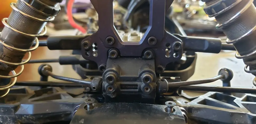

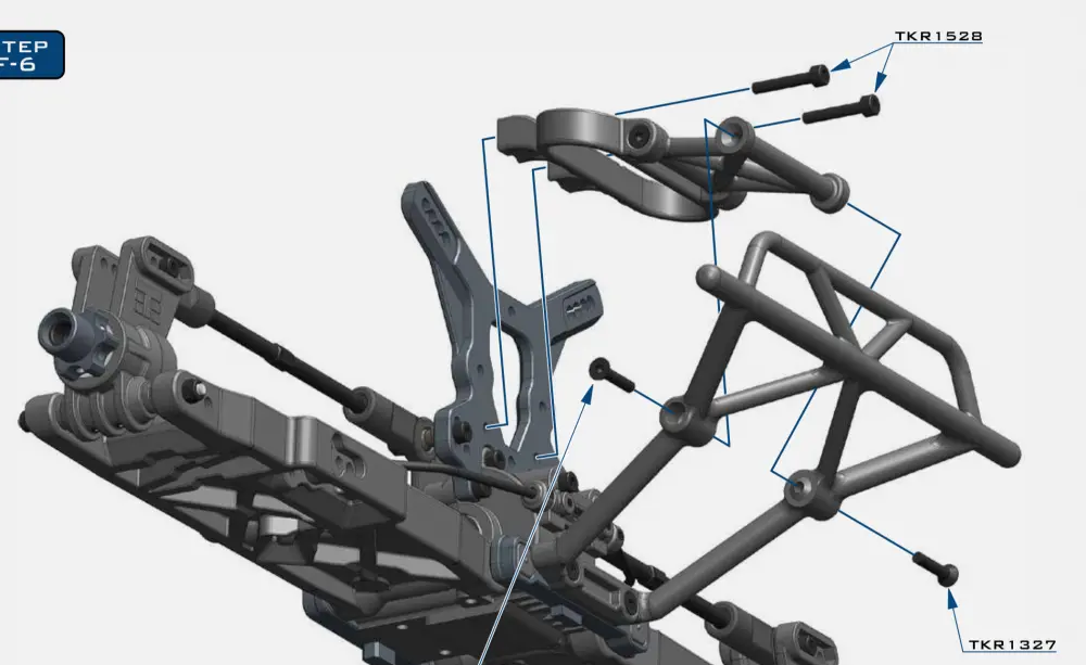

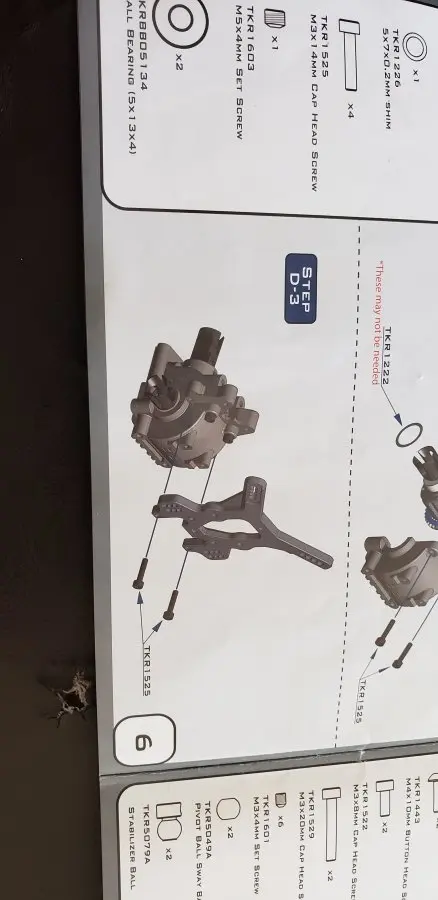

As always, while fixing some thing you broke, you notice some stuff. So, I snapped my front shock tower off my mt410, while looking at the instructions to find the part numbers to fix it I noticed there is no clear instruction to install two more m3x14mm screws on the top part of the shock tower. See attached pictures. I see no reason not to add these screws and increase durability. Thoughts?

I could be wrong but I believe that would be where the stock bumper mount would go so if you are not using it then adding some shorter screws like you did would be fine. If I am looking at what you are referencing correctly that is.

Excellent catch! I'm running the tbone racing front bumper, which would explain the missing screws. So I guess an adjustment to the PSA is needed. If running tbone front bumper, dont neglect to replace the top screws!
Ya, you defiantly want something there. I run the tbone front and rear but I also added the M2C Racing tower support up front because I bent the front tower and I kept killing the body mount so it's all sandwiched in there nice and tight now.
