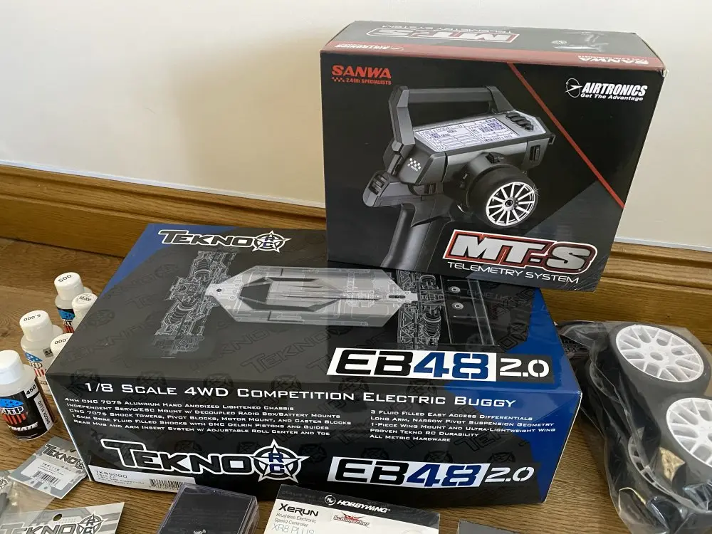

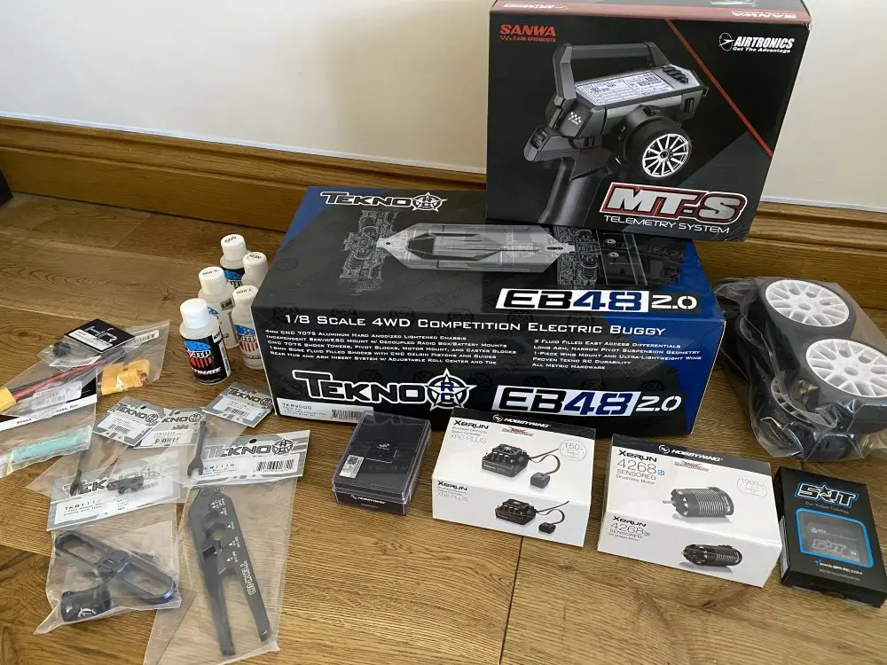

Yup thats what Ive ordered - the Sanwa MT-S. It should do me perfectly fine!! lol
Mannnnnn........this delivery/shortage situation is so annoying!!

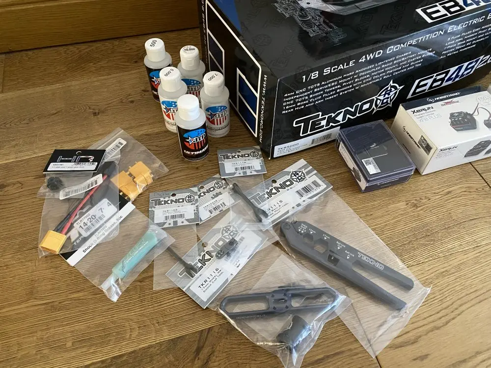

All my other bits are sitting ready to be sent to me - just waiting for the kit!!!!
FINALLY!!
EB48 2.0's in stock and mine has shipped, at long last!!!!!
FINALLY!!!
Now I can start my own build thread!!!

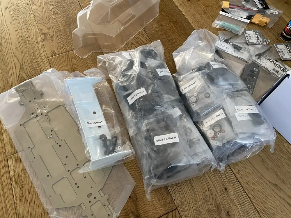

Built bags A and B today (all diffs)..
Been documenting in detail. Will start a build thread soon aimed at complete beginners ;)

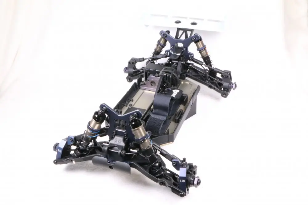

Completed my build today!
Still need to install all my electronics, but the kit is complete. No issues whatsoever.
Took plenty of pics for a full detailed write up. Coming as soon as I get some time!!!

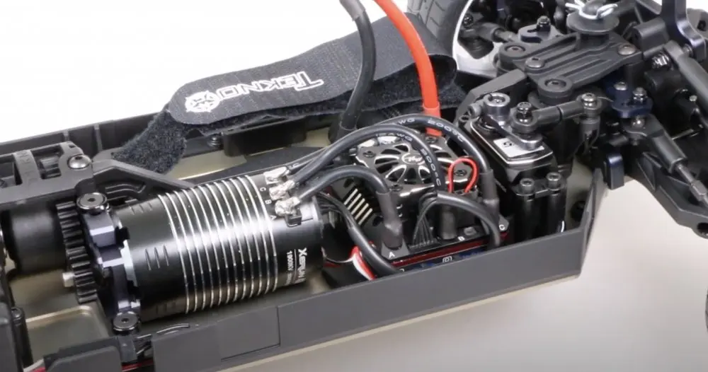

Just interested to see in which order do you generally install electronics.....
Do you start with getting the motor and ESC into place, then the receiver and then the servo last (since it needs to be powered and centred etc)?
Or do you get the motor and ESC connected to the receiver, then power and set up, before anything else?
Servo installed on the mount, then servo assembly put on the chassis. Then I like to install the motor loosely on the mount so I can see how I want the esc to be oriented. Next I place the esc (just resting it, no tape yet) in the orientation I like, if I can solder the motor/esc in the car I will tape the esc now, if not I will put leads on the esc outside the car and then tape it to the tray. I then install the rx box bottom and tape the rx in. Install the mudguard and route the servo and esc wires through the guides and into the rx box. Solder up the motor and you're basically done.

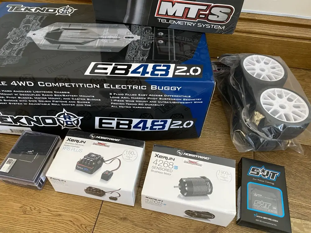

@Ifti how have you got on with the electronics. Was looking at the SCT version as it's a bit smaller, but I can get a combo kit of the plus with the HW motor. https://www.modelsport.co.uk/hobbywing-xerun-combo-xr8-plus-4268-b-1900kv/rc-car-products/420928
Stock shortage everywhere!
Does the plus version fit well?

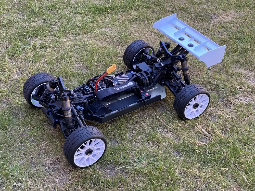

Yes, all fits perfectly - like it was made to measure!
Even managed to get the power switch to the other side, just behind the battery tray.
My soldering isn't great, but its attached and all works! lol
got mine from RPRCDistribution and came for £249 - so a bit cheaper. Not sure if they have stock at the moment or not though.....

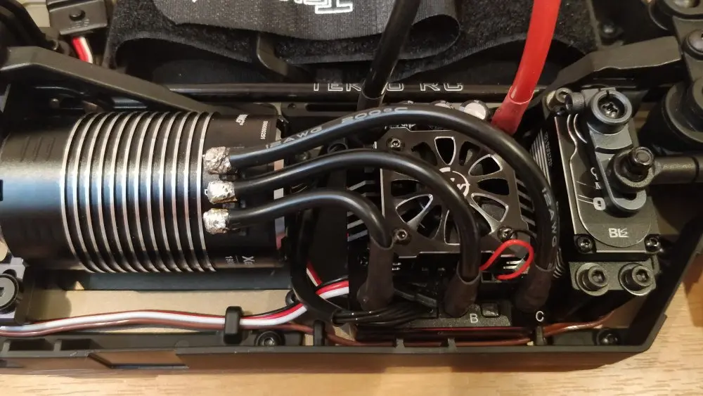

So this is my electronics set up.
Soldering is not my strong point. But they all seem attached!
Guess I wait to see if any break...

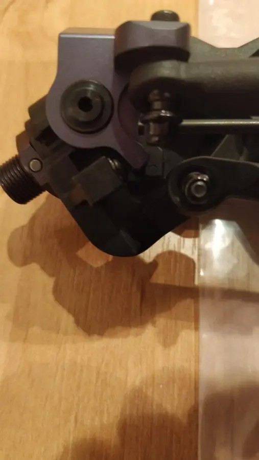

Servo is getting scratched by the horn. And also I'm not convinced turns left as much as right. My EPA are reduced to 75% on the left on the transmitter to stop it hitting the stop screw. Not an issue with the right side.
What do you mean when you say "...to stop it hitting the stop screw." ? Where exactly is it hitting? You should be able to achieve max throw in both directions. 75% EPA sounds too low for any transmitter, especially when using the inside hole on our servo horn.
If for some reason the servo horn is too low for your servo, you can space the horn up with a washer/shim/spacer so that it no longer hits the servo body.

Will get a washer.
As for hitting..... Its here....
I've no clue, I've moved the servo arm to the inside hole and that improved stuff, but I've got an EPA 100% for the other side and EPA 75% for this side to stop the hitting.
