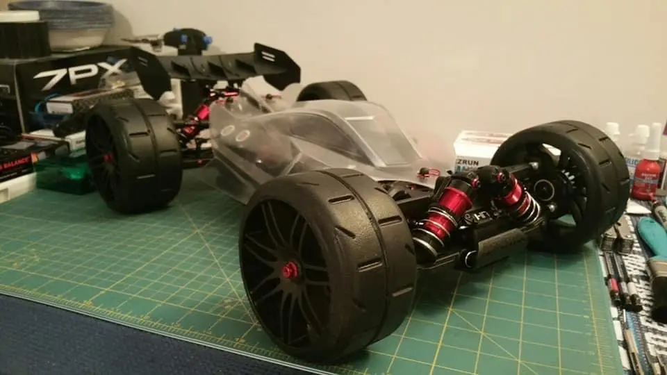

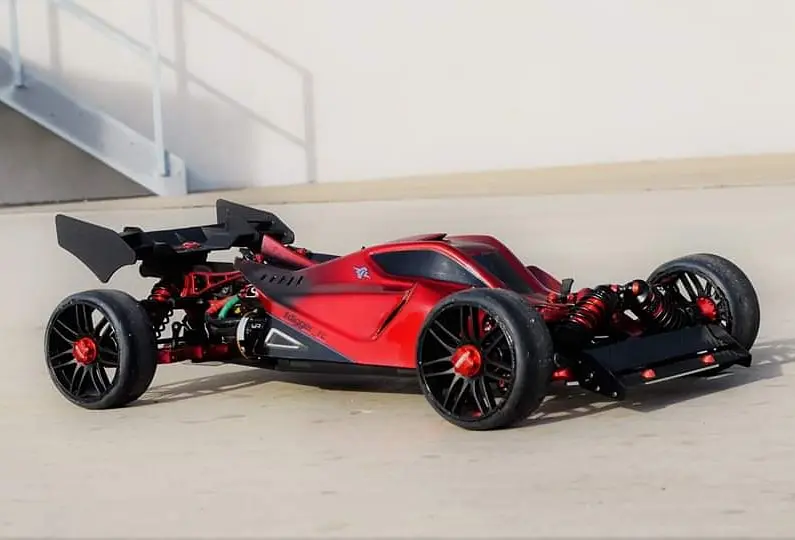

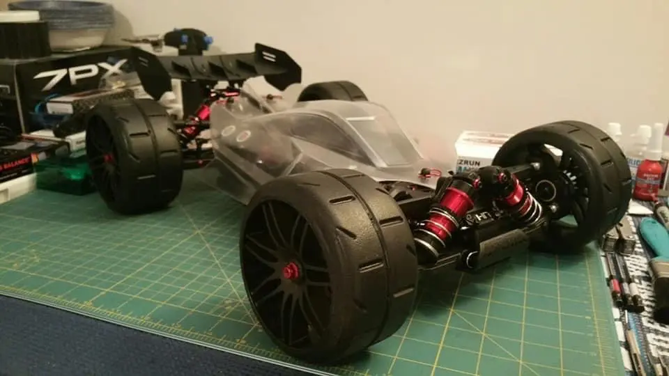

1) May use the Truggy chassis to increase the wheelbase which will make it a little more stable but mainly for room under the body as I’d ideally like to run 6S

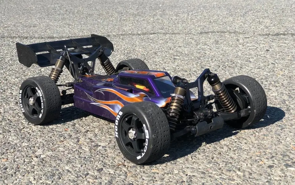

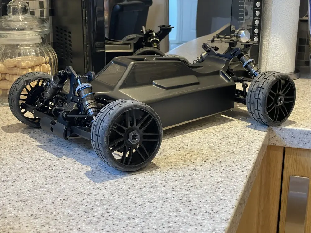

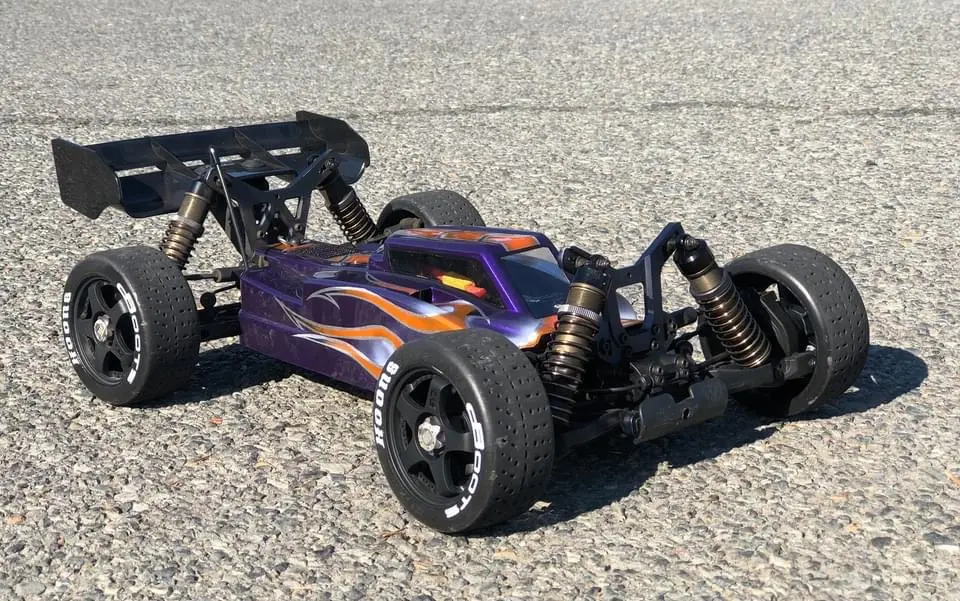

This type of stretched look

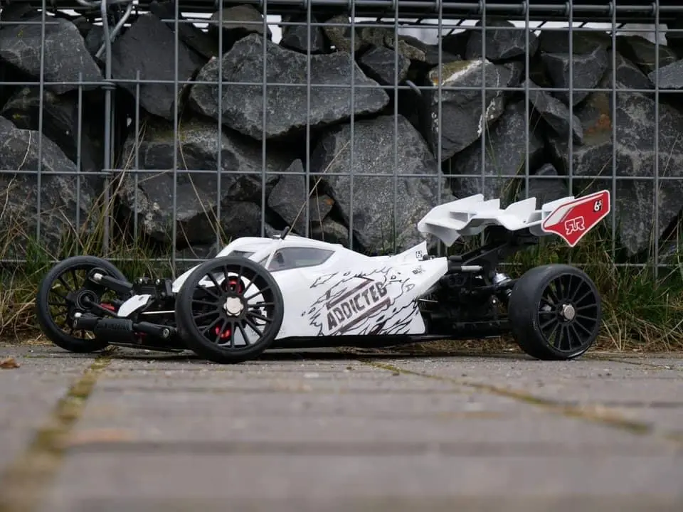

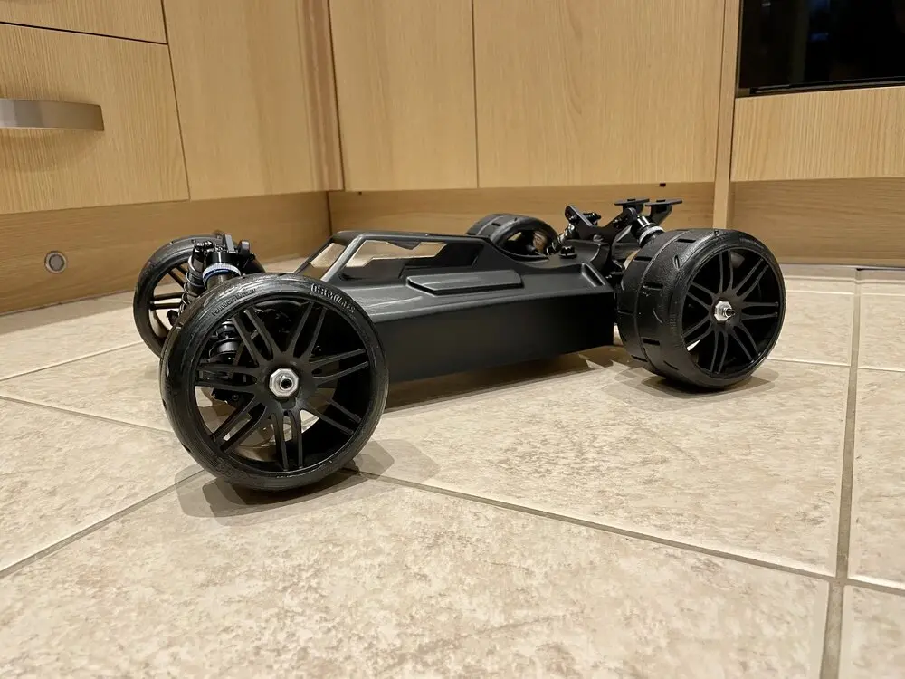

2) Wheel/Tyre choice? Well I have 1/5 18mm square hub adapters so I could run some big ar$e 1/5 GRP’s which used to be popular but now we have more 1/8 offerings from GRP, Arrma Hoons and now Proline are releasing some road wheels along the same lines
This is the 1/5 GRP look
Or go with the more standard 1/8’s so like this
View attachment 7492 View attachment 7493

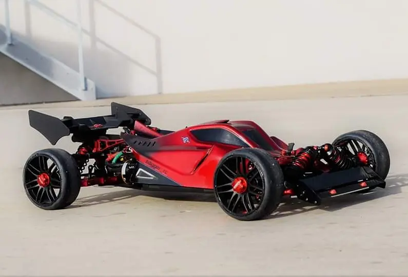

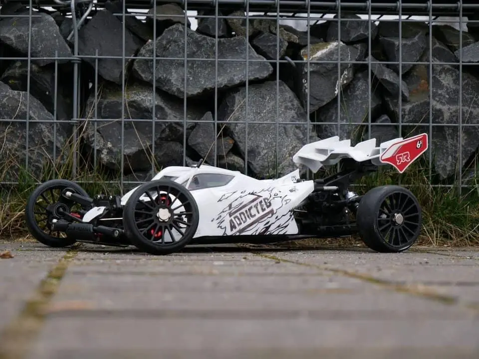

Those pics are sick man
they most definitely make me want to build a concrete killing rig like that

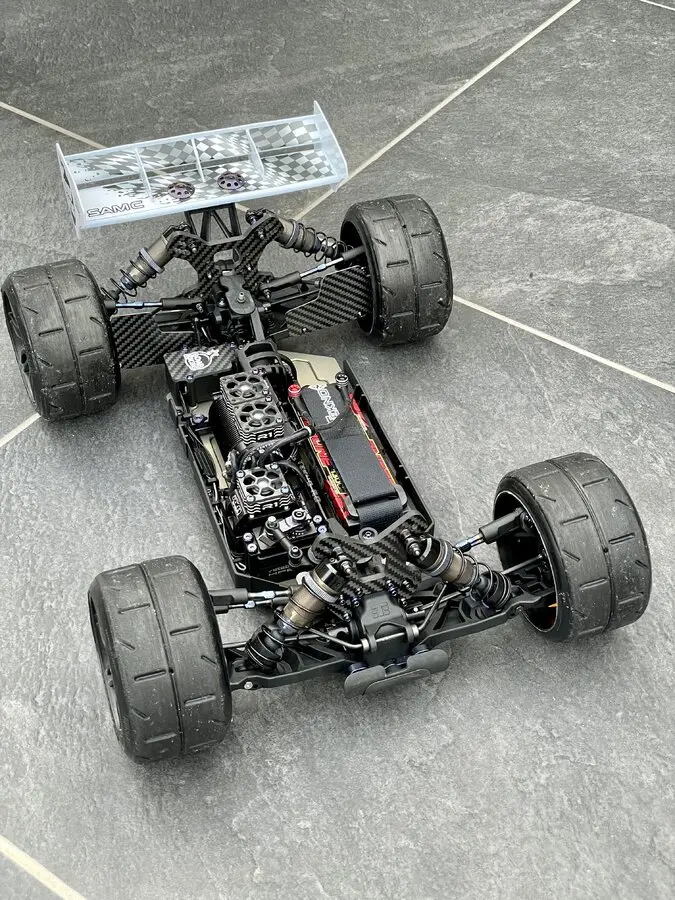

Any updates Buddy?
Well buggy and all the options have arrived, I’ve just finished and given my ET a shake down!
Just picked up 3 XB2’s to build and my mates Lasernut to fix so I’ve got a few to sort prior but all the bits are in and I’ve got a CF fabricator mocking me so low profile shock towers and Serpent lower shock mounts work and extend the shocks mount point so I can continue running stock shocks with the LP towers
Motor wise I’ve got another RX8 and 2000kv Tekin I’ll run on 6S for now but I do have a stock ET chassis if I need to extend the wheelbase to fit a larger motor and ESC, thinking MMX8S and 1520 motor
The body is going off this week to get painted
I recon a couple of weeks though sadly

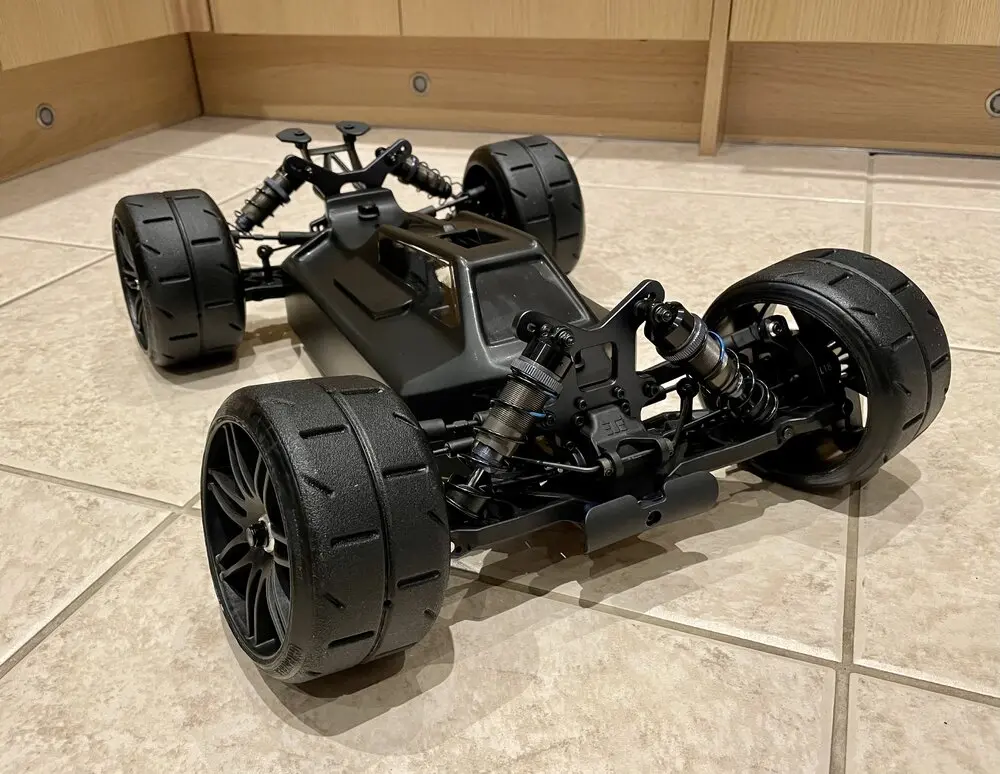

Evil t. I just finished building a road basher with an eb48.3. Things an absolute blast. Handles great, Drifts amazingl I'm running an 1800kv w/rx8 3 and a 18t pin on 4s. I’m not a speed guy so am happy with 4s! Thnx for sharing…👍

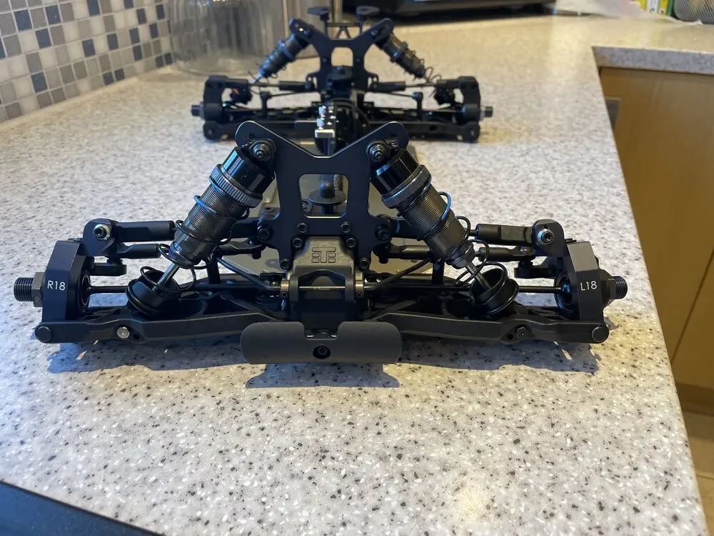

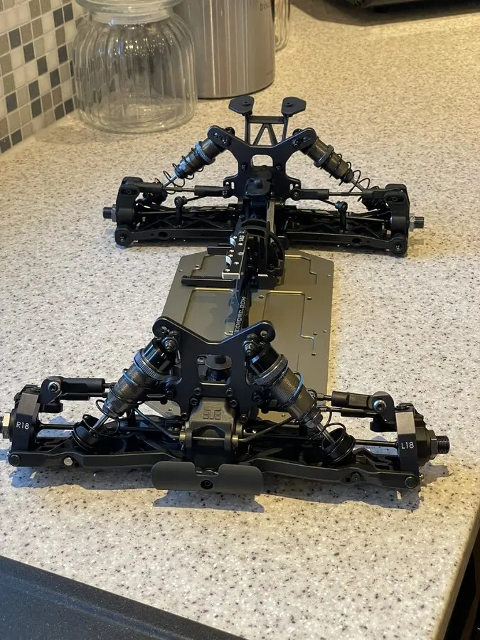

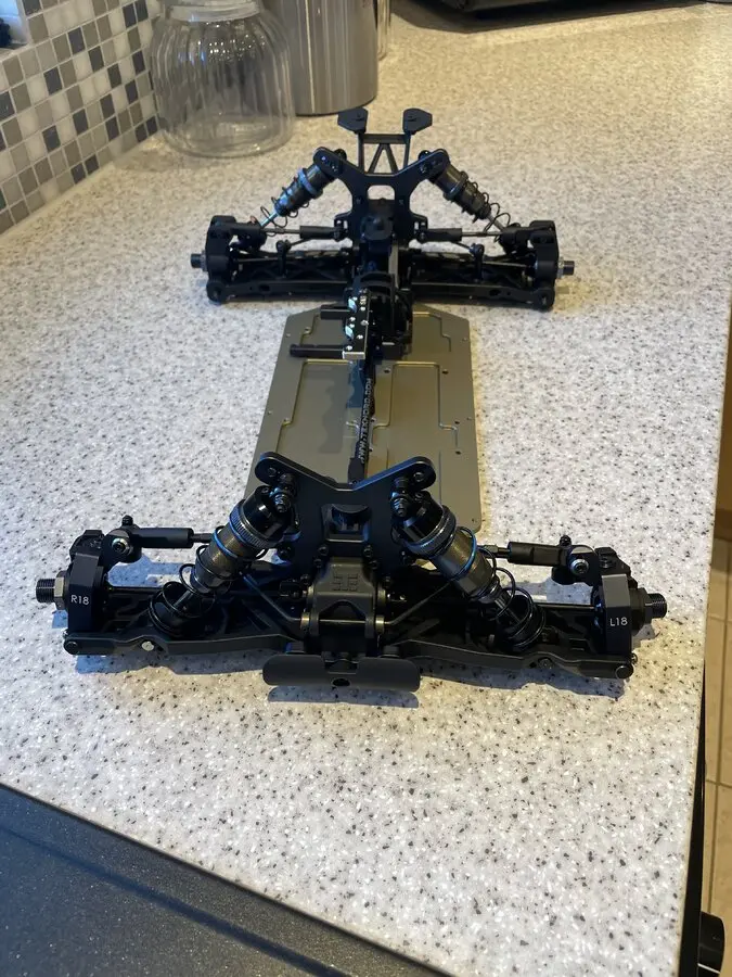

Sorry for the delay I had to built three 1/10 2WD buggies first.
So I’ve built the rear end and at the point I need to decide if I’m sticking with stock length or fitting the Truggy chassis.

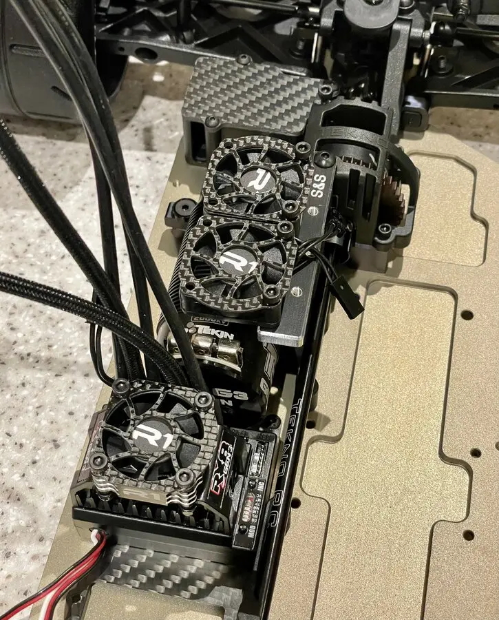

90
78

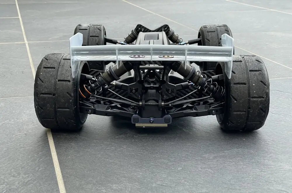

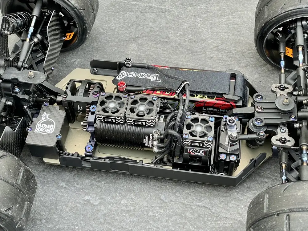

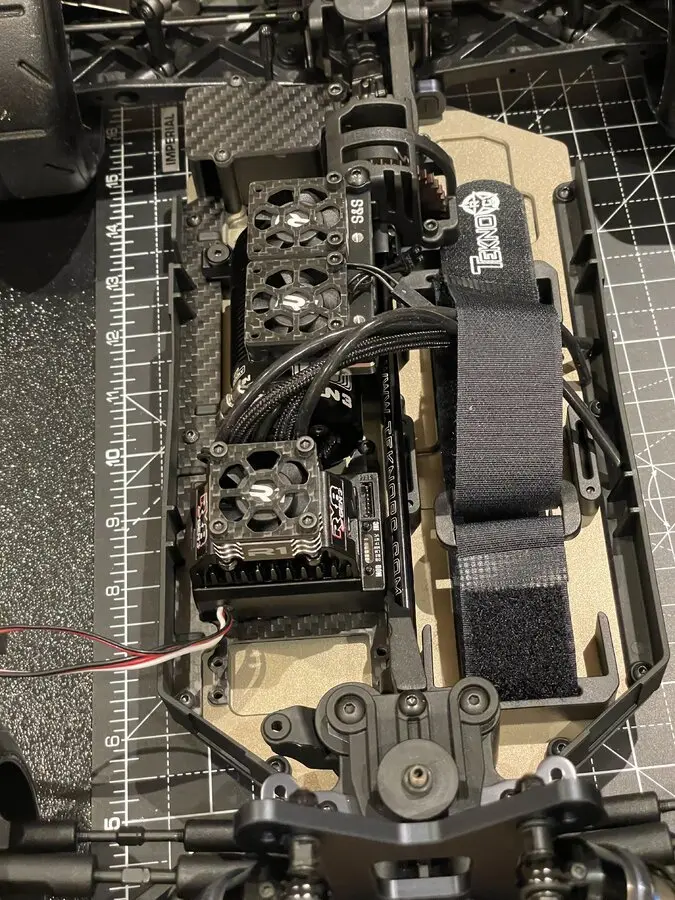

Wasn’t sold on the fan guards, the quality is great on them so will use on another build but feel this style suits better

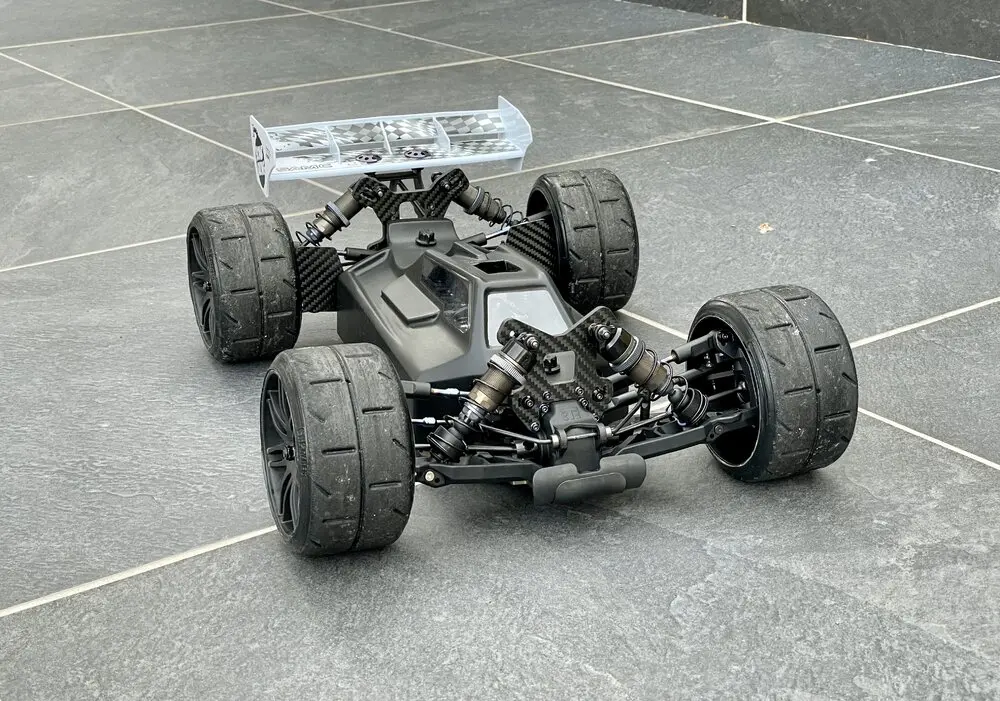

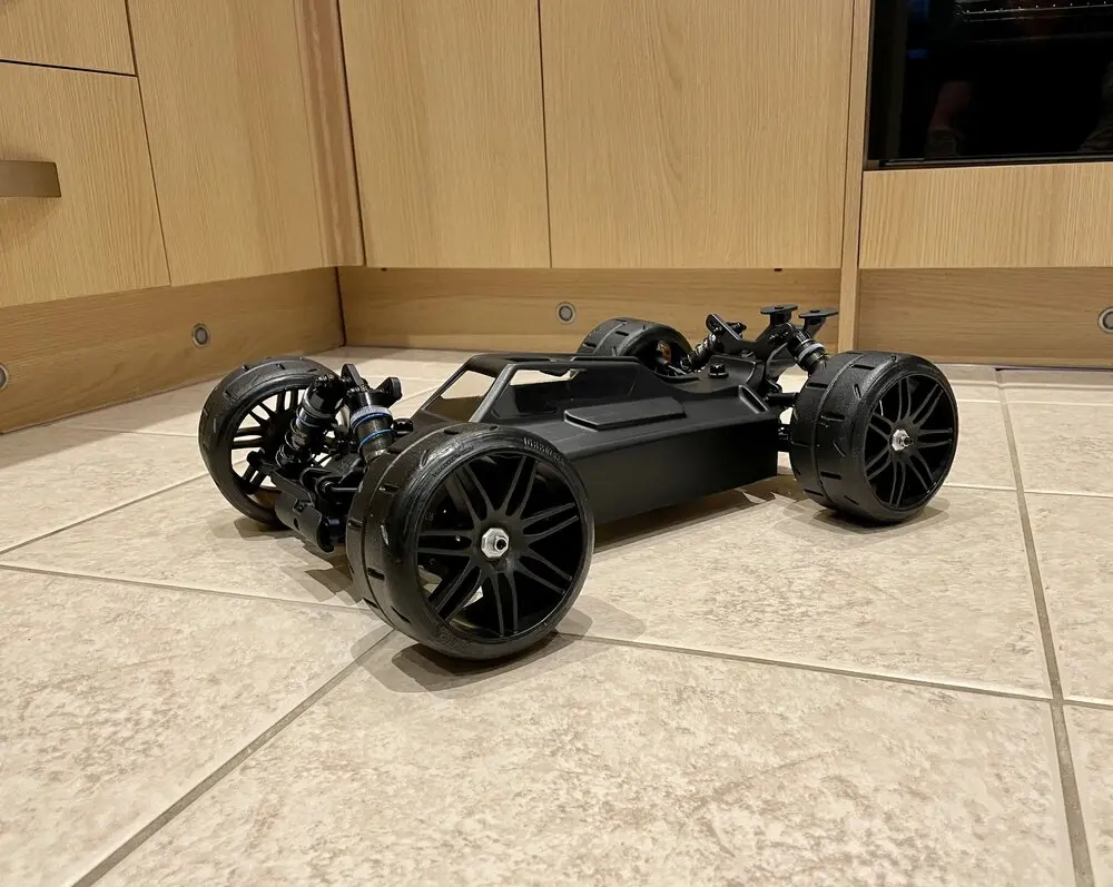

First run today on 4S, this is going to be mental on 6S 😈
