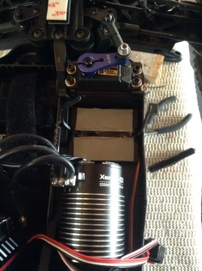

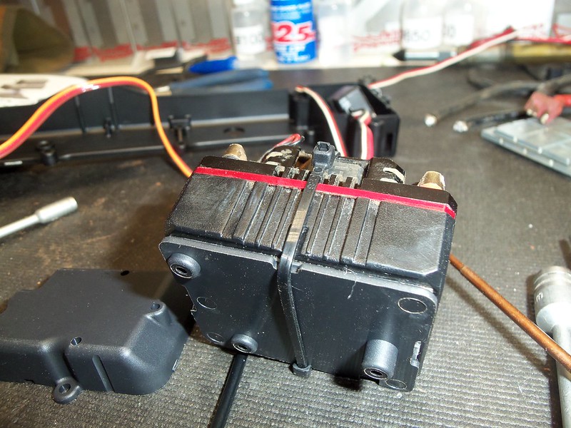

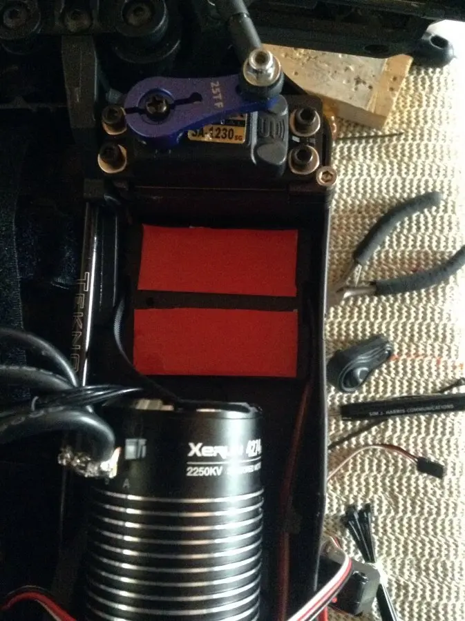

I have stopped using it because I still had ESC's get damaged with it... I have since switched brands and exclusively run HobbyWing ESC's in all my cars. HobbyWing tends to last the longest of nearly a dozen brands that I've raced with over the years and HobbyWing offers a deep discount for an RMA on any damaged ESC's outside warranty.
The single most important thing when installing your ESC is to secure it with zip ties around the ESC mount!
I also trim the notch ESC mount so the black plastic is flush with the width of the ESC so you don't warp the ESC mount.

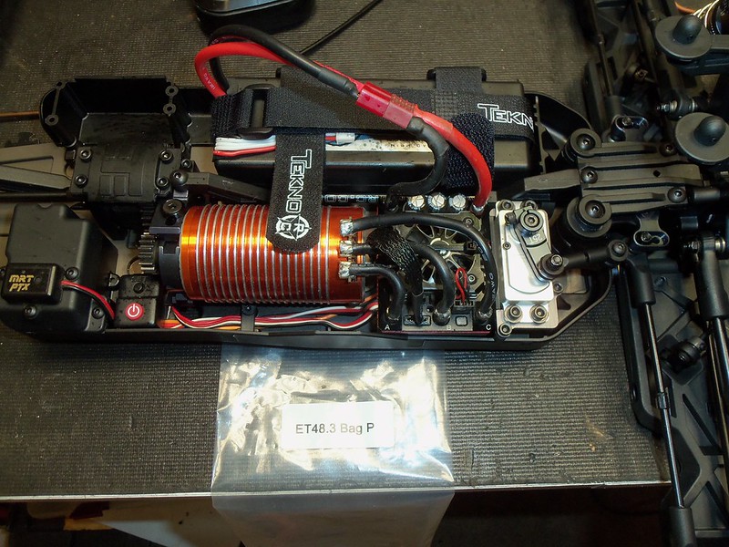

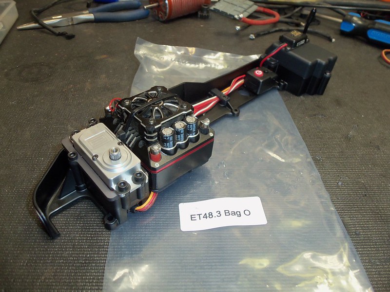

It's been 1.5 years since I took these pics and haven't had to touch the ESC since... though I have had to reposition the on/off switch so it sits on top of the Rx box next to the PTX, I had to splice solder the wiring to extend the wire length a couple of inches :)
that's a great tip about trimming the esc plate notch. I need to do that - mine is all warped because the ESC is sitting on it sideways so it's much narrower than the plate on one side.
