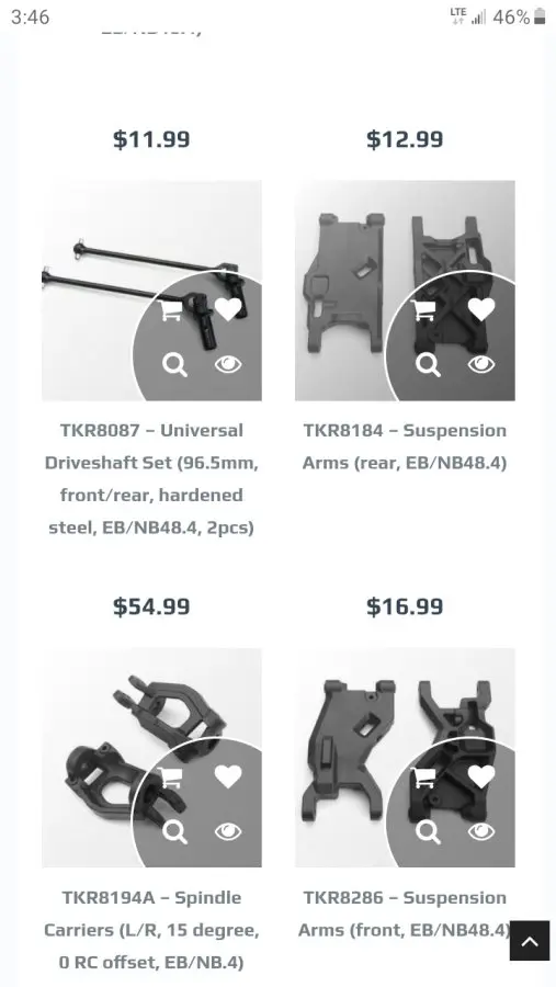

Yeah, I wasn't clear on my "plan",LOL. Since I already have an mt410, I would start with that. Add eb48 arms and cvds..basically dreaming out loud..
I won't claim to know Tekno's hierarchy or comparability acrossed models, but the eb48.4 arms and cvds are still available? Wouldn't they work with the sct or mt chassis and such?
To make it long wheelbase, switch out the mt for et48.3 chassis?

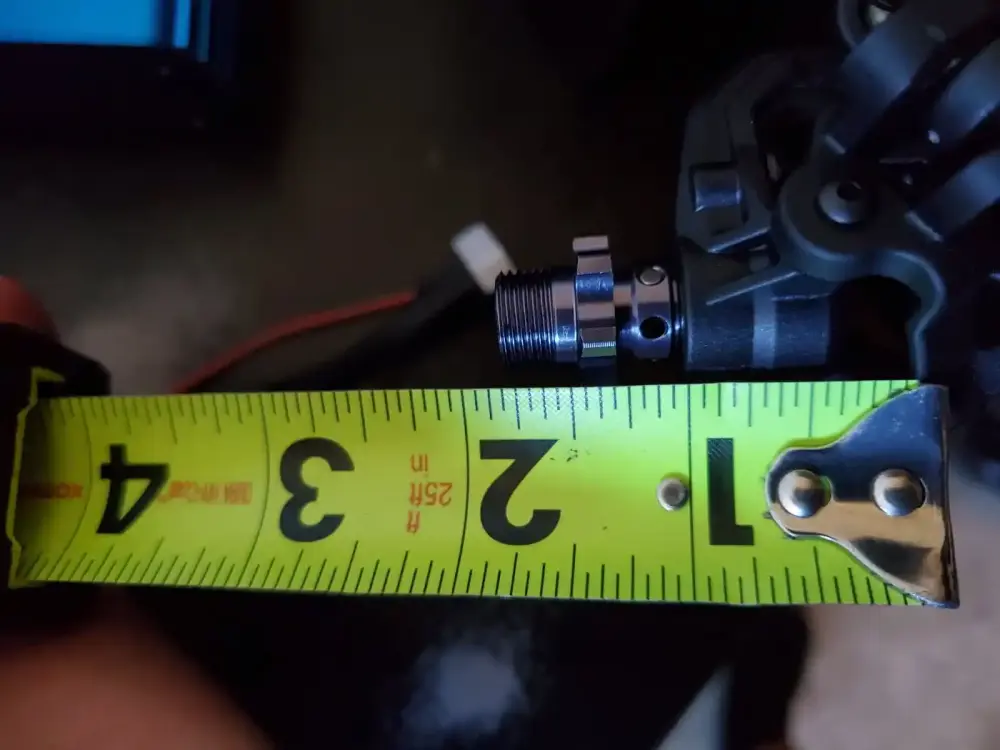

The 17m hubs make it I think 3 mm wider, stock wheelbase otherwise. It fits a few bodies I like pretty good.
It's wider than 3mm on each hub. A little over 1/4" or 7mm.
I don't have any standard size buggy tires to test, but after my overall width measurements I'm having a tough time finding bodies that I think are going to be wide enough. Like you said, there are a few, but it narrows down the options quite a bit.

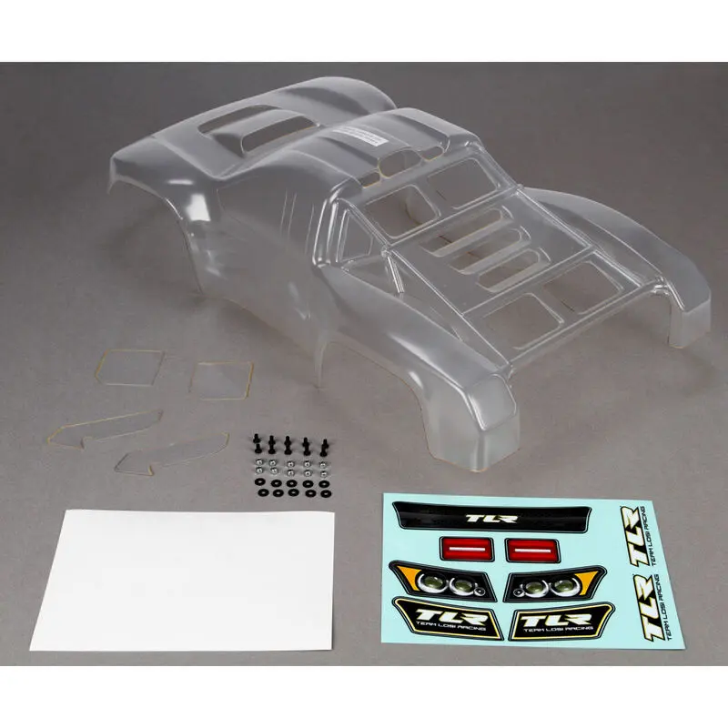

With 1/8 buggy tires its like 302mm outside to outside tire sidewall, guess the buggy offset is different. I just measured with unused buggy badlands. I've ran many older buggy wheel sets and seems same same. I think 296mm is race width for sct so 3mm or something wider. I like this body for the Losi trucks its an upgrade from TLR.
Not perfect could be a few mm wider. I also run J Concept scalpel on the street, its a wide body, and cut ones for off road. Cut the bumper fender area, back window etc.
