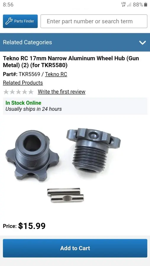

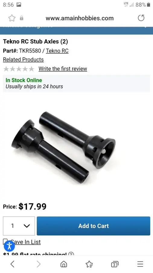

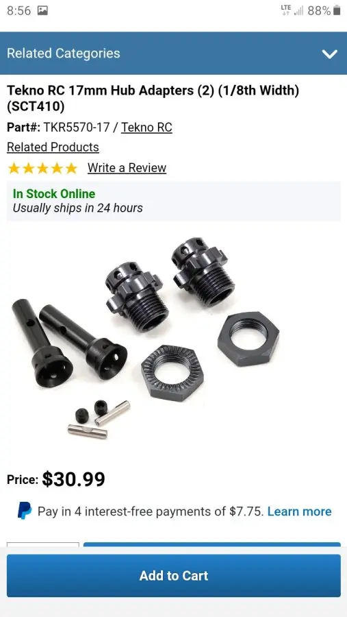

@Hector_Fisher , do you know what the part numbers you used are? I coulda swore I saw on Tekno's site they have slim hub adapters that keeps overall width the same as stock?
.....okay, I did indeed see that there are slim hubs...first pic is the kit that I believe @Hector_Fisher used? Then the stub axles and slim hub adapters which are sold separately. This is what I'm after..keep those tires tucked in👌
Yes, TKR 5570-17 is what i used. I finally understood what @nitro was trying to get at. The overall width is about the same with the extended buggy adapters, only slightly wider. Not a "hub to hub" measurement. Since the buggy wheels have the positive offset, they end up making the truck have a fairly equivalent width to the stock SCT wheels/tires/hex only off by a few mm. So with the narrower hex you posted, you're going to be even skinnier overall if that's what you're after!

Aren't pretty much all 1/8 buggy wheels zero offset? The slim adapters should keep the sct410 at or very near stock width? I think my sct wheels have maybe a quarter inch offset or less. Possibly zero, I'd have to look.

They might be the same offset. Not alot of info out there. I do know that the TKR5570-17 widens by about 7mm on each side, 14mm overall. If what @nitro was saying applies, which is that with TKR5570-17 and buggy tires that the SCT is only a few mm wider overall, then that would suggest the buggy tires are likely a slightly different offset. When you get some time, could you measure the overall width of your SCT with the SC wheels/tires? I know offsets may vary between manufacturers, so it may not be an apples to apples comparison. But then we could compare widths and figure out exactly how wide the SCT is usually supposed to be. IIRC, when i measured with the buggy wheels it was just shy of 12inches.
