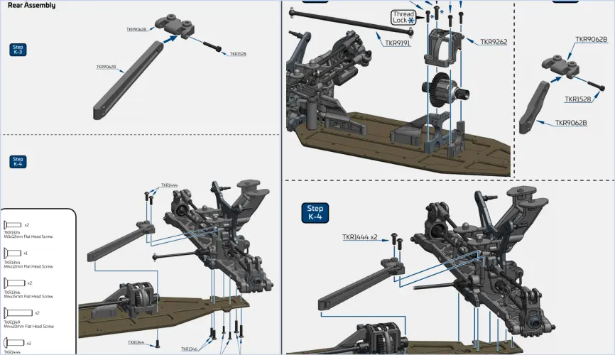

The ET48 2.0 (left) and ET48 2.2 (right) both use the same TKR9062B rear brace.

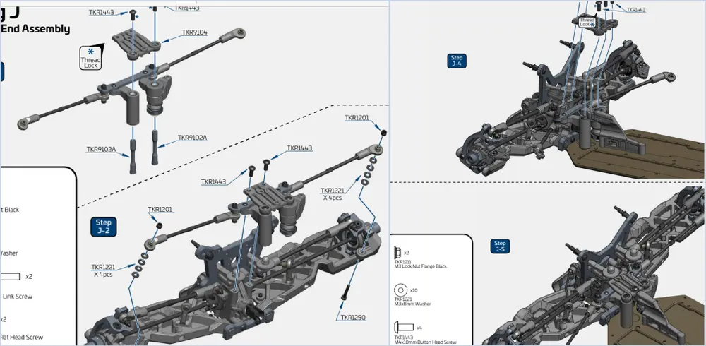

The same TKR9104 top plate is used on both ET48 2.0 (left) and ET48 2.2 (right) truggies, but proofreaders forget the top plate part number in the 2.2 manual at step J 🤪
