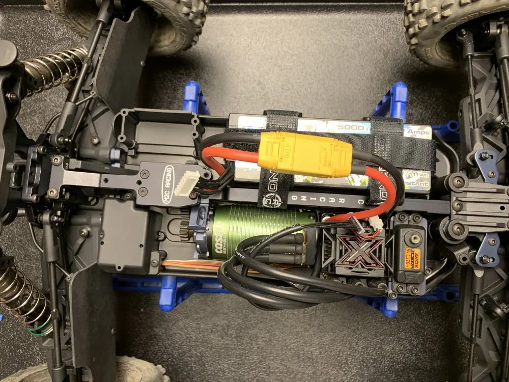

Ya it fits but not too much room to spare.
The m2c brace actually clears a smaller pinion on the motor than the stock plastic brace. Servo can be a bit tight, I never had a problem running that same Castle combo.

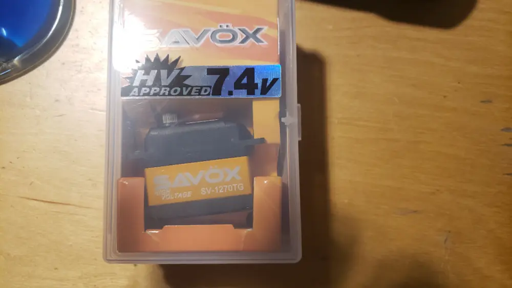

thanks for the info ! ! ! much appreciated. I'll order it as soon as they get it in . . . btw great minds think alike mine servo is still in the box, hoping MT410 gets here next week. BTW - I got the trenchers and they seem freakin enormous (not that I have much experience) what are you running? and you think the trenchers too heavy for the MT410? THANK bro.

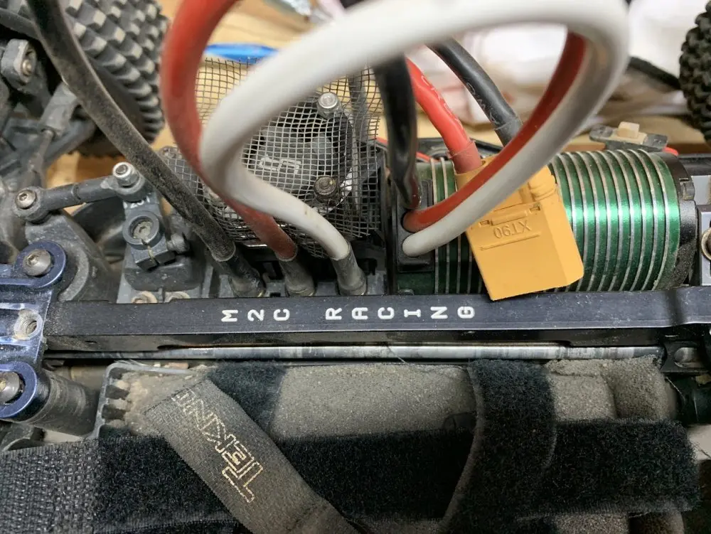

That center brace is a squeeze for sure but I think its actuallybetter then the 6905 brace. Alot beefier. I had to file down the washers on my servo a bit but it did fit in the end.
That center brace is a squeeze for sure but I think its actuallybetter then the 6905 brace. Alot beefier. I had to file down the washers on my servo a bit but it did fit in the end. View attachment 5045
M2c 6835 is the brace im using. Thats the brace I though you were referring to. 6905 has been sold out for a long time.

The 6835 is newer. Its alot beefier as well. If you think you can fit it, I'd go for that one. ?
dude you remind me of me 10 months ago, couldn't wait for it to come. Take your time and enjoy the build, it will be over much too soon and you will enjoy it! btw I got the same set up as you, all of mitch's braces and the monster X with the 1515 combo. It dpes fit but no room to spare. I think the tires may be your issue. I started with the trenchers and I overheated every time. had the motor temp set to 150 degrees and in 20 min of hard bashing it over heated. tried this and that but still overheated. Went to dboots and that has worked out fine. I think the trenchers are too heavy for the 1515 regardless of the pinion gear. I tried three and overheated with them all. am ok now with the dboots and a 14 pinion, may try a 15 with the dboots but I don't need the speed to bash. post later how your trenchers do with the your current set up, curious if you overheat too.
