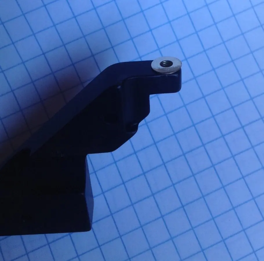

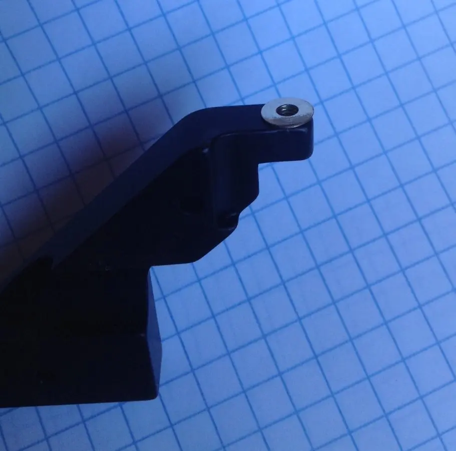

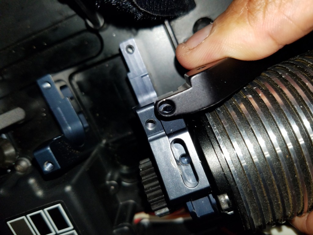

a picture to judge if you have one of the skinny braces. these are from the latest batch of braces ran. (pics by Rich Duperbash on Facebook)
and
and

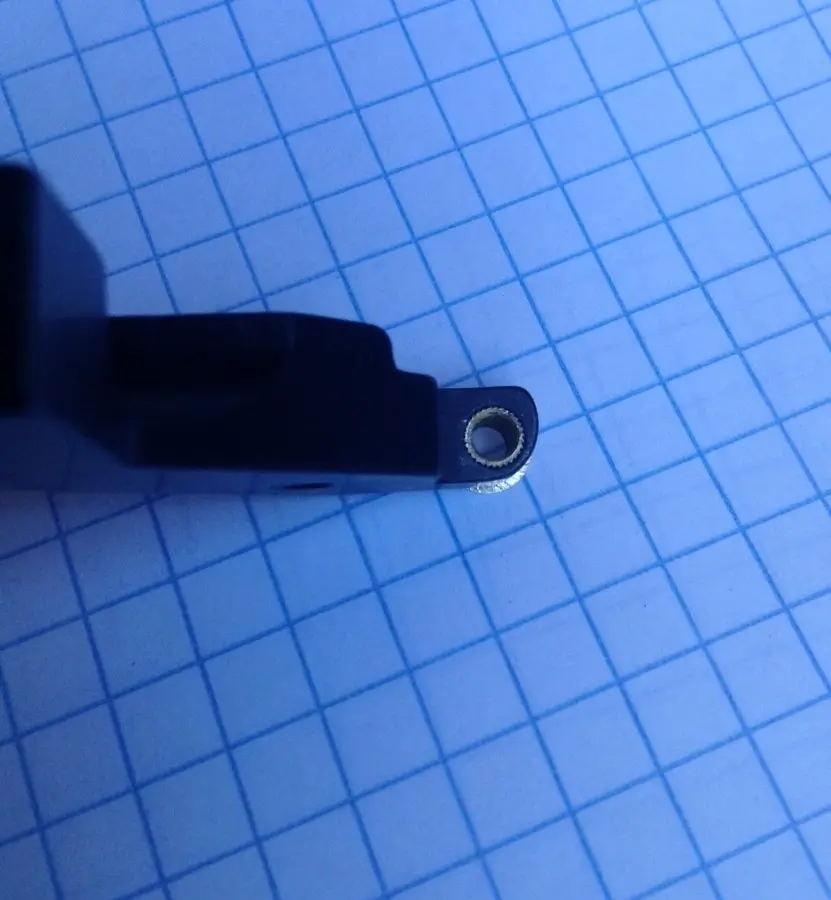

I bought mine months ago but it is for sure the skinny material thickness. I never installed it but don't feel like sending it back etc etc.
I took some measurements and not sure why the mounting hole would be 4.2mm when a 3mm bolt is used but it is what it is. Explains why it failed though.

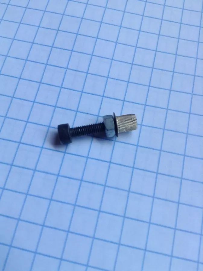

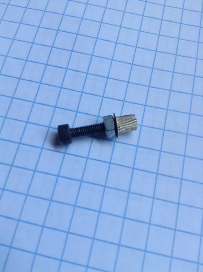

So, I took one of my knuckle bushings from my Axial Bomber and measured it. Close enough but had to shave a few off. I put the bushing on a 3mm bolt so it would rotate. If you use a file to shave off a rotating piece you get a half knurling. That provides a little grip as your inserting it in and using green loctite 403 sets it up near permanent. I shaved the bushing to 4.3mm so it ain't going anywhere.
Not perfect but better than it was.
Not perfect but better than it was.View attachment 651View attachment 652View attachment 653
awesome! beats waiting around for a new batch and will be just as strong if not stronger.

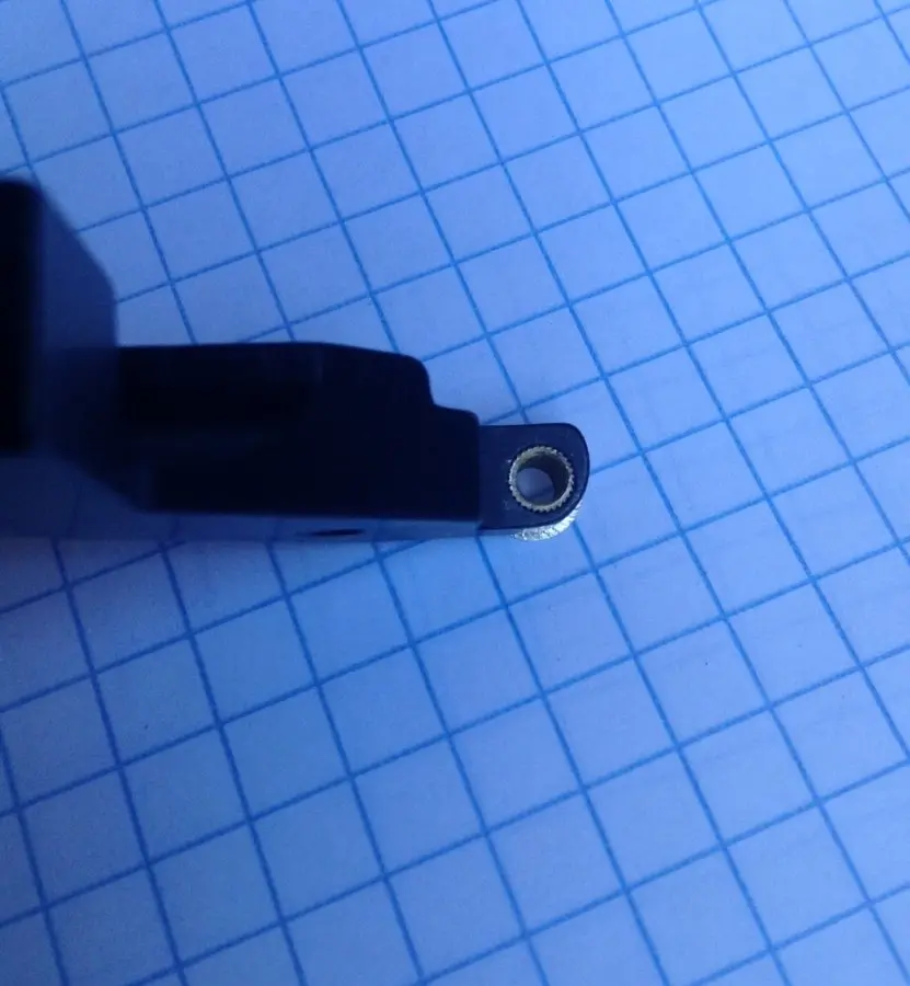

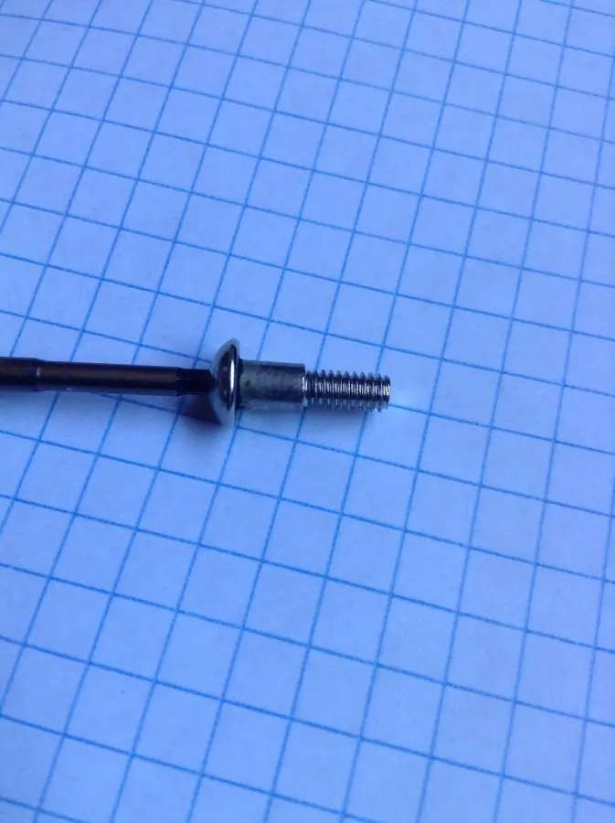

I thought the brace went on the top plate but I see that it is actually attached to the motor mount. Even still a 4mm screw is 3.8-3.9mm wide so the 4.2mm hole in the brace is still way to big. I'll just drill mine out to accommodate a 4mm bolt but the concept is the same.
I change my mind which is often do while modding or fabricating something. Didn't like the wall thickness of the bushing so......
My XXL knuckle bolt was close enough but the shoulder was 4.9mm and the threads 5mm too long. I don't have a lathe so chucked it in the drill press, ran a file on it till I got to 4.2mm and hacked off 5mm of threads. The shoulder was too tall so stacked three 4mm washers and done. Even with the washer the shoulder is 100% engaged with the M2C brace.
Good enough for now.
Nice fix (hopefully!)

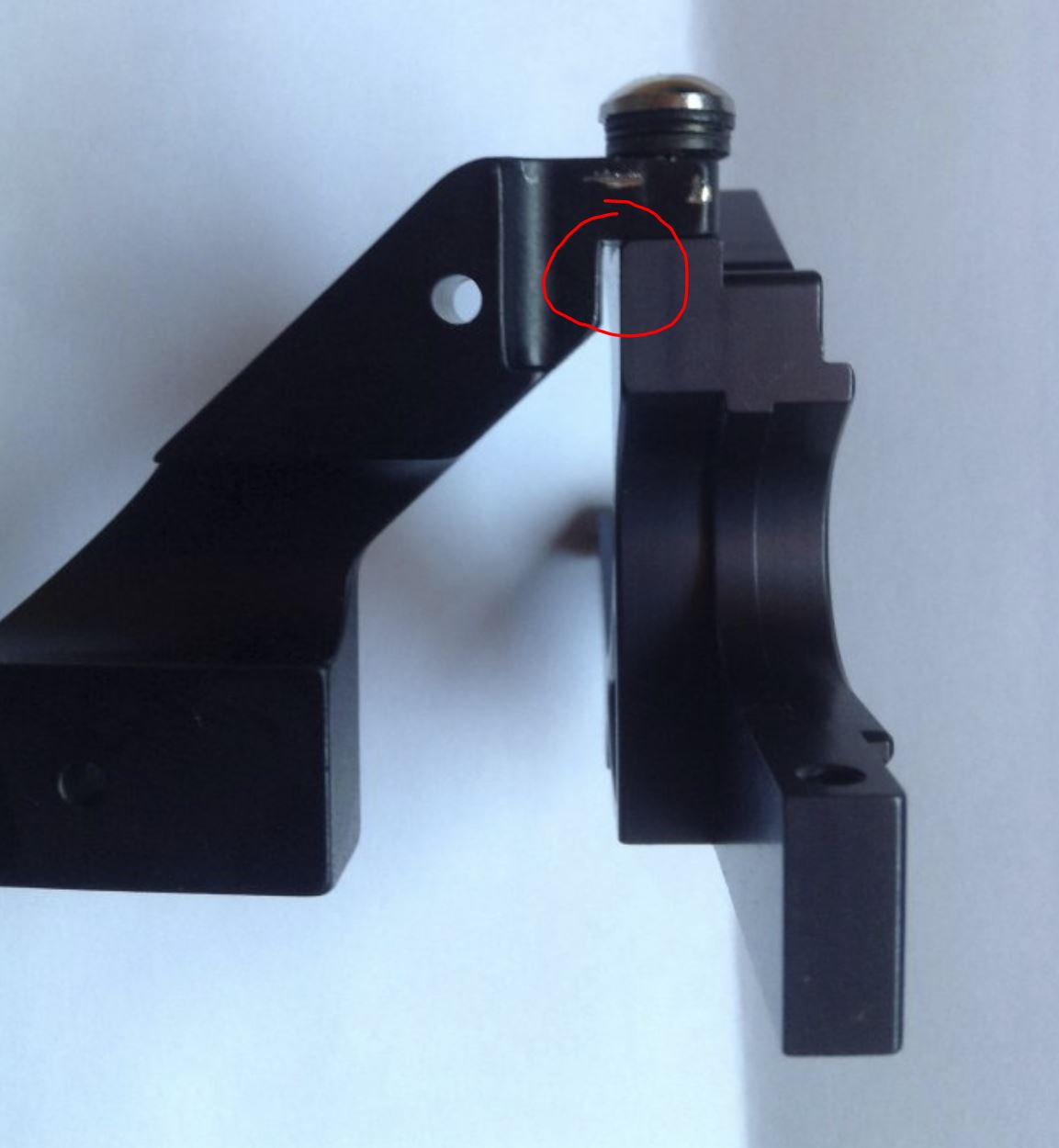

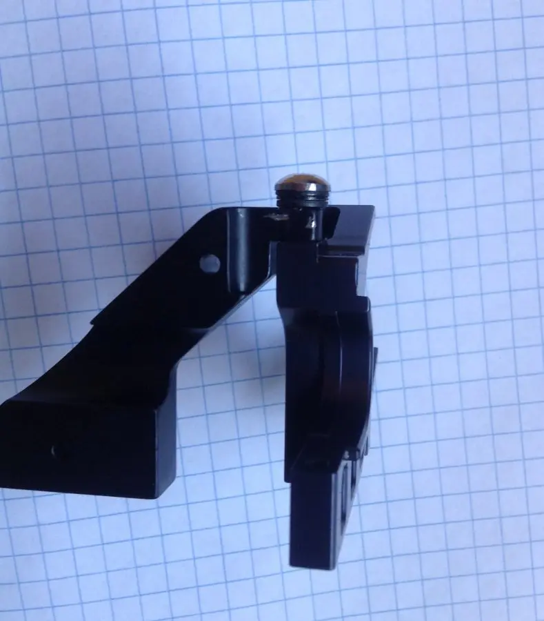

After the bolt mod I had a chance to really look at the brace. Hope it's just mine but overall it is a terrible design in this particular area. Look at the 1.1mm gap from the brace to the Motor Mount / Diff holder. All the flex is going to be contained on the top at the bolt. Maybe it's just mine but don't see it lasting to long.
i may be confused but isnt that gap due to your modification?
Unfortunately No. I have done nothing with the brace. My 1st and 2nd mod only dealt with the Grand Canyon size mounting hole. That hole was untouched and just used for measurements. Like I mentioned it could be just my brace.
oh my bad i see where you're saying now.
Yes you're completely right, that makes perfect sense. that is not good! That explains why all of the force goes right into that screw and breaks there. I don' t have mine any more or i'd compare it...
Send that sucker back, or at least try...
i found a pic of when I installed mine, looking closely you can see the same gap... (and how the hole didnt line up, had to push it hard, fitment sucked)

Exactly. I can't do that circle thing on my iPad so sorry for that.
I would but in my experience MFG's never pay for return shipping and then charge you for shipping on the correct or updated part so I'll just chock it up. Just too much hassle for me.
Bright as day right by your pinger and the mis aligned Marianis trench mounting hole.
