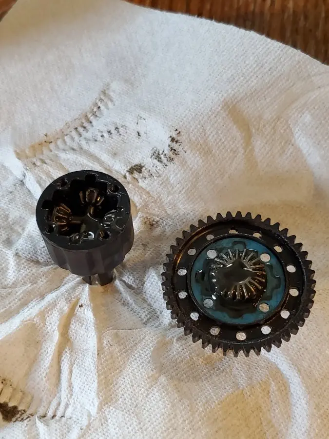

This is the same situation with both my SCT and my MT, they both keep leaking out all diff fluid (center and F/R). I've assembled everything to a T, as shown in the manual. Leave a little room at the top, tighten down the spur bolts in a cross fashion until they stop moving. But they still leak.

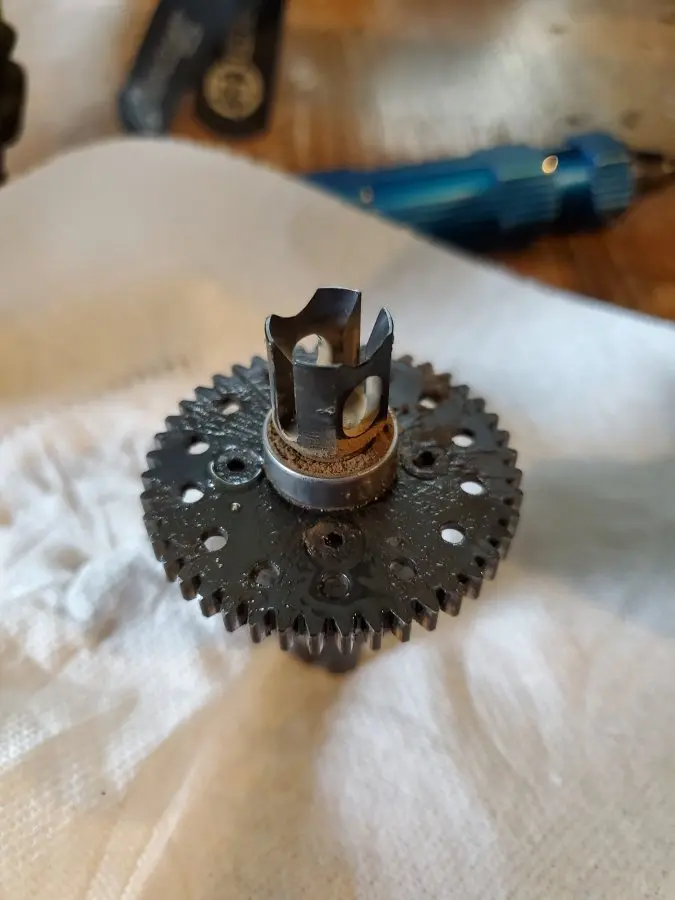

Took apart my MT410 today since I saw the center diff looking like this:
All screws were tight, not one was loose.

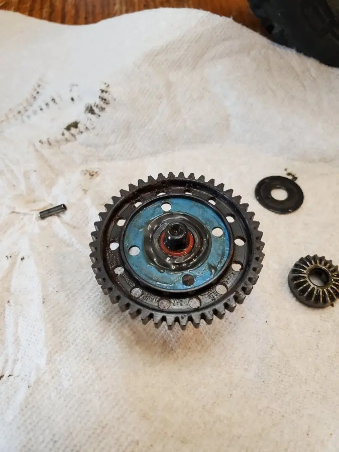

Gasket is intact. I seriously don't know what I'm doing wrong. Of all my RCs, my teknos have been my worst leakers.
My next step is to fill with 500k (highest i have) and try that. I'm hoping that would stop the leaking, but that's not much higher than 100k stock.

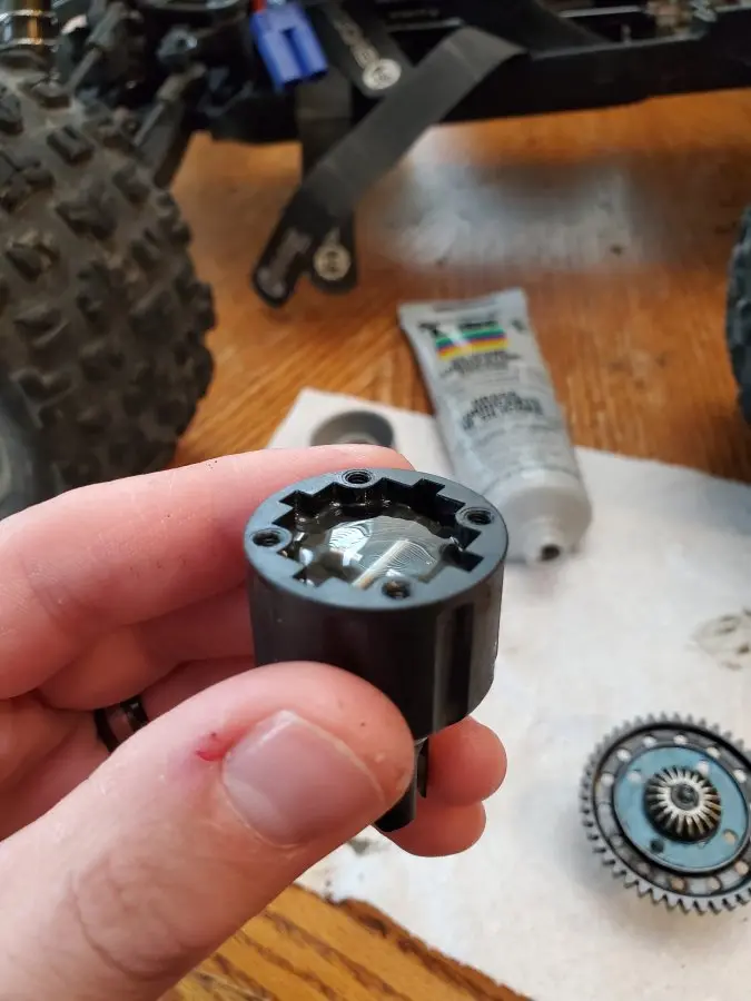

Everything looks like it was assembled correctly on the inside.

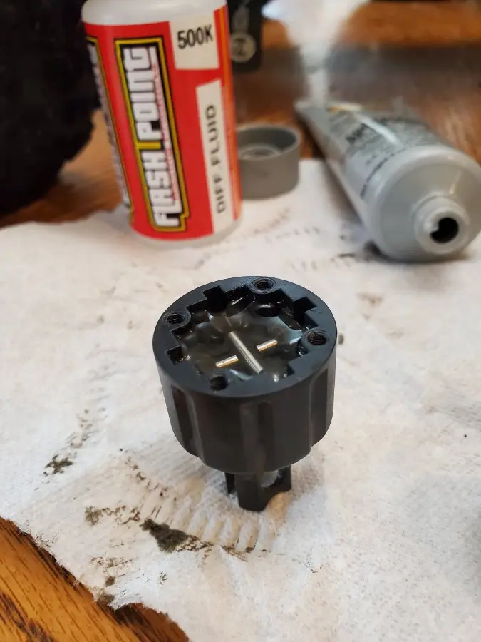

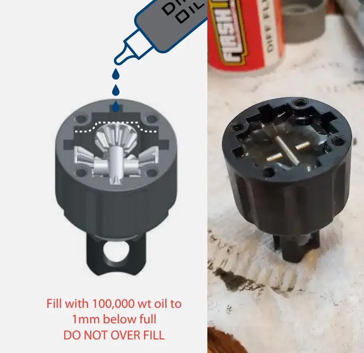

Since I'm currently in the process....
More or less than this?

Ended up taking a little more out. I don't remember how much I filled it last time (would have tried to mimick the picture in the manual), but at least this time i'll have this picture as the reference point.

That looks too full. Drop the other sun gear in and see how full it is before reassembly. I had one leak and found out it was overfilled.
I think my only complaint is that I would be following the tekno instruction manual directly. So if what you're seeing here is too full, then tekno is telling you to fill your diffs too much.
The tekno manual contradicts itself. Manual says to fill to 1mm below top (just over the top of the gears), but the top of the gears are NOT 1mm below the top of the case. In my picture, the oil level is about 2mm below. And i even took some out after i took this picture.
Which, fair enough, maybe i was filling too full the first time. But but how then is ALL the fluid leaking out?

I put the other sun gear in once it’s nearly full and fill to 1mm below the top.
