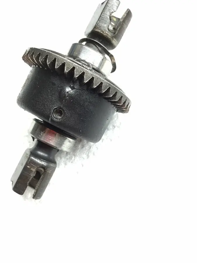

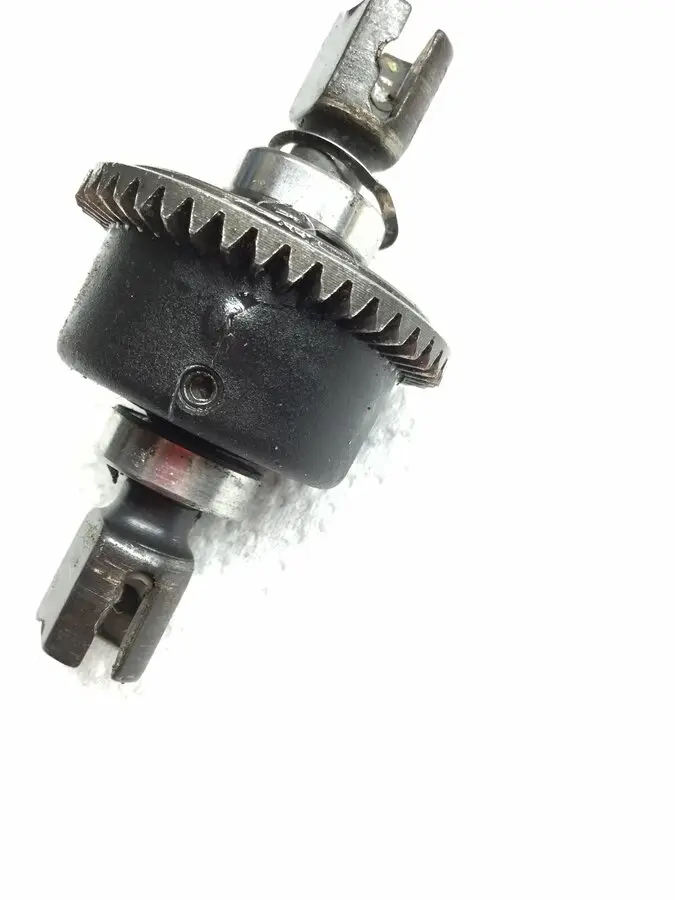

Having come from 6S Arrmas, here’s the amazing thing. Tekno diffs (as long as you buy the steel diff case) don’t ever seem to break. They’re beautifully machined, Accessible very quickly (6 hexes) and uncomplicated to service. They rarely need shimming. I am only running 4s but others will no doubt chip in with their 6S durability. When I go out bashing with my Arrma friends as many as 50% of them will go home from the bash with a broken diff.
The replacement Arrma diff costs soon outweigh the on-cost of having a tekno.

1. How often do you rebuild the diffs out of wear and tear necessities - not just due to a bad hit. Do you know that after xyz number of packs / mileage that yeah the diff needs new fluid and more finer tighter shimming now etc

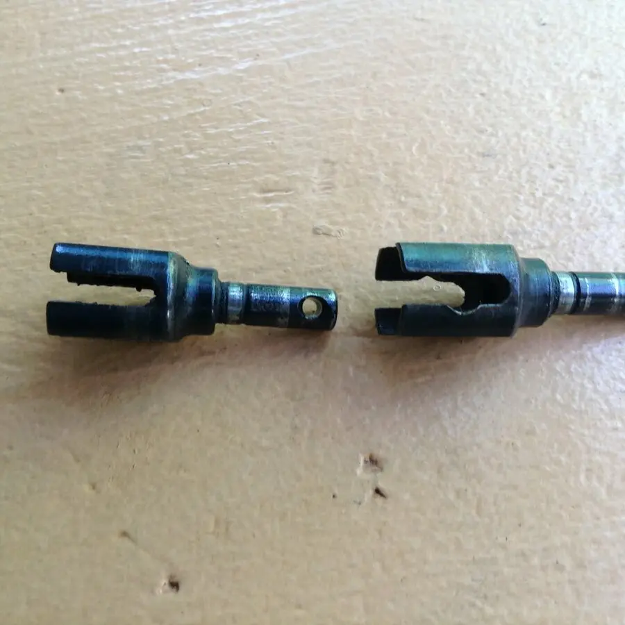

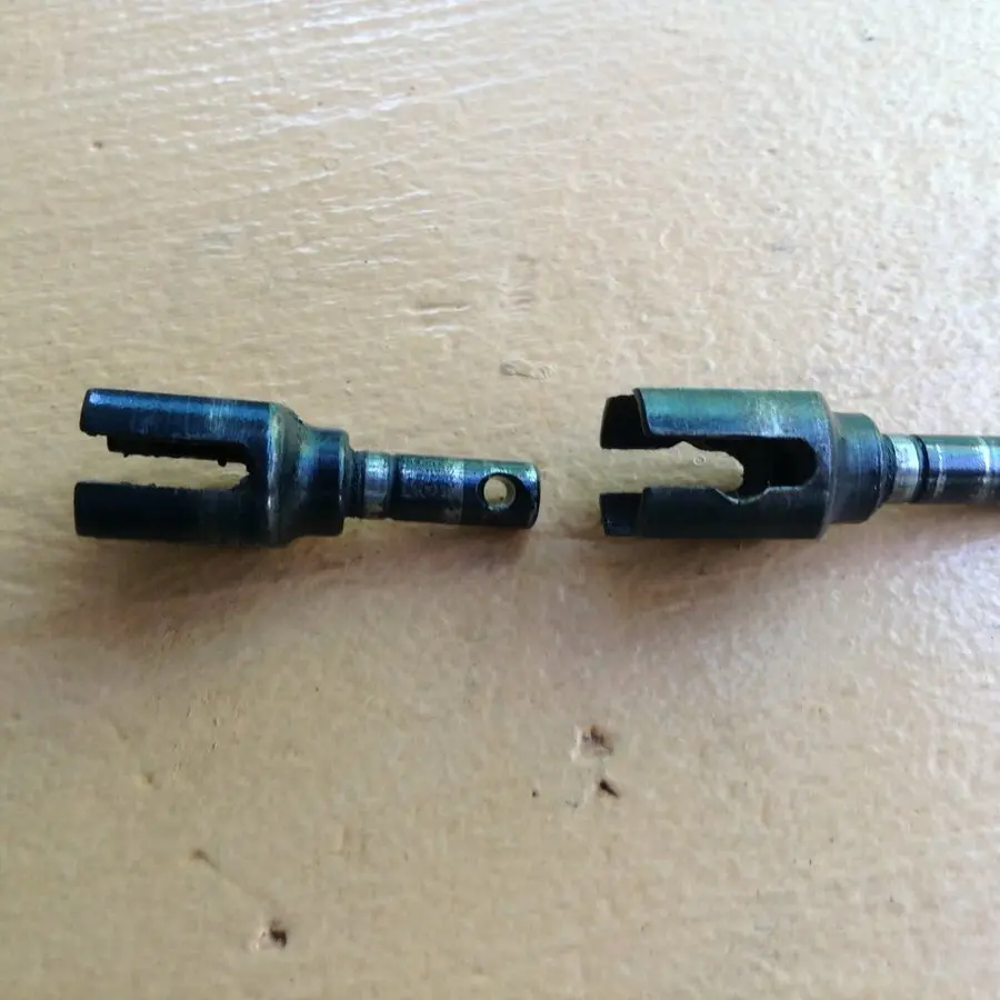

2. Roughly how often do you have to replace the drive cups / outdrives due to wearing if any. I attach pictures of Arrma outdrives. I have no idea how long it takes to reach that stage but I reckon it’s not too long.
On top of crash repair (I don’t think Arrma plastics are that bad) those 2 things I find are really a monthly affair that i don’t really have the stomach for.

You could always reverse the direction of your front/rear diffs when you put them back in the gearbox, then reverse motor direction. Or swap left/right outdrives when rebuilding the diffs to get use of the other side of the outdrives.

I think the Arrma drivetrains are sufficient for what they do, bashing; but they are certainly not made for long wear. Perhaps my experience is anecdotal, but my SCT410.3 and MT410 have next to no wear on the drive cups and driveshaft pins after a year of bashing (4s on the SCT, 6s on the MT). The hardened, quality steel tekno uses shows. Whereas my Kraton has been bashed equally as hard, but even after a few month you could start to see indent in the drive cups and slightly mashed pin edges. It would still drive, but it's lifespan was duly noted as being shorter. As noted above, the good thing about the kraton is that you can swap diff/driveshaft orientation and get more life from your parts.
Arrma does use more material, so imo their drivetrains can take a beating just like my MT410, but they won't last nearly as long. For comparison, my two Kaijus (OG and EXT) have beefy drive pins and driveshafts. They can take a hit and hold 6s power, but they are also wearing in just like the Kraton. They are also made of the finest chinese monkey metal :) The good part about them at least is that fully assembled diffs can be found for ~$20. Pick your poison i guess.
Have both Arrma and Tekno here, amongst others.. Tekno quality is definitely a step up from Arrma, as is any race level rig in my experience. Arrma parts are cheaper and more widely available for sure, and need to be. They don't last as long, plain and simple. I have an MT410 that's over 2 years old, I've only ever ran it on 4s. Mainly because it is nearly as fast on 4 as an Arrma on 6s. Diffs in the Tekno are gold by comparison to Arrma. Not that Arrma is bad, rather just not as good. The Tekno's stay tighter for far longer than the Arrma's. I don't believe there is any area aside from price and availability where Arrma is better.
