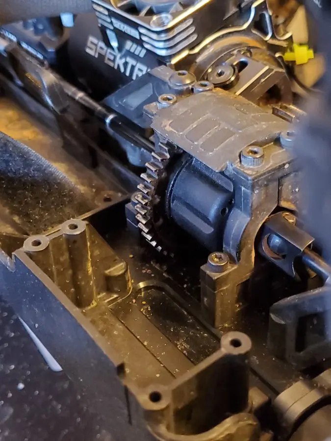

Can't seal a diff to save my life
I’ve had this problem with my tekno diffs. How I think I’ve remedied the problem was less fluid, even tightened and not over tightening. I have an arrma 6s that that was a problem on and didn’t have anymore diff gaskets and wanted to run. So, I used some silicon gasket maker and haven’t had the problem yet. Now I don’t use gaskets on my arrma. When I run out of gaskets for the teknos I will do the same. BTW, I mostly bash so I’m not getting into my diffs multiple times a week. Or however Many times racers take apart their diffs.

Must have missed this notification! Center diff seems to have sealed okay. Nothing leaking as of yet, and I've ran her through at least 2 or 3 packs.
Either the 500k oil or filling it less, not sure which one. But that seemed to have solved the issue with the center on the mt410. Put a few dabs of 500k in my SCT center diff as well (i like my center diffs stiff!). It hadn't all leaked out, but it was certainly low.

I have the same problem, but without using my MT410 xD I build it 6 month ago, and put it on a shelf, and yesterday i want to add some skidplate, and i see that my center diff loose almost all the oil. When i open the diff, all screws are tight, and all is good.
I can't see if it's the same for the front and rear, i hope no.
What's the problem with this ? need to use two gaskets for one diff ?
Most of the time it is the orings. The orange orings are a little loose (by design) to allow for a freer diff. Once they've been run for a while they swell a bit and seal better, but still not overly tight. We have another set of diff orings that are larger and seal better, TKR5144B. They are tighter and will make the diff feel a little thicker.
Perhaps this is what I was experiencing then. If rebuilding a diff in the future with new soft goods, could I "soak" the oring in silicone oil for a week or so to help encourage pre-emptive swelling? Or is that induced by another way? (ie heat from diff action or friction etc)
You could do that, I know some guys that race 10th scale Losi's and they would do that for their shock seals. But for me, I just prefer the new orings we made. They seal well right out of the package, and being tighter, they provide a higher "breakaway point" - the point at which the diff starts to unload.
