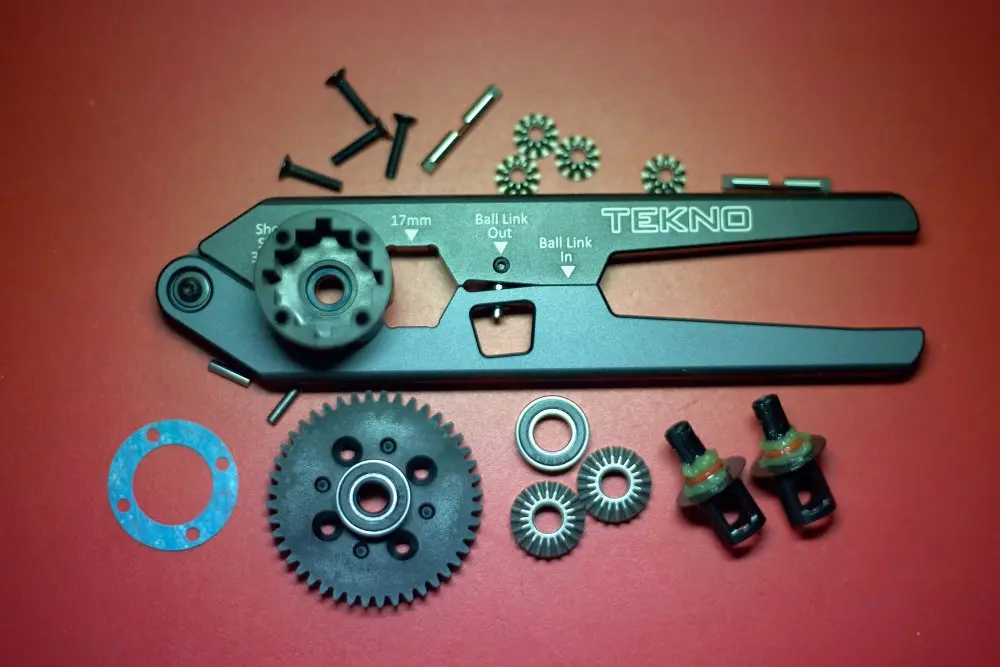

Ran into one temporary snag. The first B bag diff I built was a bit tight to turn. Two plates came stuck together and I installed them as one. Figured it out eventually. So be aware. Had to stick blade between to separate them.

When shimming Tekno diffs, is no shims a thing? With only one gear side shim, has a tooth in one direction with a touch of bind.

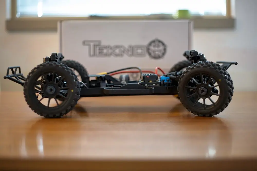

Nearing completion.
max8 combo
powerhd servo
aluminum horn
aluminum emulsion caps
steel cross pins
17mm buggy width hex's
buggy badlands
Need a few pieces.
like rock guards, didn't come with
body, that's a big one
figure out pinion and mounting of big motor

Looking good, re the diff cross pins, I've only ever found the aluminium option pins, do you know part no. for the steel ones? Do you need to change anything else in the diffs to run the steel pins?

Is your combo with the 2200KV motor? Are you running 4s? If so you will likely max out the adjustment range to get a big enough pinion. 20T would be the minimum for 4s, probably about 35-40 mph top speed in that combo but motor could handle 50+ type load with ease.

So are those just a steel version of TKR5149A, the aluminium ones? Or are they slightly different size? Not sure if I should order the steel or aluminium ones when I order the kit. Thanks

Same size. Get steel ones in my opinion
Its 2200kv. I was planning 4s. I have buggy wheels on, so a bit of gear from that. My first electric, thought it would hit higher speed than that.

1/8th buggy wheels? So I did a speed run test with 2.8 monster truck trenchers(They balloon a lot on 4s so makes truck a bit scary to control), the HW 2600kv 4268, 20 tooth pinion (Might be able to fit 21T but don't have one yet) using the HW150amp Quick run esc (So no boost effect because not using sensor).
Results:
2s (8600mah 120c ProTec Graphine) 33mph
3s (5000mah 50c Gens Ace) 40mph
4s (2s 5000mah 35c Power Hobby in series) 47mph
My other 410.3 has the HW SCT XeRun 140 esc and paired with the XeRun 3660 3200kv censured combo its impressive(have used 15T(14 is minimum size with 3660 cans) and 17T pinions. I will use speedo app and test it at some point.
You can definitely get much higher speeds Nitro, I'd bet you could run in the 60mph+ with out much issue. However the SCT is the older EB48 platform and needs one of the newer buggy center diff mounts because they're intended for the larger Can (4200 size < 2700kv). I'm only experienced with the 410.3 so hopefully someone with buggy experience can chime in here to confirm I have clue what I'm talking about. :)
