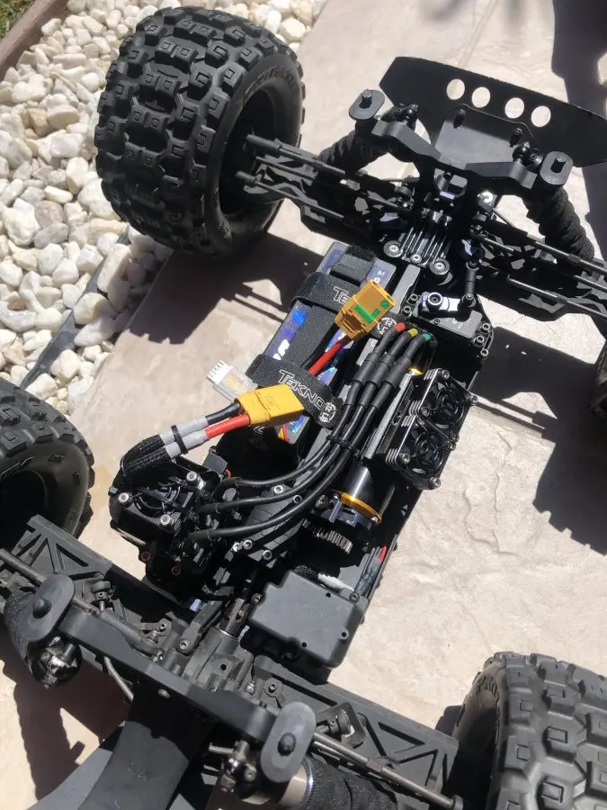

This is a 4076 and max8 second two photos if you want a bigger motor I would go 4092 and put the esc where the receiver box is and move the receiver box to the esc mounting location but you will more than likely need a max6 to run a 4092 . I originally bought this max8 to run a 4092 in my ground up custom kraton that weighs around 13 pounds with batts and the esc would overheat after five minutes running. The 4076 does just fine for me for this rig weighing 11 pounds on 6s. With the new motor mount anything bigger than 42mm in diameter won’t fit.

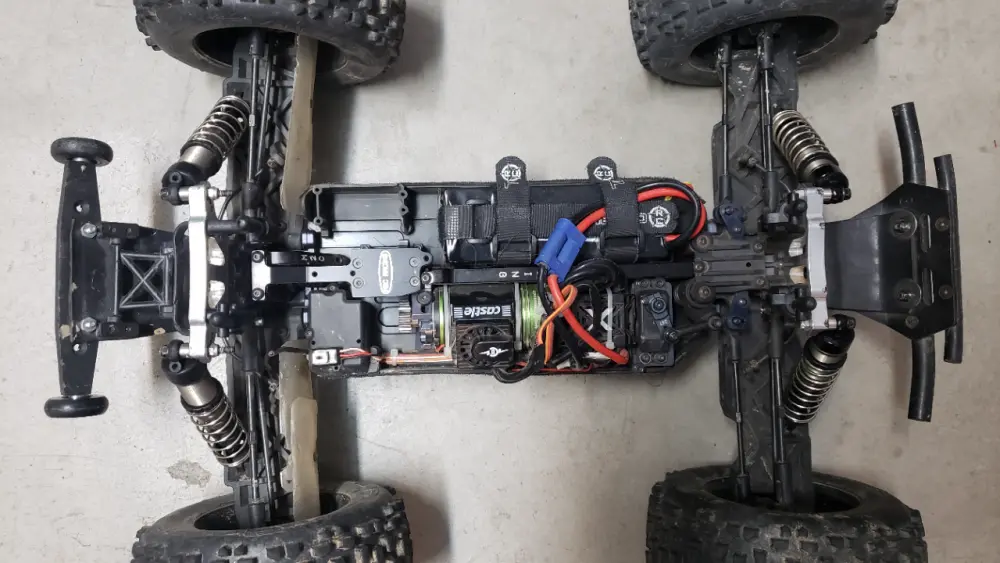

1520 will fit. You'll need to relocate the ESC to the other side of the chassis.
In my MT410 I’m running an mmx6s with a 4092 (longer than the 1520). A small plate to mount the ESC on top of the empty space in the rear of the chassis works great. I’m also using a better fan. I haven’t overheated it yet running large tires and a 20t pinion. It runs on the hotter side though (160-190F max, 150 average). MMX8s will run cool but also stick out of the chassis a bit more. It should be fine as long as you don’t land square on it somehow. Wide chassis would eliminate this problem, although it’s not likely you smack into the ESC.

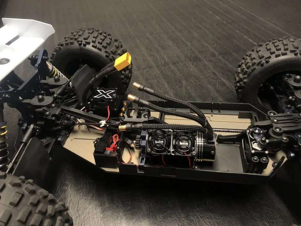

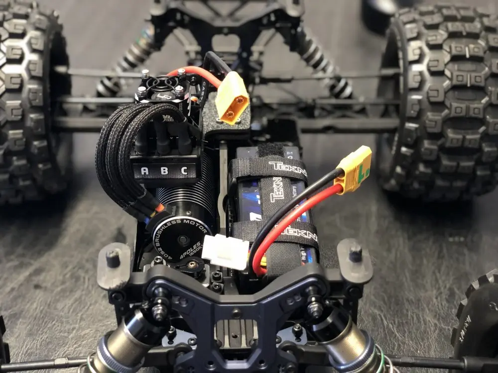

On my ET 2.0 I’m doing something similar except with an MMX8s and a generic 4092. I’ll likely be switching to a TP4070 (102mm long). This is going to require a few custom parts. Most importantly an ESC mounting plate, wire guides and a larger battery tray for Turnigy 6s packs. Here’s what it looks like right now.
I'd recommend selling the 1515/MMX6s combo and just moving up to a MMX8s and a generic motor on your ET2.0. The generic motors are really great for the price, although they run a bit hotter.

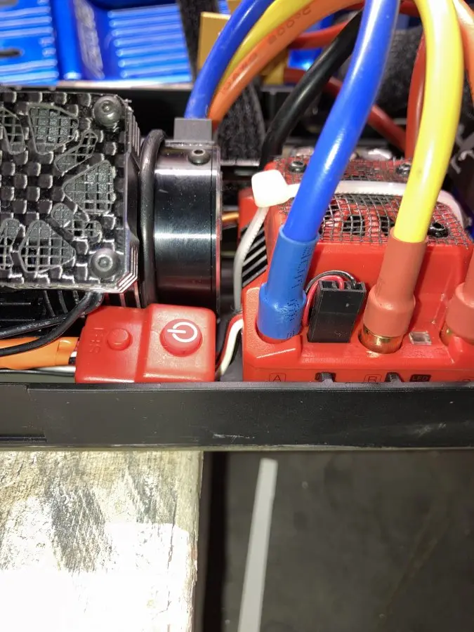

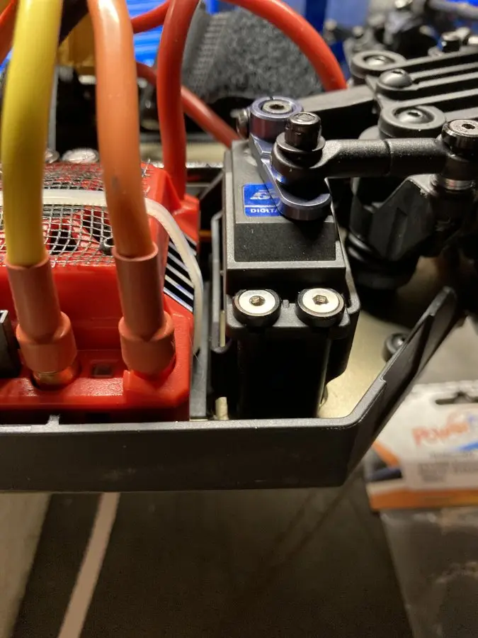

Can you please tell me what size motor you have installed in this photo?
not sure what photo you are referring to, but if you mean the one where the esc is between the motor and the servo that's a castle 1515 motor with a mamba monster x esc (combo). I pulled it out cause it over heated and put in a 1520 and very happy with the 1520 cause it doesn't over heat!
