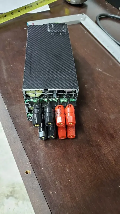

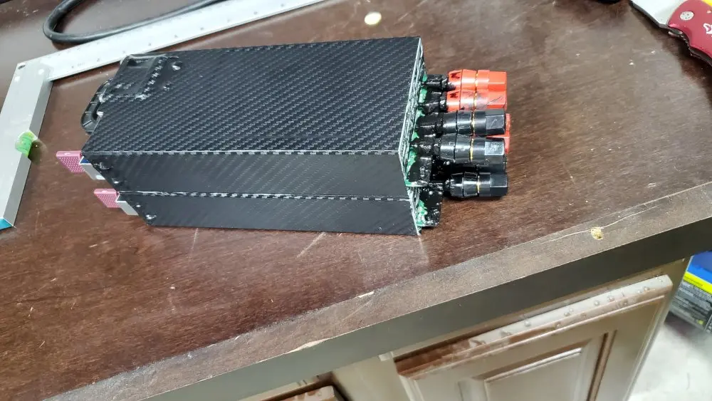

Finally finished my 24v power supply. ET48 2.0 won't be released for a couple more months but I was itching to complete a project. Quite proud of my work.
