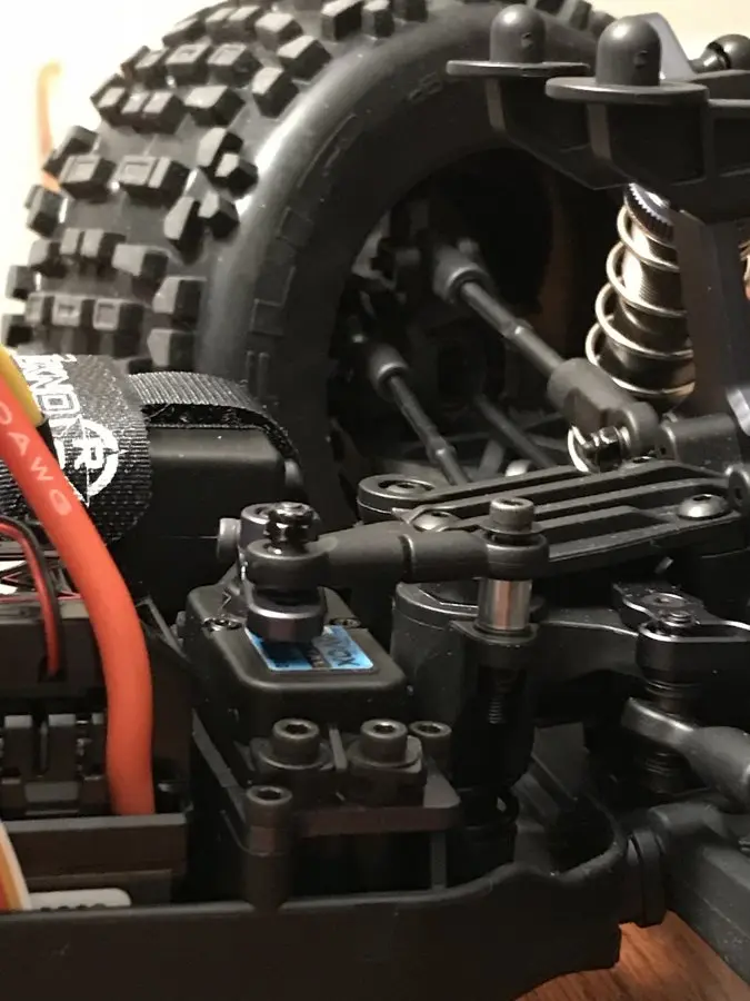

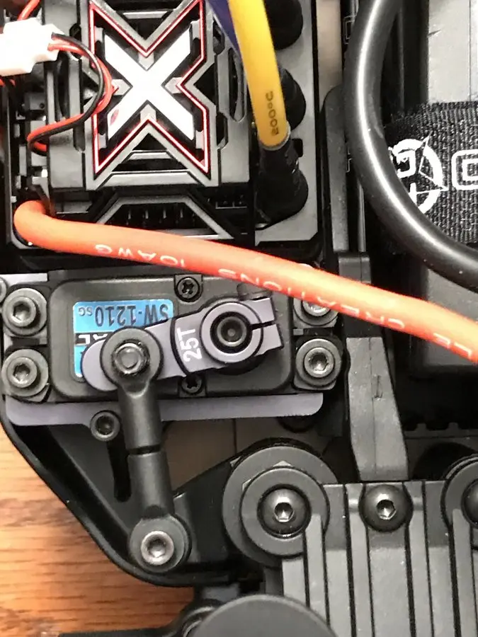

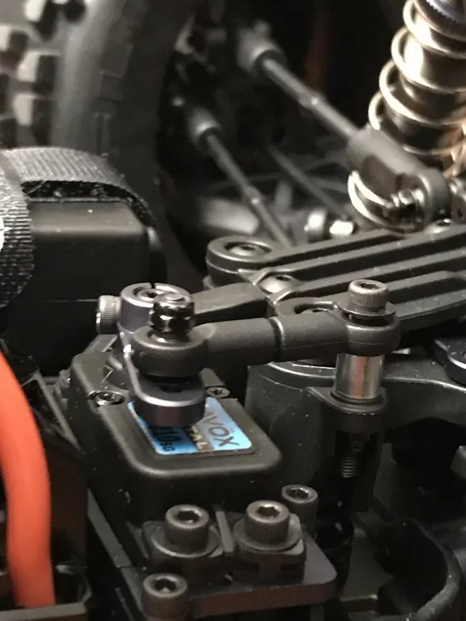

I have the Savox 1210SG in mine and it’s a very tight fit. I would cancel your order if you still have time. I’m sorry to tell you man but I don’t want you to waste your money especially right before the build. That money can be used in something else or a different servo.
Savox Dimensions L x W x H (mm): 40.6 x 20.7 x 42.0
Edit - The servo horn and link have been re-adjusted since this pic but it’s still a little off using the second hole though.

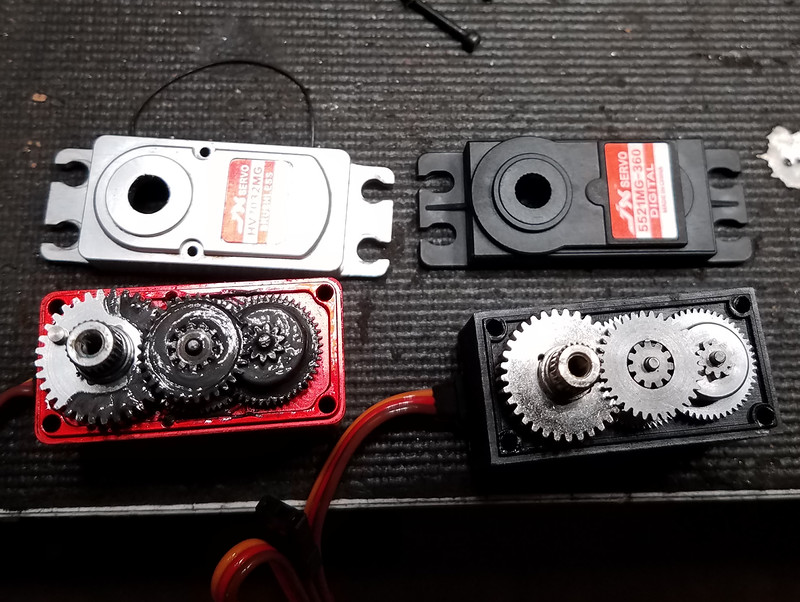

I've been running JX servos for just over a year now, they are really nice servos for the price, but unfortunately the gears start to get sloppy at about 8 months of use and in my ET48 the servo gears finally stripped at 10 months of use, then my EB48 servo gears stripped right at the 1 year mark. Replacement gear sets are hard to come by... I put in a request to RCJuice to see if they will start stocking them and he said he will consider it, in the mean time I'm keeping my JX Servos as spares until gear sets are more readily available on the market.

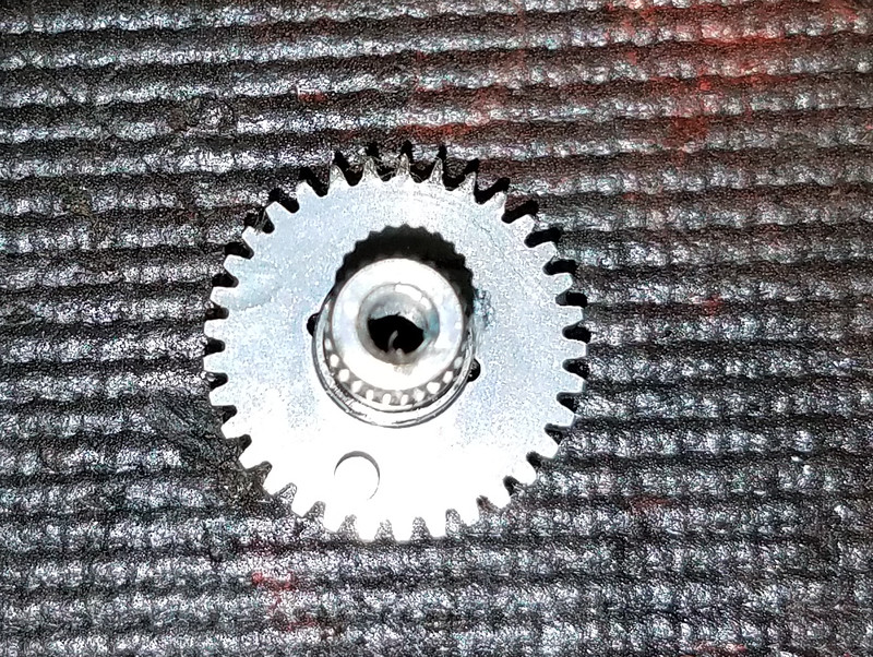

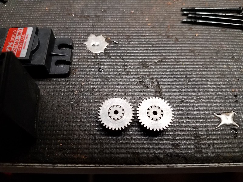

Here is a JX servo after 10 months of use (on the left), next to a brand new never used JX servo (on the right), I noticed slop starting to form along the 25T spline when moving the servo arm with my hand:
Here is a close up of the sloppy gear (from the servo on the left in the previous pic) where you can see some of the teeth are showing significant signs of wear:
The same wear can be seen on the #2 gear with worn teeth on the left and a brand new #2 gear on the right:
