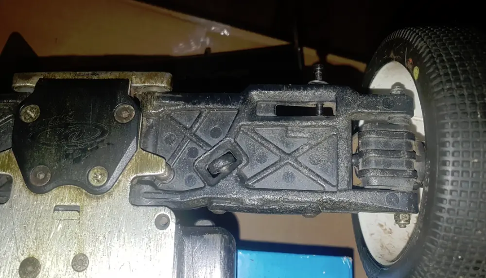

I'm lost with my EB48, I bought EB48 from second hand and I wanted to replace broken parts, omg I ordered so many wrong parts because my tekno is so diferent.
1) diferent arms
rear arms for EB48.4 have number TKR8184 and front arms TKR8286. My arms are diferent
Front:
Rears:
I tried to find those arms in tekno eshop, without success :(

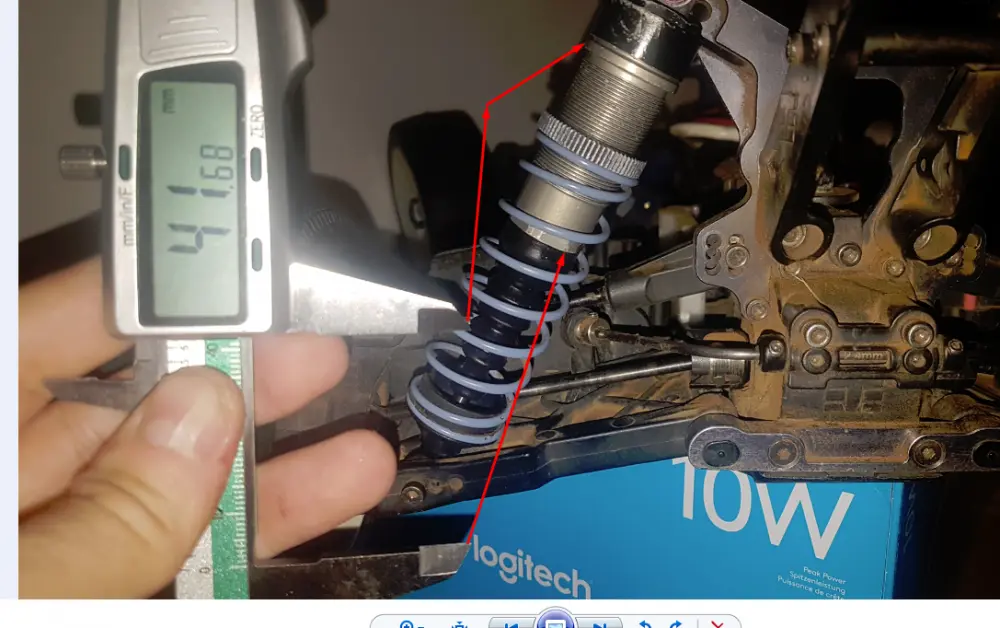

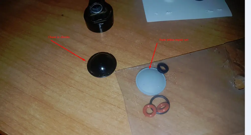

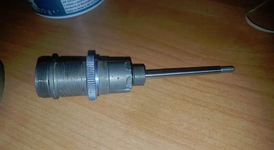

3) shocks
I have completely different shocks. I bought shafts for shocks, front TKR6017 (122mm) and rear TKR6061 (137mm), but my shocks seem to be smaller. I have 122mm in rear and I have no idea what is in front, I would say 107mm because these smaller shocks are assembled in EB48SL.
Next diference is shock boots, I have those with "waves", original ones are flat.
And diferent rubber
and diferent spacers
It seems I have shocks from another car :(.

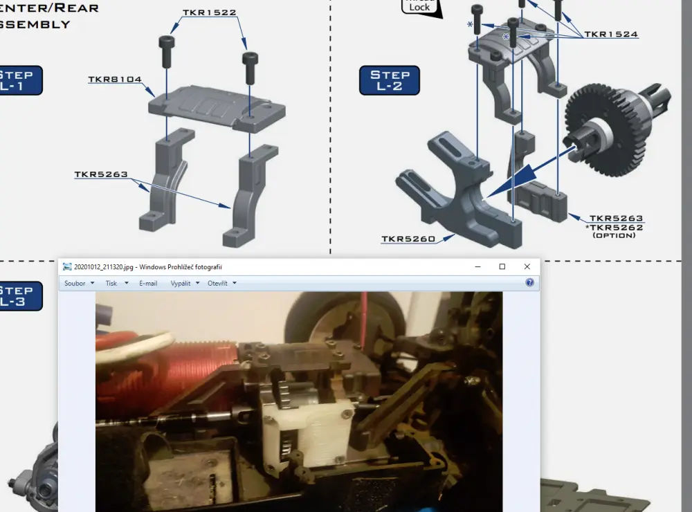

4) center diff house
Original house is from 4 metal pieces, I have only two pieces and more holes for screws on side, so I printed cover from nylon, but I can't find number of parts for my version.

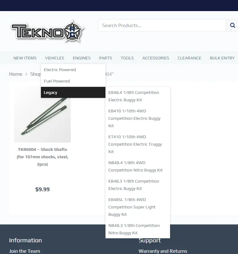

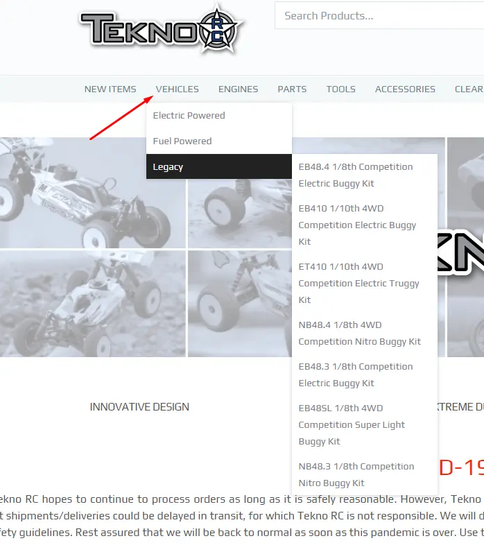

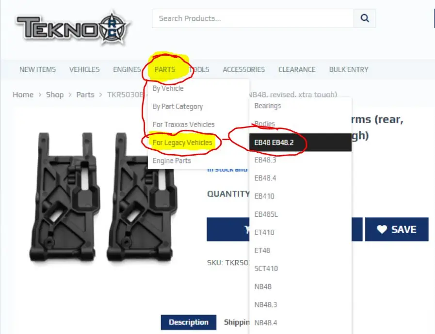

Thank you very muchm you saved me, I didn't find that car in menu. It seems it's quite old car
Chrome. You are right, eb48.2 is in parts menu, but no in vehicles menu for download manual. Thank you very much for manual
