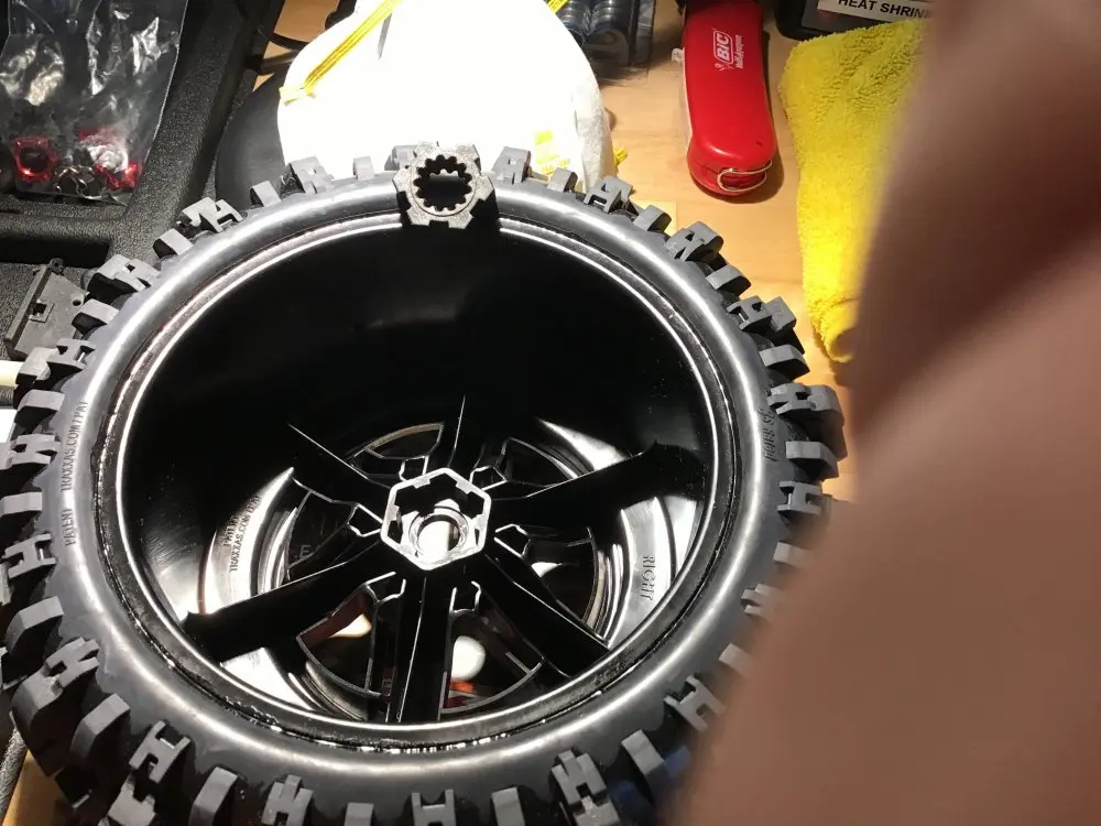

I bought some XMaxx tires on Jenny’s RC. I did not know stupid traxxas has a completely different hub system. Bought the adapter. No go. Does anyone sell the insert that would adapt strait to a normal 17mm hub? Otherwise I’m going to start drilling and cutting so the Tekno hub will go into the traxxas adapter.

I do need an offset. The problem is a standard 17mm hex doesn’t fit the tire. Traxxas has that stupid adapter

Post a pic of what this thing looks like with these tires
Those are direct fit for the Tekno. Sadly exactly what came with the kit. Traxxas hub has a spline on the hub that fits into that unquie nut you see on the tire pic. That is held on by a clip. Then it fits into the tire. I sent them back. Thanks for the input!
Couldn’t make it work. I would have had to carve the insert to fit the Tekno hub. Sent them back.
i would have just used a dremel to grind out those little tabs and make that a standard hex...
