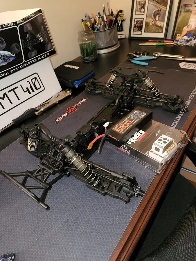

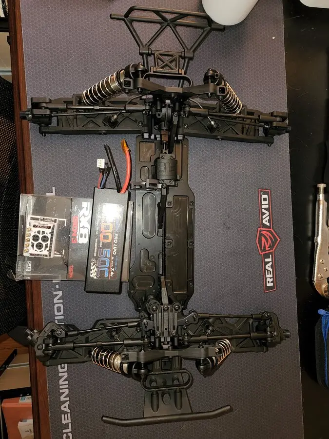

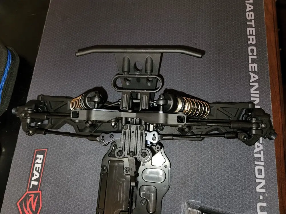

Hey there new to the thread but i Just got my first mt410. Built everything out of the box to the tee with the manual. My first question is the steering links. When one wheel hub is straight the other is turned in quit a bit. I'm assuming it's just the matter of adjusting the steering rods but want to make sure that's normal when setting the rods to the factory 60.4mm I believe it was.
Second is a buddy of mine has the maxx and I really want to know if I can put traxxas tqi Transmitter and receiver with tsm in my mt410 and still have the self rollover feature? If so could that also be really bad for the diffs as they were not technically designed for it.
As far as other electronics I only have a tekin rx8 g3 esc. No motor no servo no wheels or tires yet. Going to try double stacking 2 2s 5000mah lipos to make one 4s. Unsure of the motor to get or what kv is best.
Thanks to all in advance

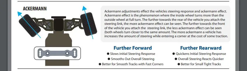

The toe change as demonstrated in the Tekno article is exaggerated a bit. The Ackerman angle is used to keep the tires spinning and not slipping/skipping when going around a corner. The inside tire is supposed to turn at a higher rate than the outside. Rc cars also run toe out in the front and toe in for the rear.
The kit builds with toe out. If you straighten one side like in your photo it's going to exaggerate the way it looks on the other side. I didn't measure the toe on mine but it looks like more than the .5 listed in the manual, others have commented the same. It's tunable, you can go more, less or toe in. Personally I like it at or around zero in the front.
You can use the traxxas electronics if you want. I would not use the self righting in any vehicle regardless of brand. It's a diff killer. You would also need a body with a rounded shape to some degree to get it to rock.
The Arrma backflip LP's are a popular tire choice for this truck.
I don't have experience with your esc but motor kv from 1650 to 2200 are common on 4S.
Keep in mind the bec is not adjustable on the traxxas esc at 6V when looking at servos. I have several Ecopower WP120T I've been happy with for 70 bucks in a range of vehicles.
