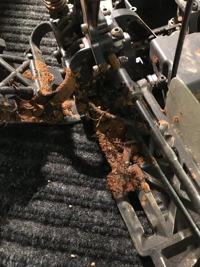

Ok next question is: what is the stock oil weight for the mt410? Is it really #700wt? Joy riding my dads “Poppy” mt410 while he is out of town and blew a shock cap. I need to rebuild it for him but can’t seem to find 700wt oil. 70wt seems more common.

The stock shock oils are in cst not wt. 700cst is equivalent to about 52.5wt.

Thanks, I was looking at the manual it was not that cleat on the oil weight.
