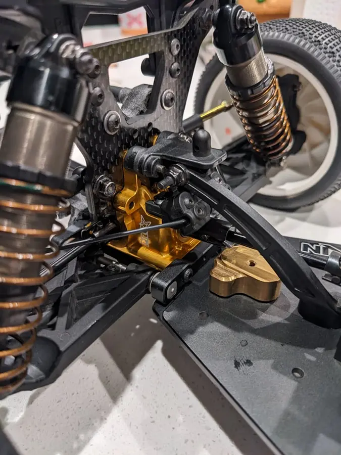

Post 2nd Day Improvements:
- Installed rear weight, added blingy-titanium turnbuckles, said prayer to the God of Droop.

Parts List:
- Tekno Lightened Outdrives
- Tekno CF steering top-plate
- Tekno CF center diff top-plate
- Tekno CF front/rear shock-towers
- Tekno alum shock caps (why aren't these included in the kit?!)
- Tekno EB410/ET410 Alum center diff support
- Tekno brass weight (added after initial build)
- Klinic titanium turnbuckles (added after initial build)
- Prostar 240SL Rear Bumper (added after initial build)
