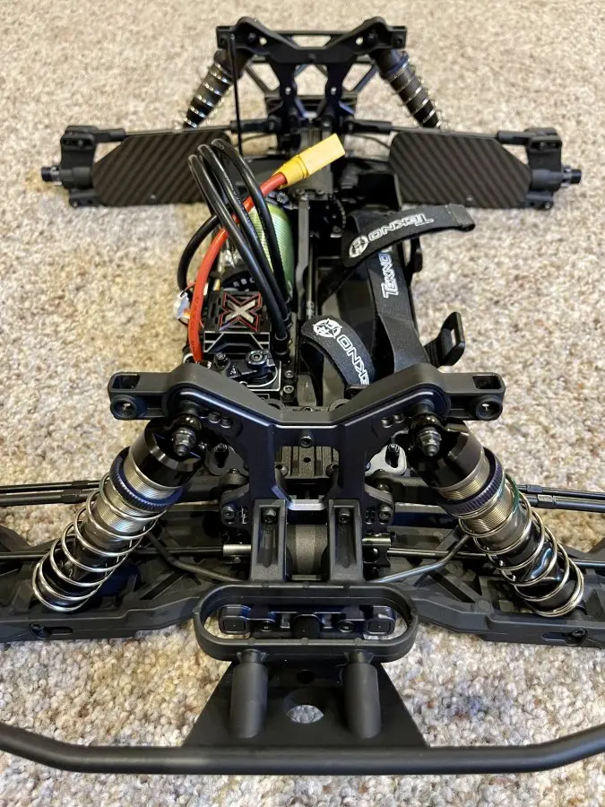

Yep, that's the fancy combo!
This is how it fits in the MT410, tight but no problem at all:

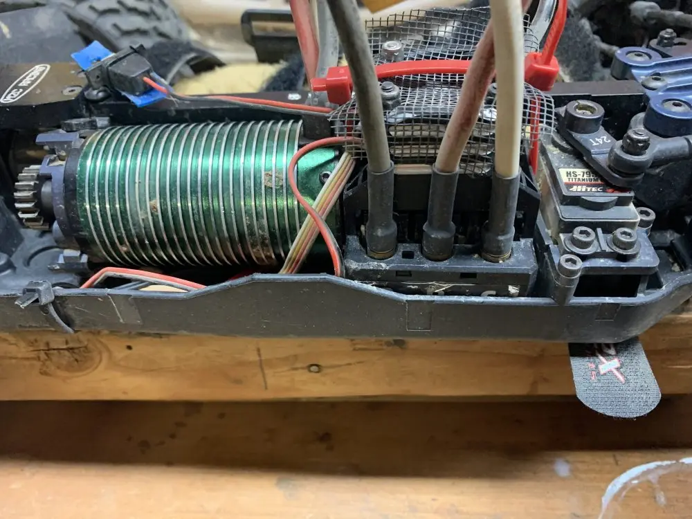

I just swapped motors between my mojave(TenShock 6pole 2200kv) and my mt410 (BLX185 2050kv) because the esc in the mojave kept hitting thermal shut down. Motor temp was only 120f. I didn't have a 13t pinion to drop to(from 14t), so, figured let's try this..not sure if it'll solve the overheating esc yet, haven't had a chance to try it.
What I found interesting though is, the Tenshock is supposed to have a kevlar wrapped rotor.. do you see ANY wrap at all on this rotor?🤔😮
I opened it up to lube the bearings, it's 10 years old. The wrap has been missing for a couple years now( that I know of)LOL.
