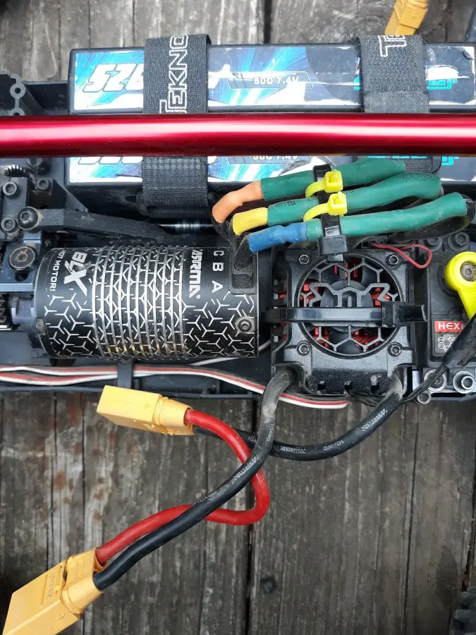

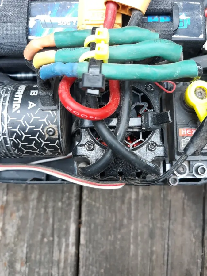

You bet. The MT410 is essentially a 1/10 chassis with long suspension arms(ET48). So with that, the chassis is pretty tight. The blx185 is pretty standard 1/8 combo. Here's a couple picks just for reference. Disregard my kindergarten wiring,LOL.
I was looking at the HW Max 8 G2 Combo 4274SL (sensorless), 2250KV. Do you think this combo would fit right in without having to reposition the ESC? I appreciate your taking the time with all my questions, I don't want to screw up and buy the wrong setup.
It should be okay with the backflip LP's since they're relatively lightweight. If you decide to go bigger on tires, like say badlands, trenchers or backflip mt's you may start running hot on the motor. Fans can keep things in check for sure, I believe you'd be fine with it, just make sure you keep an eye on motor temps, add quality fan(s) and mounts if needed.
The mt410 should run well with that combo.

Hey bud, I just found out that new max8 g2 combo with 2250kv may require an esc relocation to fit. The motor is 42x78..my apologies, I thought it was a 42x74..
