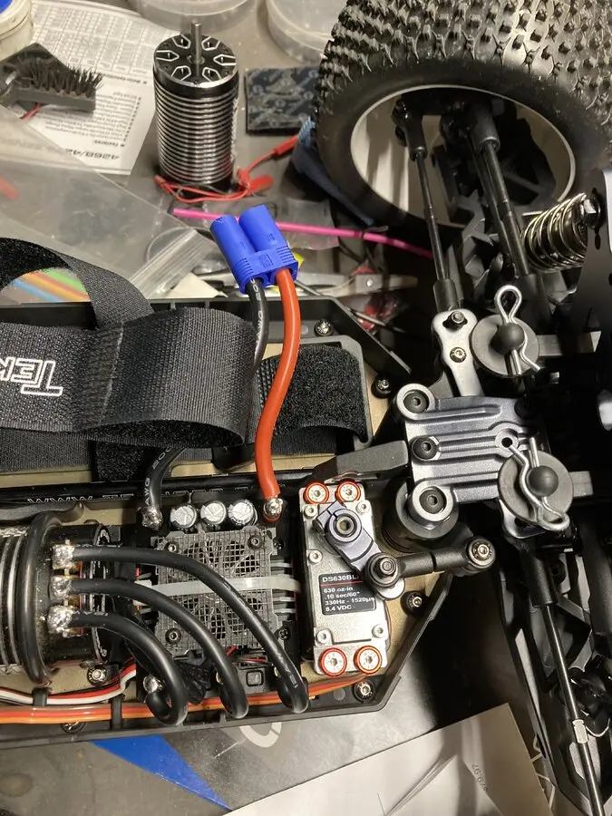

For a servo look at Promodeler ds630 or ds505 they are American made and better than any Savox out there. You can only by them from promodeler no middle man to jack up the price. The ds630 is 630 oz in torque at0.10 second for $110 built to military standards.

For a servo look at Promodeler ds630 or ds505 they are American made and better than any Savox out there. You can only by them from promodeler no middle man to jack up the price. The ds630 is 630 oz in torque at0.10 second for $110 built to military standards. View attachment 7291
Thanks for the recommendation. Did you need to modify anything to get the servo to fit in the stock kit? I saw some mention elsewhere about minor modifications needed due to the wire position on the servo.

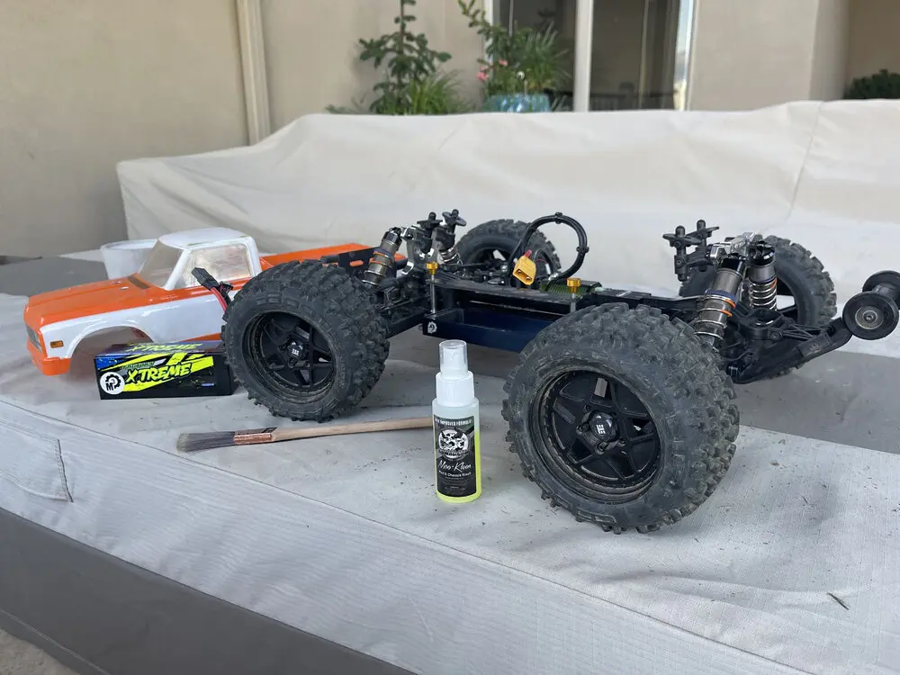

Tires - I’d drop down to the 4S BackFlips instead. Lighter.View attachment 7347
No the servo fits really good
@Lynny Thanks for the servo suggestion. I just picked up the DS630. Looks like a tank.
