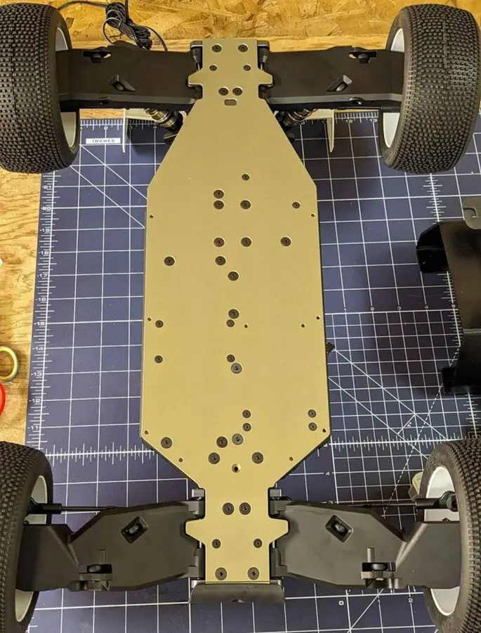

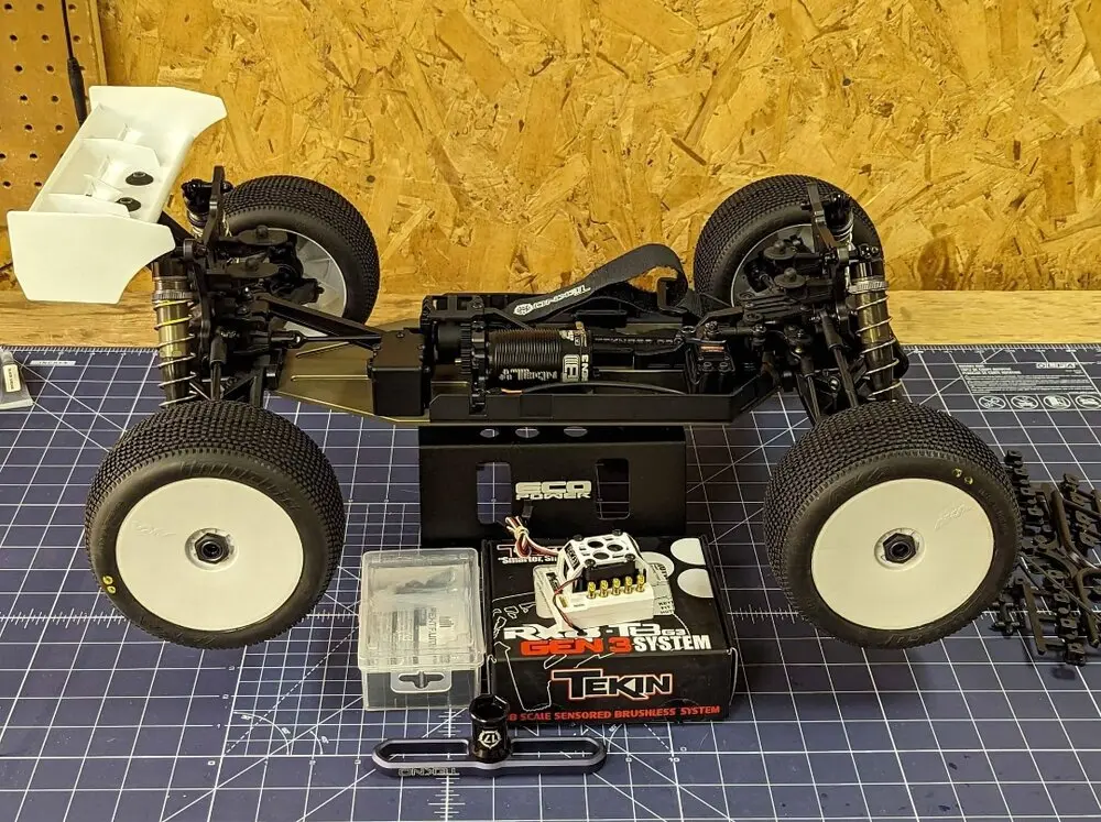

Hi. I'm getting a built, but never run ET48 2.0 later today (pics attached). I'm coming from Traxxas Slash Ultimates (I have 2) and I'm pretty used to running and fixing / diagnosing those. I'll have a few questions after providing some basic info.
So far it includes:
  • Built ET48 2.0 kit
  • Installed Spektrum S62 85 servo

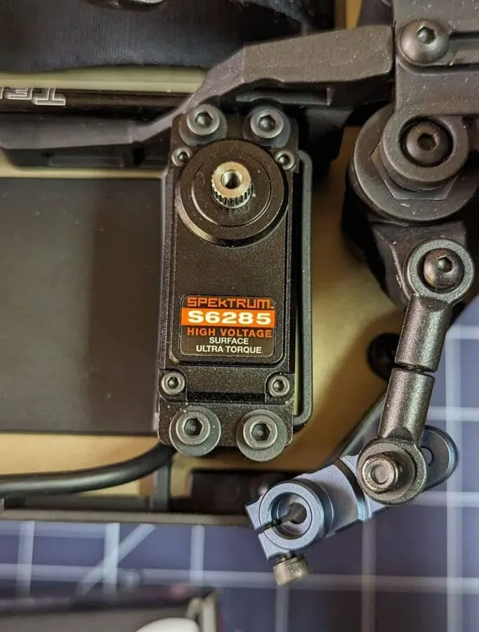

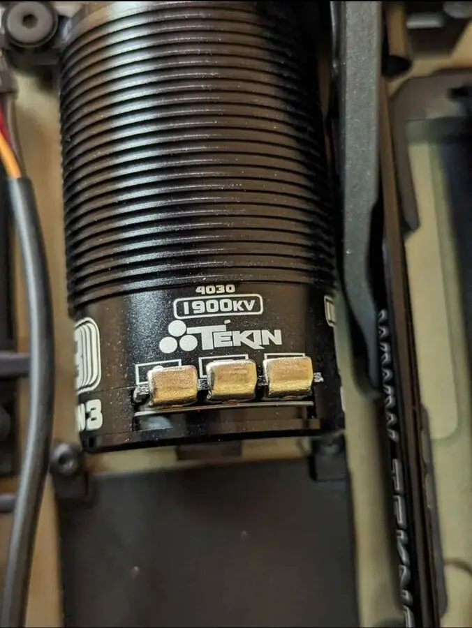

  • Installed Tekin RX8 Gen3 ESC / Tekin Redline T8 Gen3 1900kV motor combo
  • AKA wheels and tires
  • Tekno M5 Mod1 pinion & Aluminum Servo horn
  • Leadfinger painted body
  • Also have a Flysky Noble NB4 Radio Transmitter Remote Controller Receiver

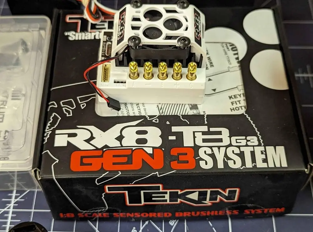

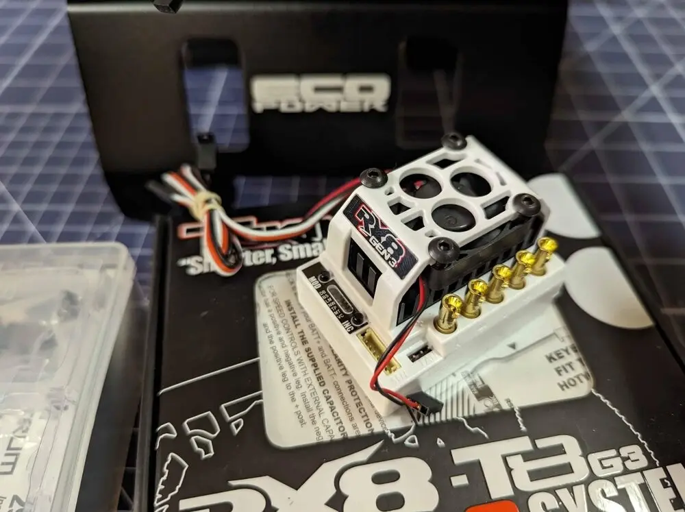

  2. Capacitors - Will I need some sort of capacitor pack to deal with ripple voltage? Is the Tekin already good to go on that front?

  2. Capacitors - Those are a thing of the past, particularly with Castle ESC's but their newer generation ESC's have stronger BEC's just like everyone else today

  4. ESC programming - I don't run Tekin but I always invest in a programming card regardless of brand I run

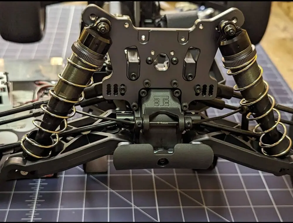

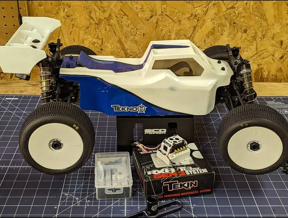

Bill what do you think of using shock socks (my local track is outdoor dirt)?
What about adding a cooling fan to the motor? Something like this cooling fan?
Shock boots are already visible on your truck, not familiar with "shock socks" other than I've seen folks wrap the springs with balloons but they seem to be more trouble than they are worth, far easier to blow your car with an air compressor after every run regardless, no such thing as a "car condom" anyway where the boots protect your shafts from getting scratched and that's all that matters ;)
I've never had the need for a cooling fan on the motor for truggy but if you're seeing temps go above 160°F then I would install one, more info here:
