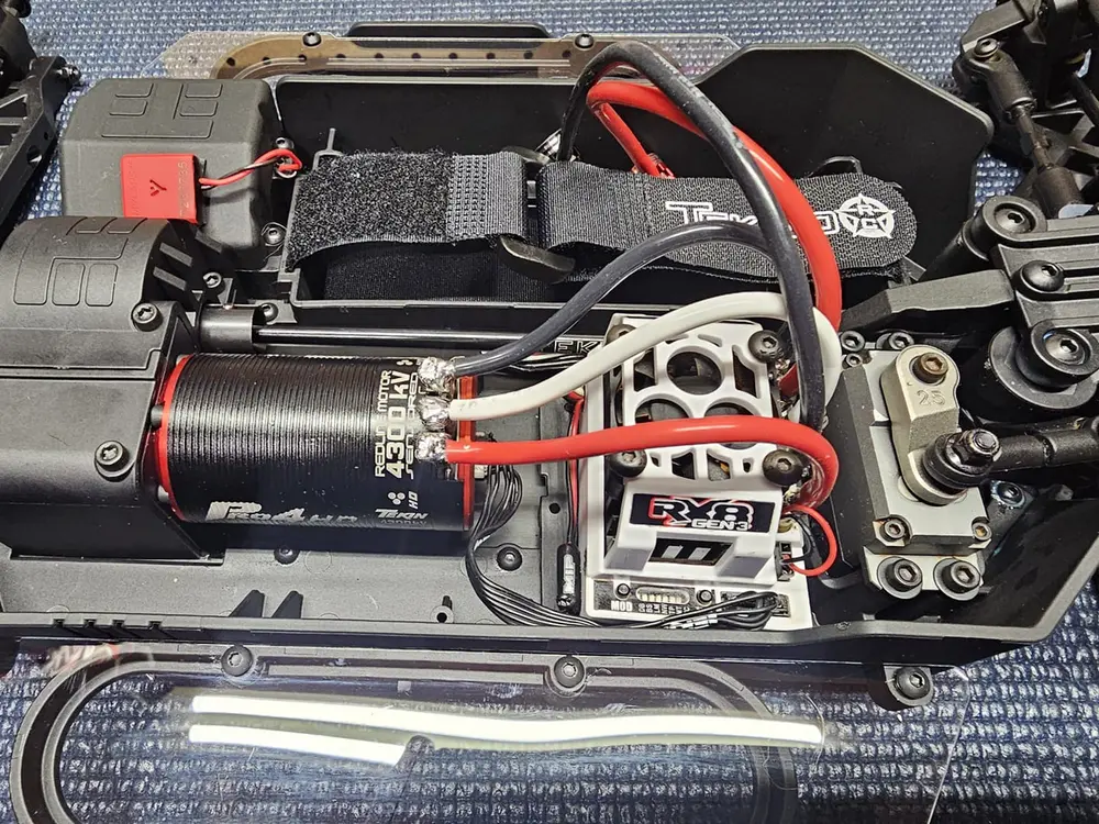

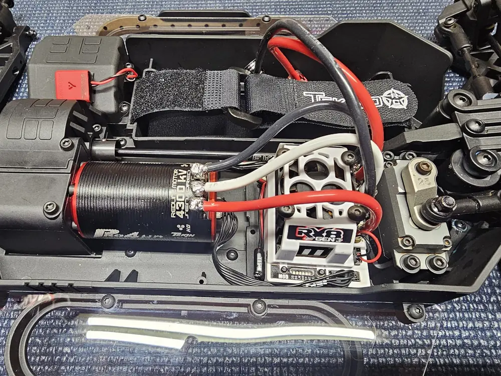

any one have pics of their lay out with pro4/rx8? what gauge wire are u using and are u running bullets or did u go to a connector
probably going to be wiring up sunday or monday just lookin for some insight

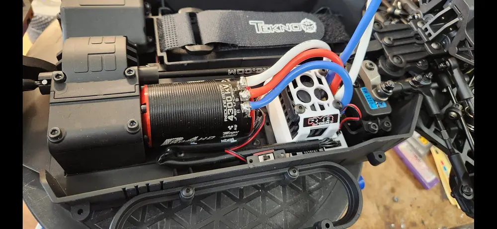

Every time that I've seen that Tekin combo used, it's always like manual, and Tekno's promo pictures...

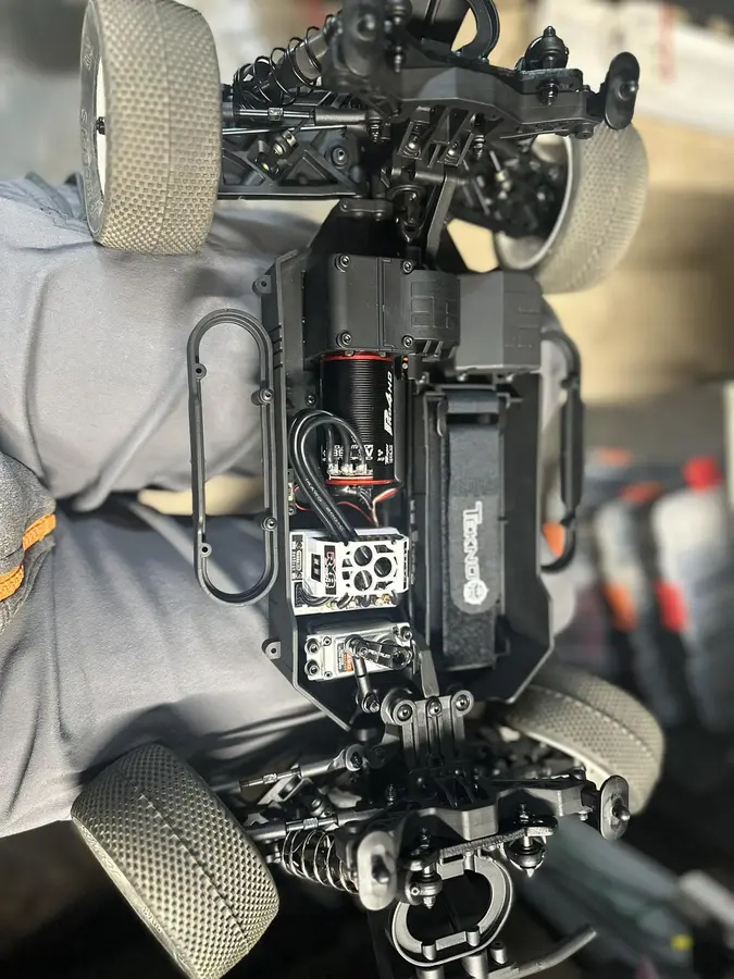

i figure u grabbed this pic somewhere else, do u remember where? have a question about the sensor wire. id love to use a stock shorter one than the one mine came with because its way too long for this application
You should be able to run as short as 50mm for the sensor cable. I usually run 50-75mm length.

yea i found them and asked the guy who posted them
that would be a bit short for me
i ended up with a 100mm and it works but i would like a little more slack so im ordering a 125 for when i have it apart again to swap
