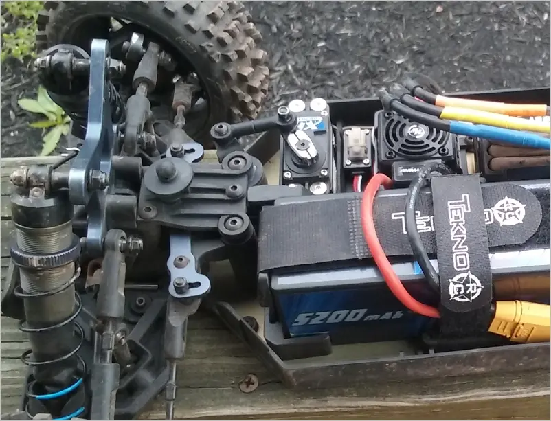

Not sure what your plans are (racing/fun running "bashing"), but if having any hints of club racing, you will be better off getting a sensored motor setup for better low throttle control on tight courses.
A little note on the new Hobbywing EZRun Max10 G2 speed controls. They are sensored, but have a proprietary sensor cable, and if wanting to run other non EZRun G3 sensored motors you'll need Hobbywing's sensor adapter cable:
For my upcoming ET410.2 build I'll be putting the Ezrun Max10 G2 80A 3652SD 4100kv G3 combo onboard. I'll not be racing. I just "bash" my RCs on bumpy/tight 90'x100' backyard track.
People put all kinds of electronics packages onboard their mini truggies. Maybe contact/visit the track and ask what everyone is running.

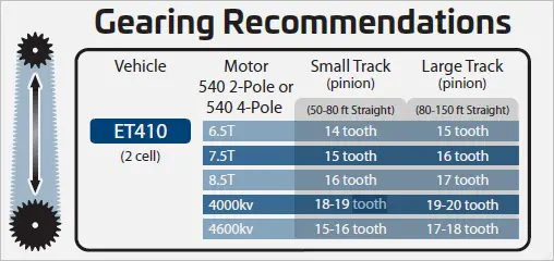

Manual shows some recommendations..

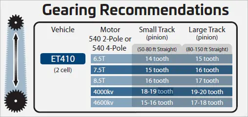

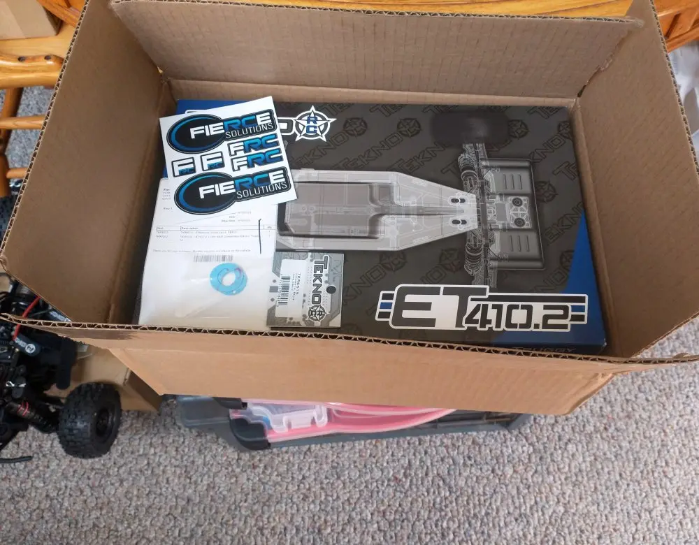

Ordered and arrived 👍 :cool: . Needed $0.01 more to use $45 coupon... diff gaskets added to order.
Will certainly be a slow build, and gotta wait for parts to trickle in.

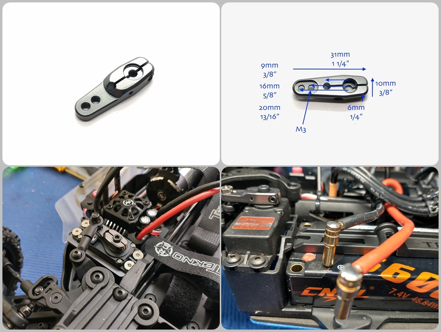

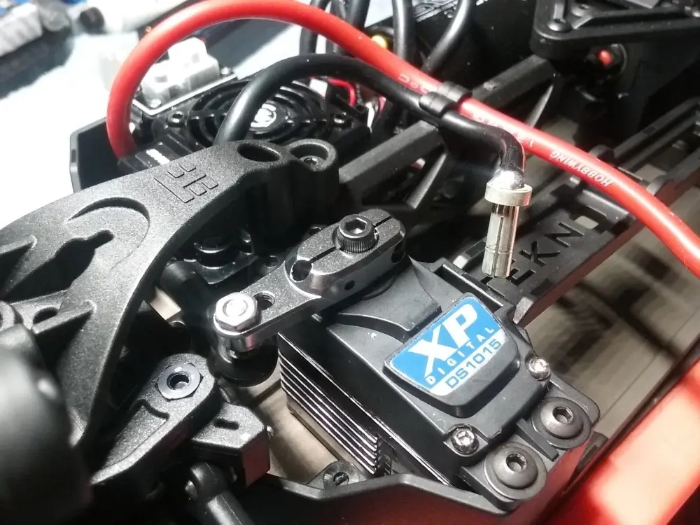

Don't forget to get a servo horn if you haven't already. I always forget.
Once I found one that I really liked... I stocked up because I feared I would not find them again. I wasn't quite sure if they would hold up to eBuggy abuse, or not. Four years and counting.
