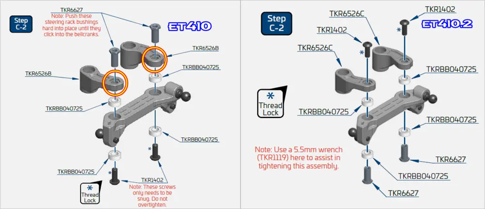

Is it correct to assume the TKR6526C – Bell Cranks & Ackerman Plate (that comes with the EB410.2, ET410.2 and SCT410SL kits) has the same geometry as the TKR6526B bell cranks, and can be used on the ET410 as an updated part?
The only thing that changed, that I can see, is the keyed areas (in the ET410 bell cranks) have been removed.
Geometrically everything is the same. We flipped TKR6627 because it often stripped out the plastic bellcranks (TKR6526B).
