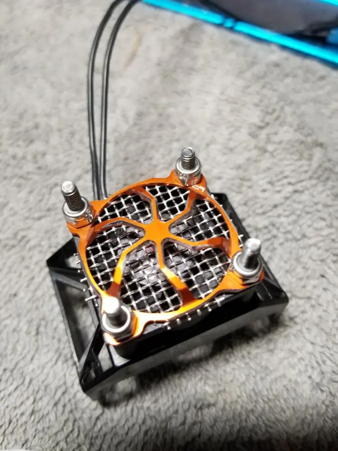

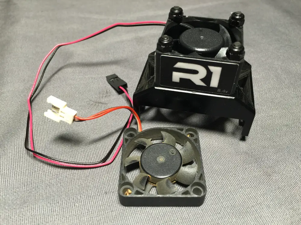

I bought the R1 Wurks fan based on your thread and photos. I've also got a Castle MMX in my 48.3 and wanted to clarify something. It looks like you may have removed the MMX fan guts and used the stock MMX fan shroud to mount the Wurks fan. Is this correct?
Thanks.

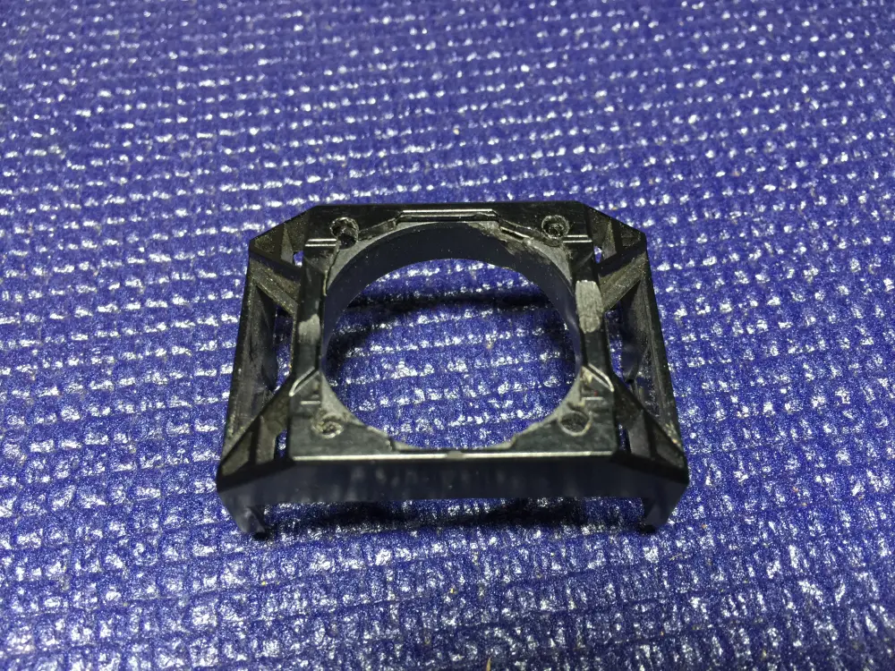

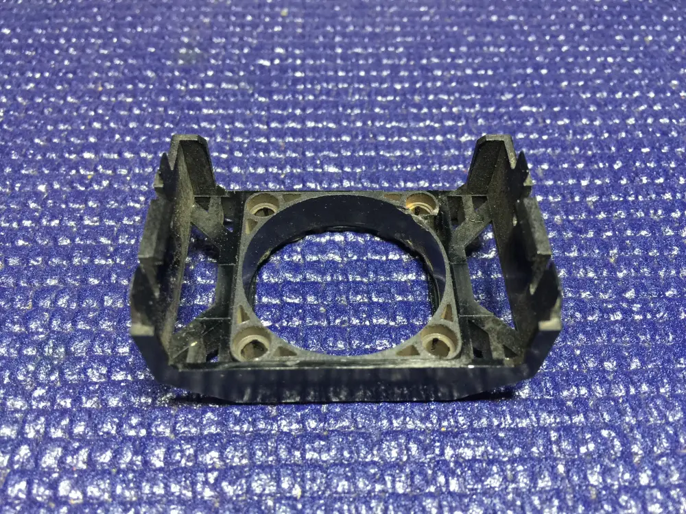

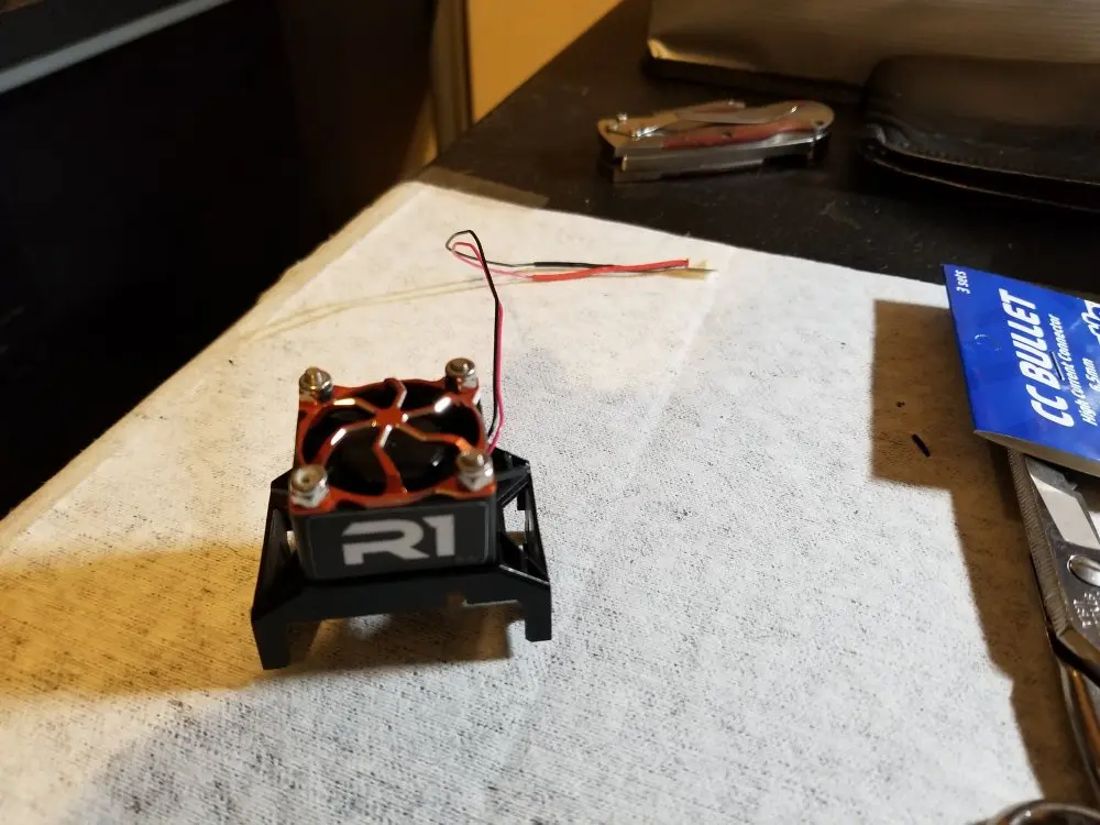

Dremel out a hole in the shroud and an old fan case to use as a mounting base.View attachment 533
Drill 4 holes for your screws.
R1 vs stock, major difference.
Looks great

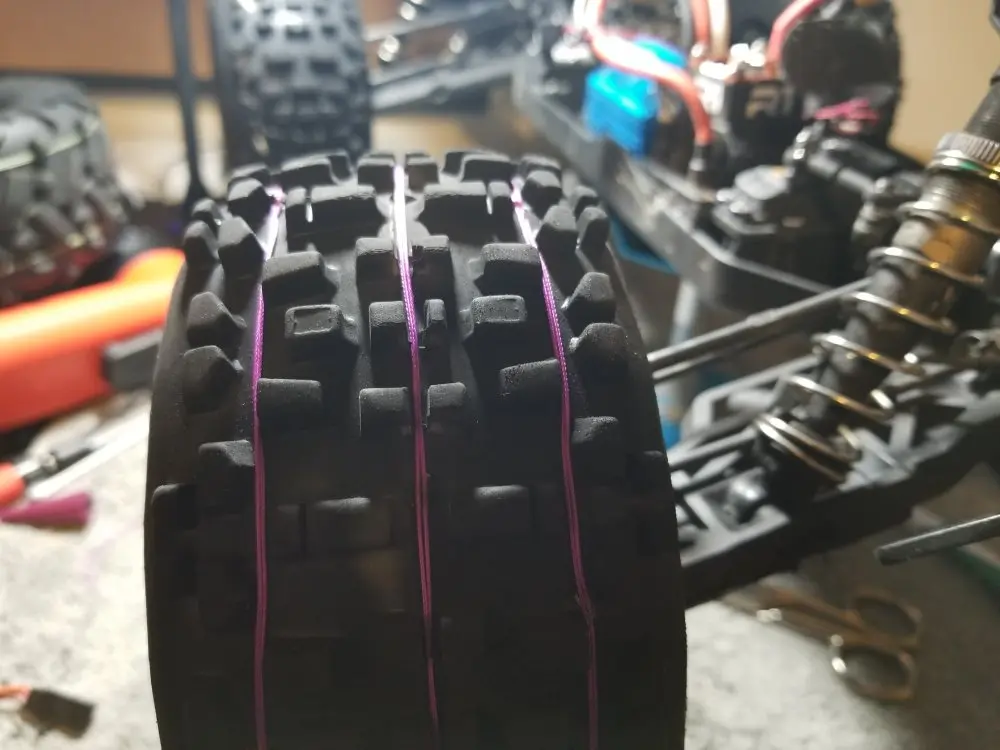

I see that you went the dremel and fishing line approach instead of the baking and taping approach. That turned out really nice and I personally think will work better than the taping method.
