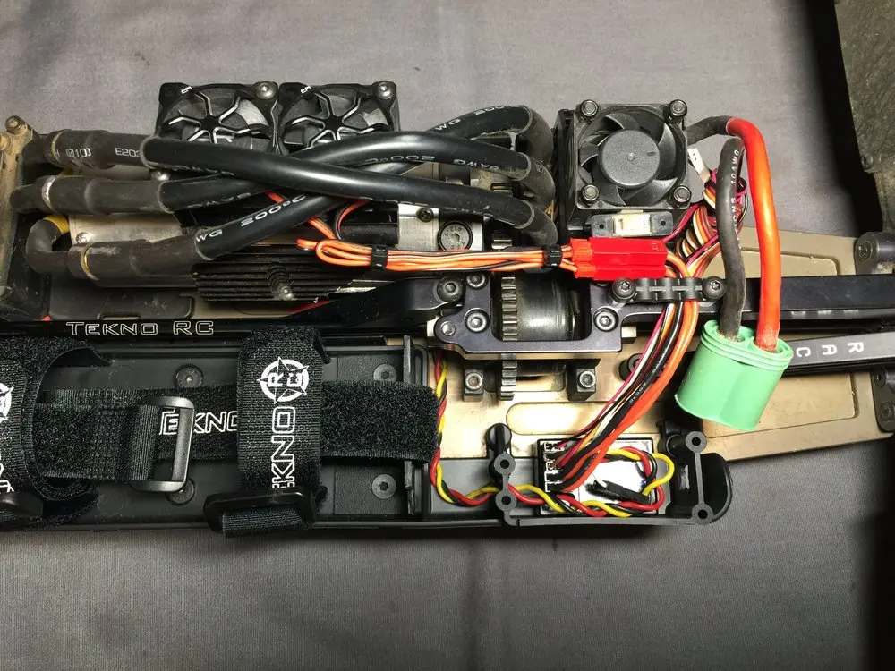

Hey @Overkill, I’m basically setting up my ET48 like yours. Where and how did you mount your receiver and how did you route the wires to it? Thanks in advance!

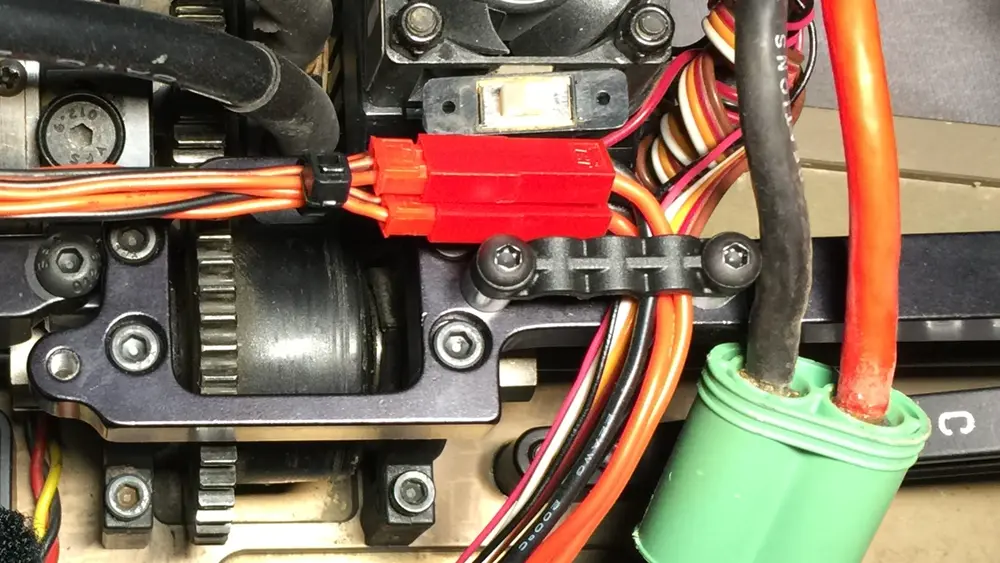

This is my layout. I reamed a hole in the unused servo area for the servo wire to feed through and be out of the way. All of the other wires are secured with the Tekno wire guide which bolts right up to the M2C brace. My Futaba receiver has a built-in antenna so I don’t have to worry about mounting one.
This is a very convenient feature on the M2C chassis brace.
Thanks man!
