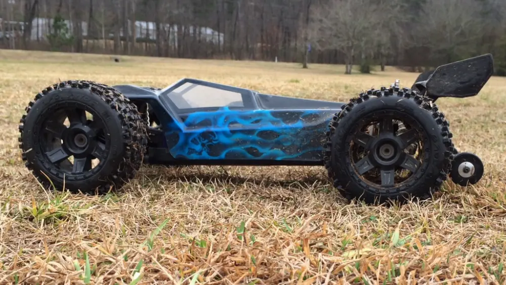

My slow truggy
I run the Fioroni Losi center diff case in one of my trucks and it's a VERY nice piece.

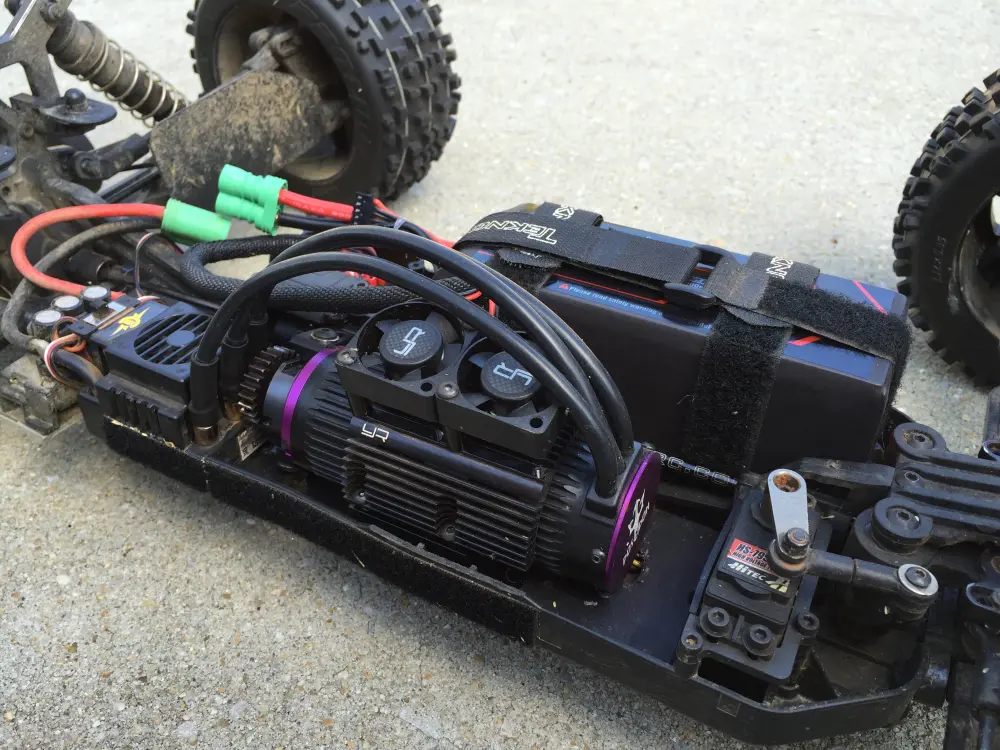

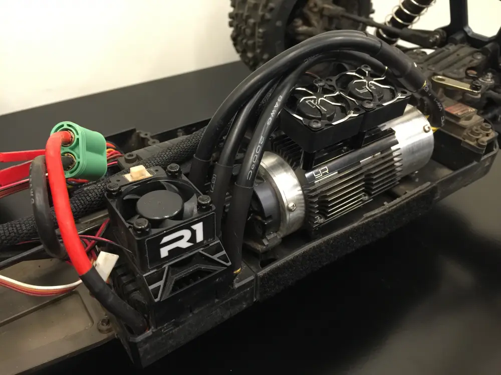

This is my grass destroyer. I started with a TP 4070 1440kv, then went to a Poseidon 1527 1500kv, and now I'm running a Cordova 1440 2000kv. I really like the higher kv motor from Cordova, the power is so violent and it runs so cool.
Cordova 1440 motor, 40x102mm, 631g, 2000kv
Yeah Racing heat sink/fans/shields
Castle 8mm & 6.5mm bullets, 8awg wires
20-25T pinion
Castle MMX ESC

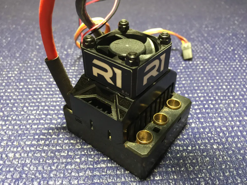

R1 Wurks fan, 30x30x15mm, 10g of thrust @ 8.4v
This fan blows a ton more air than the stock unit.

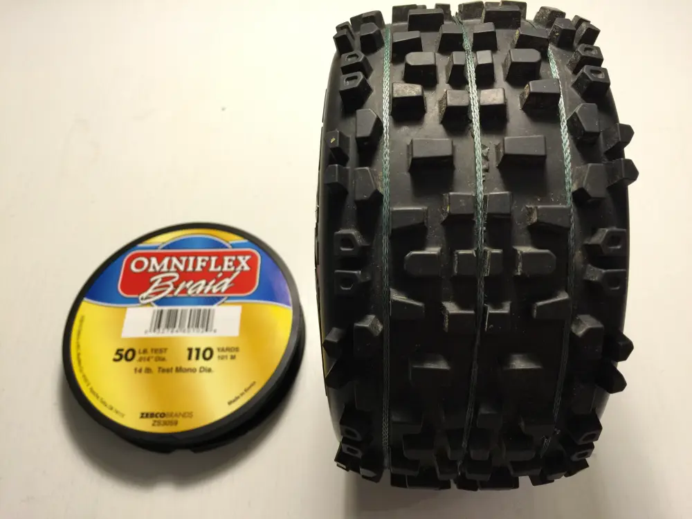

The Proline Badlands are belted with fish line braid, which means zero ballooning. Without this, the tires would instantly explode.

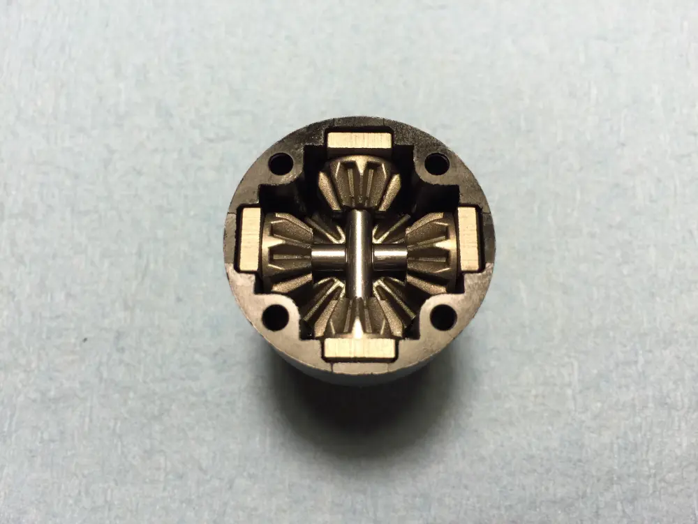

I'm running the Losi HD center diff in this one. It has metal inserts for durability and holds a lot more fluid than the stock Tekno case. The stock Tekno center diff turns into lava with this amount of power. This was installed a long time ago, before the M2C Tekno aluminum cases came out.
I'm running the Turnigy Graphene 6S 5000mah 65C batteries. This battery can handle the massive amount of current produced and doesn't run hot.

I was going to ask why you are running the Losi center diff rather than the M2C Racing version, but as i continued to read, you answered it already. I run all 3 M2C aluminum diffs in all 3 of my Tekno rigs and couldnt be happier, plus i dont see how anyone could possibly blow one up with motor power alone, plus with the more than double fluid capacity over stock i noticed right away that they never run hot. I especially like how the center diff cases are threaded like a large bolt on the outside to act as a spinning heat sink also. Once i ordered the first set for ly ET48.3, i ordered the full set for both the SCT410.3 and EB48.4 at the same time as the kits qhen i ordered them a couple weeks later. I would say that they are nearly required upgrades if you run big power in these rigs and dont want to blow up or boil especially your center diff fluid or cases. Although i dont have the motor setups like you, i do sometimes run 6s with my Tekin Gen3 2650 kv buggy motors in the SCT and EB along with the 2200kv truggy version in the ET, so all 3 have more than enough power and speed. I couldn't imagine having any more than what mine have, especially on 6s. If you have never seen an SCT410.3 with a 2650kv on 6s, it is absolutely nuts being that its so light lol. Because of the big body its a challenge to keep it from parachuting and simply lifting off at around 50 mph or above, even with tons of air relief holes onnthe back end of the body. With my "scale" raptor body which has no holes, even the 4s setup is difficult to keep it on the ground haha.
Yeah the M2C cases are awesome, I have one in my buggy. Having double the oil capacity really keeps heat down and the aluminum case protects from rocks. 2650kv with 6S sounds like fun. (y)

Hey Overkill, what are you running for diff oils in that “slow” truggy?
I am running 80/300/50 f/c/r and it feels too heavy in the rear for sure. I am still debating whether to come down in the front. My center diff melted when I had 80k so I bumped to 300k to reduce heat in the center. I might come down in the center but would also need to turn down the torque in the esc.

You can run lower weights if you have a larger center diff that has a large oil capacity, you don't have to worry about melting the case. The higher in weight you go the more RWD it feels and the lower you go the more 4WD it feels. To a point, you can't go too low. When you're putting down 3000+ watts off-road, I like some control and stability.
60F/100C/30R

My original TP 4070 busted the end cap open when I was driving on a BMX track. While I was waiting for replacement parts I ordered the Poseidon 1527 and ran that for a while. I wanted to try a higher kv motor and found a good deal on the Cordova. Cordova is well known for stuffing the most amount of copper wire that can physically fit inside the can.

I prefer the higher kv motors (higher rpm). It was very reliable when I ran it. It all depends on how much power you're putting down, there's a huge difference between a 15T and 30T pinion of course. I've been pushing these harder and harder over the years and have found the stock gearbox with small pinion bearings to be the biggest weakness when you're at the highest level. I run the All Racing aluminum gearboxes with larger 5x15x5 pinion bearings and beefy 7075 construction. The diff gears themselves are bullet proof.
