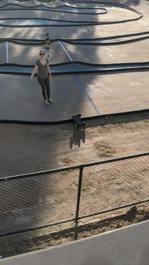

Cheers ill look into that yes one of my public local tracks is pretty hard surface. ( wife yelling at me stay on the track :) ) New to this whole race track thing and its alot hard than it looks thats for sure. keen to learn and understand car setups more.

Thats a nice looking track there! Looks to be pretty smooth and probably a clay surface by the looks of it. After seeing that pic of your track I would run it box stock and mess with setup vs getting upgrades. I am going to bet it will do really nice on that track!
