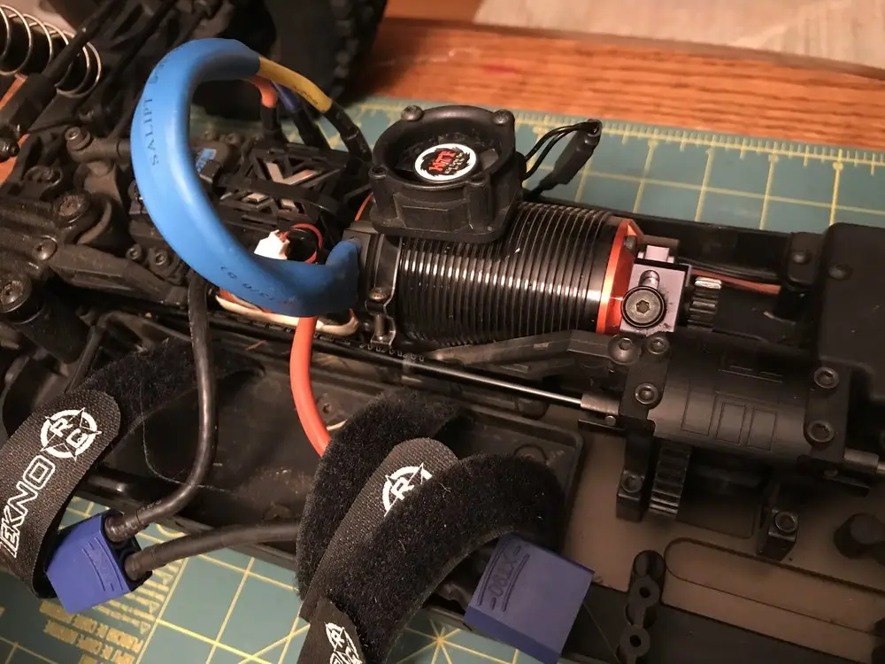

Alright, I ground my center brace down a bit with my dremel to allow me to run a 15T pinion. I’m going to run it tomorrow and hopefully my temps will be cooler. I will also get a video so you can hear the gear noise I’m talking about.
307
182
ET48
I’m loving the Backflips. I haven’t been on a surface that I haven’t liked them on. I highly recommend them. Tons of grip, even in tall grass and they wear great.

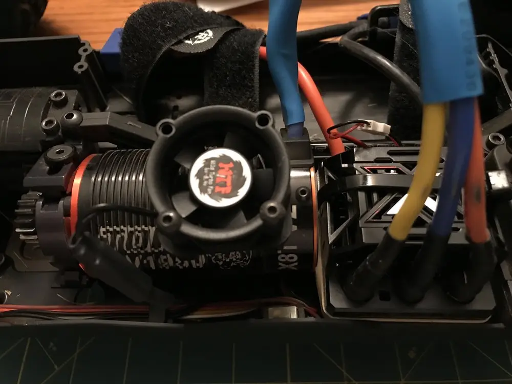

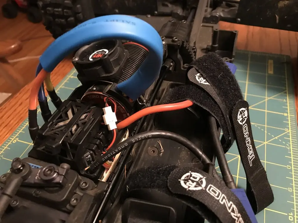

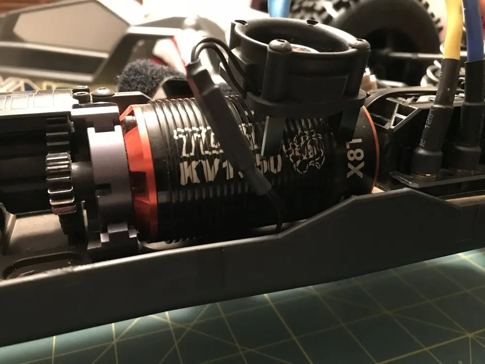

Since my last post I added a WTF Windy Fan using their bracket. I had to stretch the bracket a little bit to get it around the can but it’s a good fit and doesn’t move. It’s seen some hard hits and plenty of gnarley rolls and it’s held great. I only have the one on the back of the can but it keeps the whole motor cool and an even temp. The rear of the can was always the hottest and now the whole motor is about the same temp front to back.
The front is still making the noise so I ordered another diff case, pinion and bearings for it in case it goes out. I’ve shimmed it and all that so I’m done worrying about it. I’m going to bash it until it won’t bash anymore and then replace it if it comes to that.
Here’s some pics.
Edit - on a 85 degree and humid day my motor temps stay about 130 when running full out in tall grass and hard acceleration. I try to never apply the brake though.

So, it’s been a while since I’ve been on here but the truck seems to be running well. The WTF fan I added really moves a lot of air and seemed to help quite a bit back in the summer. I would recommend it. Eventually I would like to design and fan shroud for it and print it.
How does that fan seem to be holding up? There is a member over at ArrmaForum that was having issues with the guts falling out after large jumps.
He ended up making a custom fan mount that supported the bottom side of the fan to prevent it from falling apart.
307
182
ET48
It seems to be holding up pretty well but I haven’t been too hard on it in terms of high altitude landings but it has taken some fast tumbles and held up so far.
Fully supporting it is the best way to go. The only problem with that on the Tekno is there really isn’t a whole lot of room in there.
