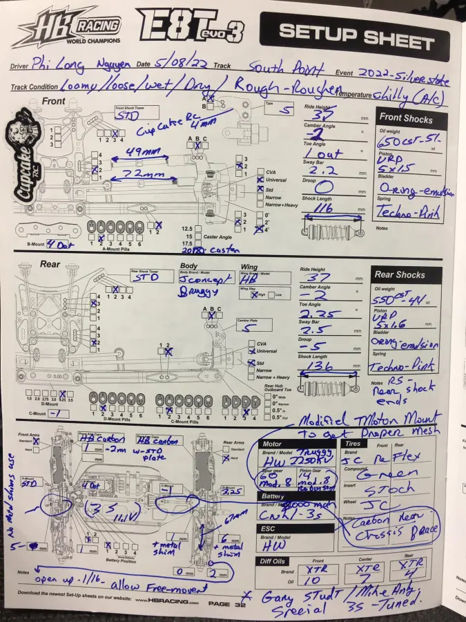

Many folks are starting to run their truggies on 3S... gearing up from 16T to 18T pinion and using timing/boost in the ESC to get more top end power.
Here's a sample video clip of Phi Long (aka Little Bump) running 3S in his eTruggy:

The 3s part is very interesting, have to look more into that. Thanks 👍
