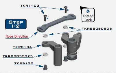

I forget to thread lock some screws on the steering and I lost this pieces, TKR1403, TKR5122, TKRBB050825

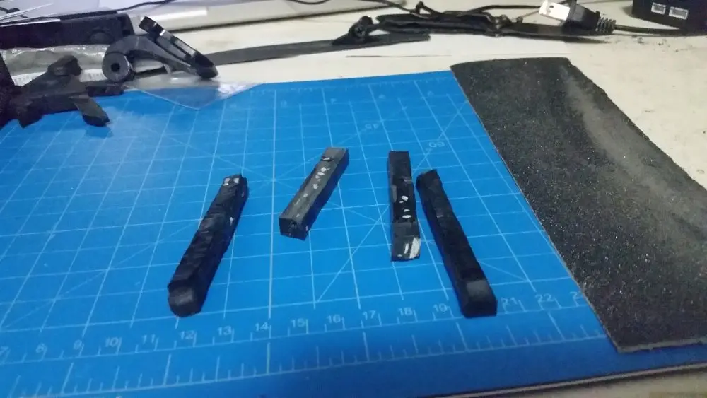

I modify the regular body post shaving that base and installing a washer as news base so now the secure pin can be installed, the problem now is the that I have a weaker body post all of them broken, what do you think on making that body post on aluminum? I mean homemade.

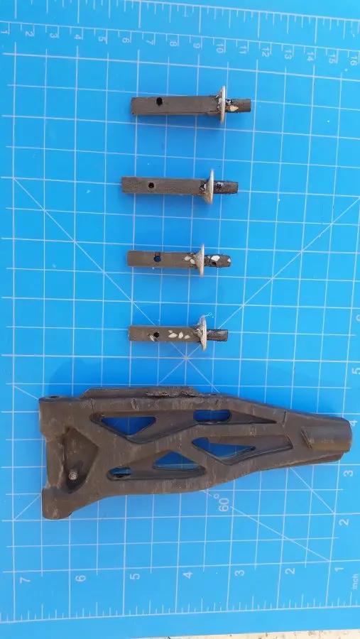

I don't want to buy new body post so I recycled a broken Kraton arm and convert it to body posts suitable for unbreakable body
Wow antigacho that is a really good idea, good job being innovative :)
We use too use rpm body posts from the t-maxx / e- maxx and shave them down too fit the body post holders on the mt4-g3 which are a lot lIke the body post holders on the mt410, after that never broke a body post again, but I'm betting you probably will not have another breakage, those arrma kraton arms are pretty tought. :)

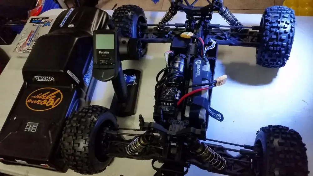

I finally finish my MT410 project,
I´m planning the first run for tomorrow.

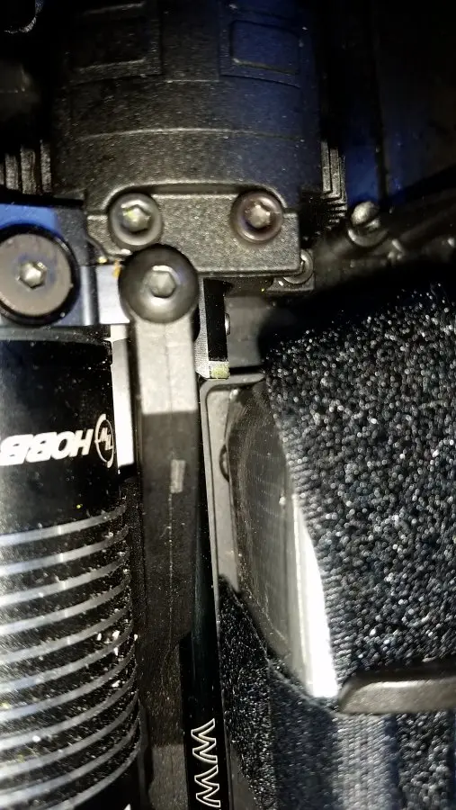

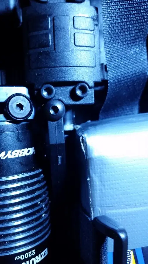

My final worry is the battery size, by now I only have a zippy 4S that I use my Kraton but it doesn't fit wells on MT410, it barely clear the center driveshaft.
I definitely need a hard case battery. but nobody sells those nice SMC batteries for international shipping. looking for alternatives with suppliers that can shim lipo batteries internationally
I think I condemned to light bashing till I get a new hard case battery
This is looking great! Can you cut a piece of lexan the size of your battery and put it between the battery and driveshaft?
