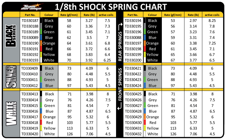

I've got some super stiff white Durango DNX408T springs, haven't run them yet. Idea was to use them for street or jumping...
they are a bit shorter than the teknos and require the collar all the way down in the back for the arms to sit level. i could have gone with rear springs in the front too but wasn't aware how much shorter they were until they arrived.
Looks like the Orange Tekno springs are front 4.8/ rear 6.11 lb rate, the white Durango's are 7.06 lbs front/rear
Team Durango 330420
Team Durango 330432
