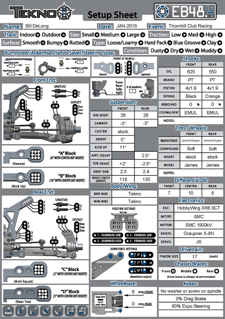

I recently sold my .3 and upgraded to a .4
on my EB48.4 I'm currently running 7-10-5 and that's working very well for me :)
Here are my setups:
