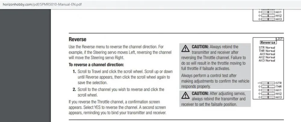

I apologise if this is a very basic question but I am very new to all this!! Trying to set up the dx5 rugged and the trigger action appears to be the wrong way round push forward to accelerate and pull trigger to brake/ reverse. Can this be swapped around and if so how. TIA?
Yes, all channels can be reversed and most ESC's require you to reverse the throttle. you will need to re-calibrate the ESC afterward:
https://www.horizonhobby.com/pdf/SPMR5010-Manual-EN.pdf
Your radio should have a setting to reverse the channel (at least both of mine do).
