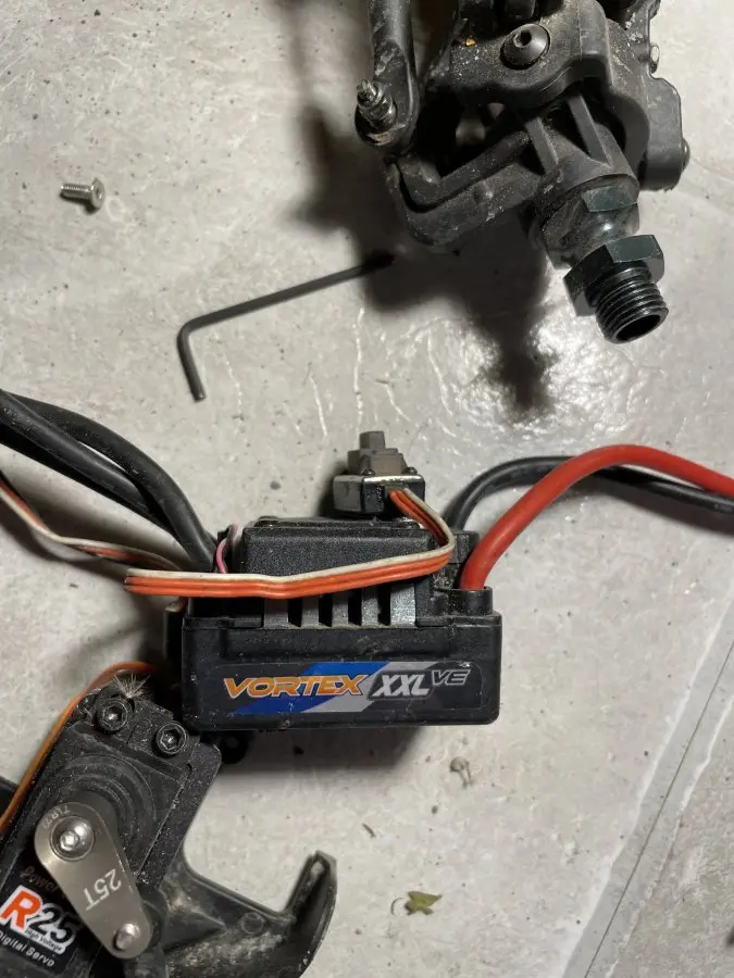

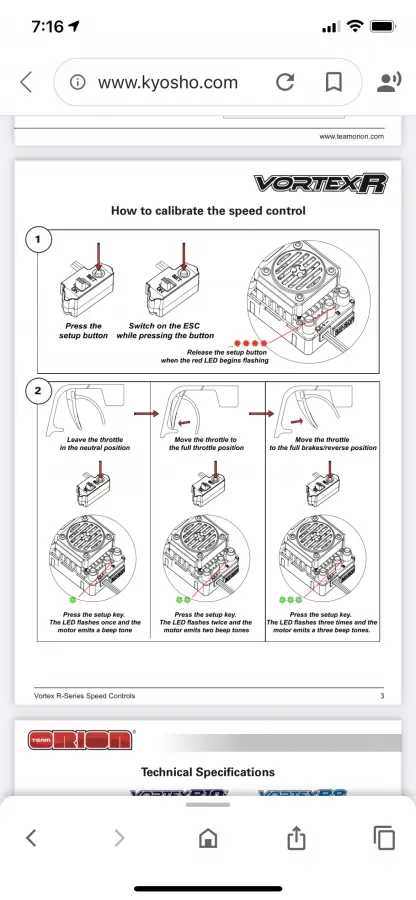

So yesterday I had my eb48 2.0 out for its first test drive and it was awesome! However as I was driving I drove into a little bush and tried to reverse out but the reverse stopped working. So I went and pulled it out and kept bashing until the battery ran out. Once I got home I gave it a good clean and went to program the esc (orion vortex xxl ve) and after I had done the neutral, gas and brake they were all backwards and now my steering isn’t working). Perhaps the manual I was using off the website isn’t the correct one? I will attach a picture of the set up I followed. Please help me straighten out the gas/brake and steering.

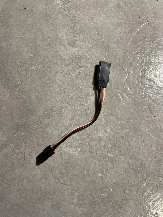

Ok so I figured it out, I just did the steps opposite (when it said put trigger in accelerate I put it in brake and vice versa) also figured out the steering. The shop that hooked up the electronics added a line from the servo to the receiver, i took it out and plugged the servo directly into the receiver and now the steeri g works. Question though, do I have to reprogram the low voltage detector? In my instruction manual it said to reset the whole esc hold down setup key for 5 seconds. I never did that though, should I be ok?

It is a flyskyrc. I finally found the proper manual for it and it says I may need to change it to reverse on the transmitter. I will give it a go tomorrow.
ok so I have tried the reverse and it does nothing. I'm so confused as to what I am doing right now. I follow the steps for programming but when I try and run the vehicle the acceleration is slow but reverse is the speed the acceleration should be.
Hmmm.... that’s a tough one. I don’t see the reverse option in that manual, the esc might not have that option.
