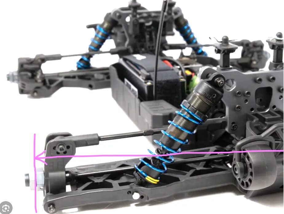

Can someone measure their EB48 2.2 from outer hex to outer hex? (picture below for reference). I'm trying to find out if the Tekno EB48 2.2 has the same track width as the discontinued Arrma Senton 6s BLX. I realize that I can look up track width, but I have a suspicion there is no industry-wide standard method for measuring track with, and that each person/manufacturer may vary in their method.
If the track width between the EB48 2.2 and the Senton 6s are "close enough" I'm going to start a build thread for an "TekArrma" Senton 6s. Thanks guys!

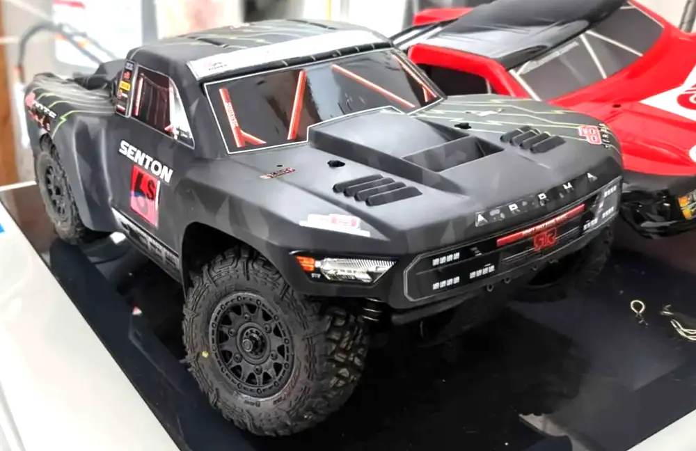

Since the Senton 6s has been discontinued for many years, most Arrma fans will convert the Typhon BLX or TLR into a Senton 6s; however, the track width on the Typhon is wider than that of the Senton 6s. Therefore, those who have made the Typhon to Senton conversion have had to cut the body wheel arches. I don't want to do that.
Here's an example of the original Senton 6 side-by-side with a Typhon with a Senton body. You can see how far the tires stick out on either side of the body, keeping them from "tucking in" as they are meant to on a short course truck.

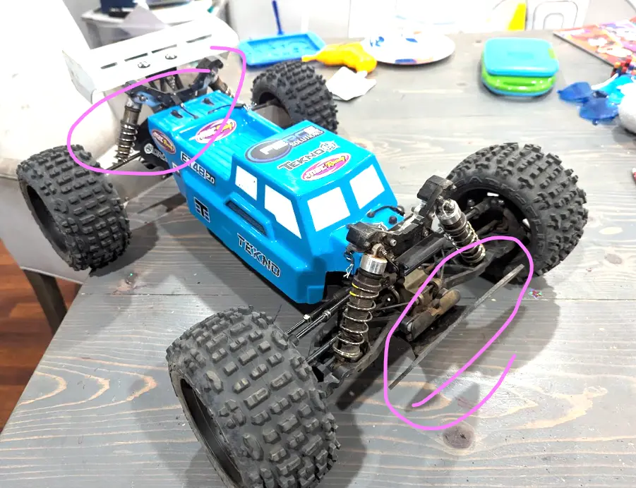

It's hard to see from this picture, but the bumpers I have on my M2C-modded ET48 2.0 are compatible with the EB48 2.2 since the buggy and the truggy share the same differential housing bolt pattern.
A few companies make these bumper styles—Phase1RC (Germany), TP (China/ AliExpress), and Oktay (Germany). The Phase1RC and Oktay versions are comparable in quality to that of T-Bone Racing, who of course, is no longer in business.
