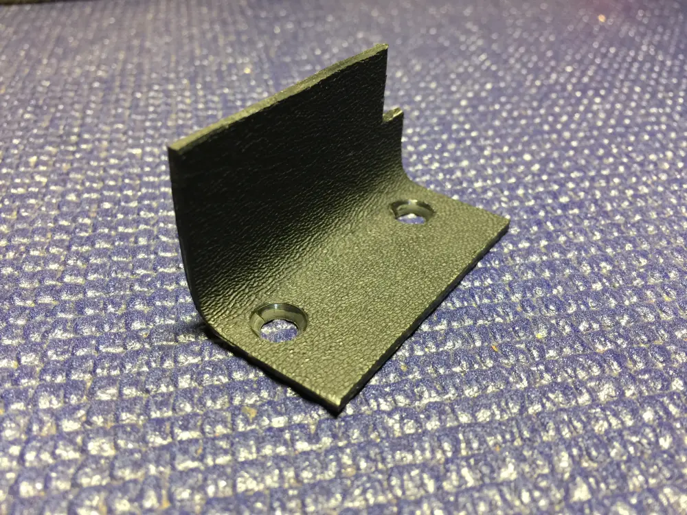

If you're running huge Turnigy Graphene batteries or any other soft case lipo (technically they have G10 plates on the top/bottom) it's extremely important to protect them from the center diff outdrive. I used a 2mm thick kydex sheet, a heat gun to shape it, then drilled the holes with a countersink bit.
2266
You'll want to use 2mm longer screws of course.

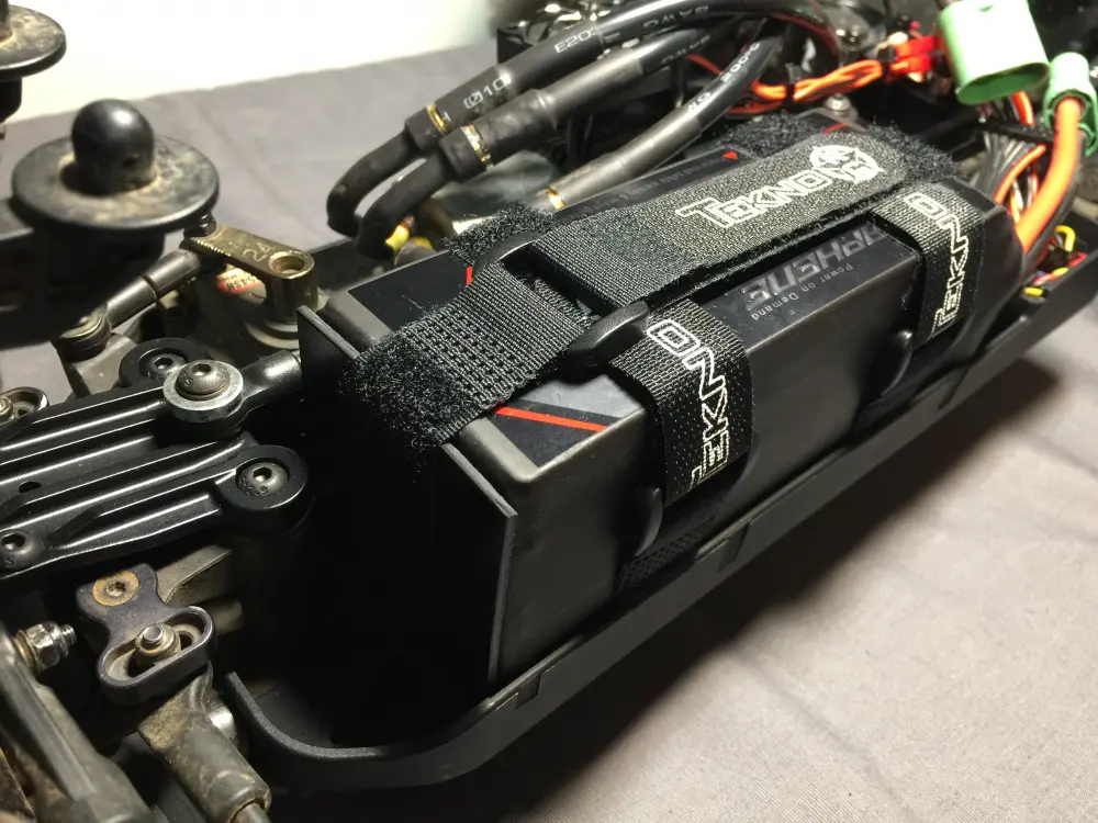

I also made one for frontal impact protection.
2268
The battery shown is a Turnigy Graphene 6S 5000mah pack, which are the best batteries on the market for big power setups.
