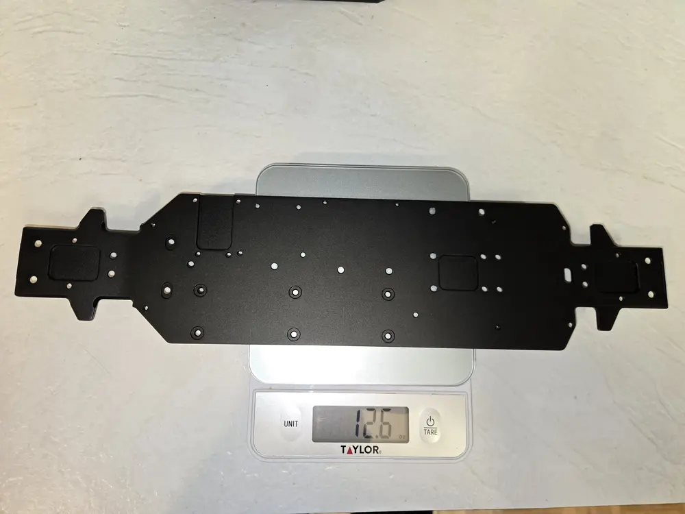

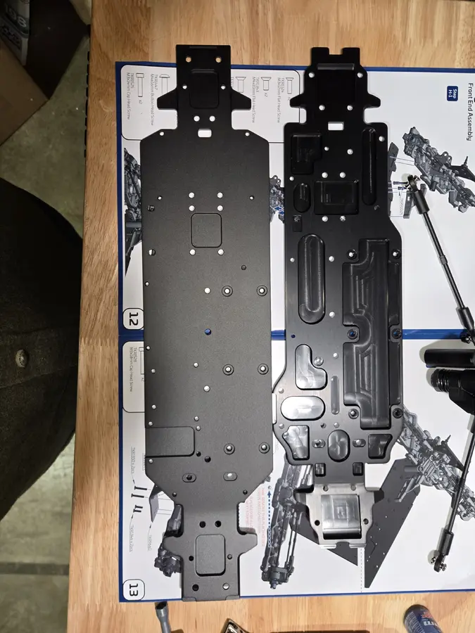

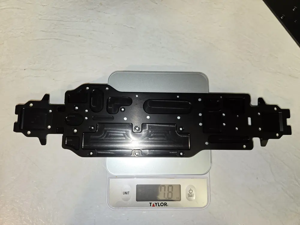

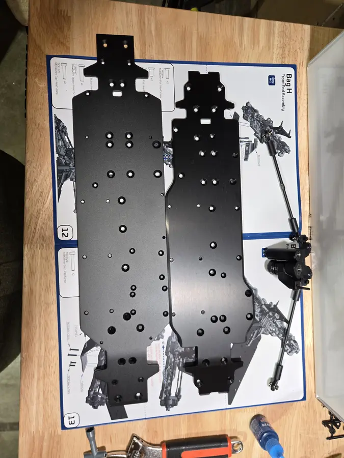

Here are some pics of the original MT410 chassis vs the MT48 2.0 chassis. The MT48 2.0 chassis is clearly more stout/heavier and longer. The MT410 chassis is 7.8 ounces while the MT48 2.0 chassis is 12.6 ounces. Both chassis are 4mm thick, but the MT48 2.0 chassis is solid with minimal cut-outs for weight saving.
Thanks for the comparison. Very different designs. Due to the longer chassis, the MT48 2.0 should be more stable in flight and less flippable than the MT410.
For the rest of the world that's:
221g vs 357g
As the guy who breaks everything I can tell you the MT48 chassis is massively tougher. I also think the mildly longer wheelbase improves the trucks handling significantly.

Yea and don't think the difference in wheelbase is as much as the chassis photo would have you believe.
