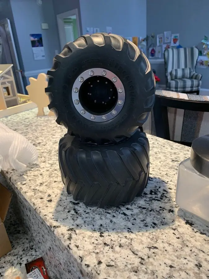

I got my MT wheels and tires in and it appears they are going to work. I was even able to mount the JConcepts tires on the RC4WD wheels (which are 17mm hex). I'm going to proceed with the rest of my build and definitely use your body mounting technique. There are several odd adapters and things I needed to buy to make these wheels work on the ET48.3 though. It should be interesting. I'll update my build post when I figure out every last detail. Still a work in progress. But these would look bitchen on your Monster Truggy!
