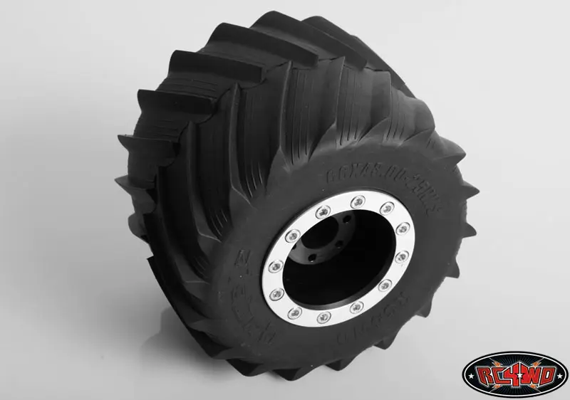

I'm tinkering with the idea of putting authentic looking Monster Truck tires (clickable) and wheels (clickable) on a Tekno. In order to pull this off, I need this 17mm hex adapter. These wheels + adapter will result in an incredibly wide truck, so I'm planning to install some Buggy suspension arms to compensate for the added width of these massive tires.

As far as tires go, I'm thinking more authentic monster truck style tires rather than basher style tires. So something with a proper wheel with respect to tire ratio. These are the Rumble tires from RC4WD. These wheels and tires will go together well obviously because they are from the same manufacturer.

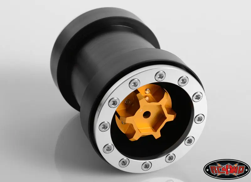

A picture of the wheels and tires that will work (the incorrect adapter is pictured, but they have 17mm)
The JConcepts Firestorm tires would look great if I can get them to fit properly on these RC4WD wheels. I like the aspect ratio of these tires compared to the Rumble tires. These are more authentic looking monster truck tires where as the Rumbles are more square and flat looking and are made for racing performance. I doubt I could ever race this Monster truck since it would never fit into any racing classes.

  • RC4WD wheels, universal beadlock V2 (Delrin)
  • RC4WD 17mm universal hex adapter (Revo/Summit)
  • RC4WD tool for universal hex adapter
  • TKR5116C - 17mm Splined wheel nuts
  • TKR5071C - 2mm offset wheel hubs
  • Blue threadlock (to thread lock the wheel nuts on after installing the adapter)
  • Monster truck tires
    • JConcepts Firestorms (My choice because they were the tallest and look awesome)
    • JConcepts Renegades
    • RC4WD Rumble
    • Whichever tire you choose, go with the hardest compound they have available. Harder compounds are less likely to balloon and since this build won't fit any racing classes you don't need the soft tires for best on course traction.

The wheels I listed above in my OP are the only ones I can find that will even fit a 17mm hex like this. They are pretty heavy. Wheels + Tires + the hex adapter ends up weighing 23.18 ounces per wheel. So that’s 92.72 ounces for all four wheels! That's 5.795 lbs of weight! I was googling around bashing wheels/tires, and the heaviest basher tiers I found that people are putting on an ET48.3 or MT410 are the Pro-line Trencher 3.8 belted, and all 4 tires combine for about 4.56 lbs of weight which is still 1.2 lbs less than what I'm considering doing here.
