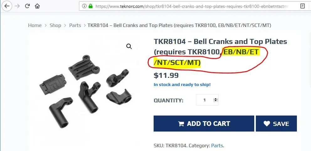

You did not specify the versions for each platform, but generally most parts along the center driveline will be compatible provided you stick with the SCT410.3 and EB48.3, you can visit TEKNO's website and they will specify all the vehicles that are compatible for a given version when you drill down into the part:
3139
Thank you. Yes .3.
That part is for the .4 which will require a major overhaul, you will be better off staying with .3 upgrade parts... I would avoid this slippery slope and just buy a used .4 which saves you time+money+hassle
If you are hard set in finding all the parts yourself, then just go through the parts for the .4 and cross reference all the part numbers, anything that doesn't match up with the .3 (which is almost everything) are the parts you will need to order from the .4 parts list. Yes it's "doable" but not in the least bit practical :(

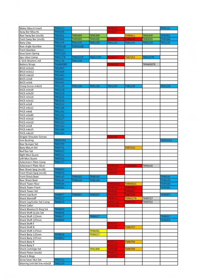

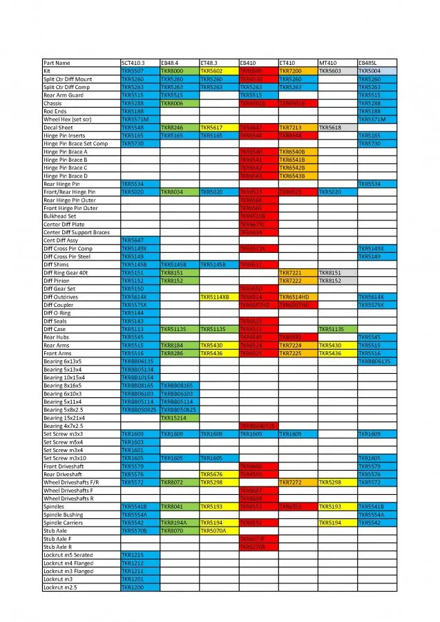

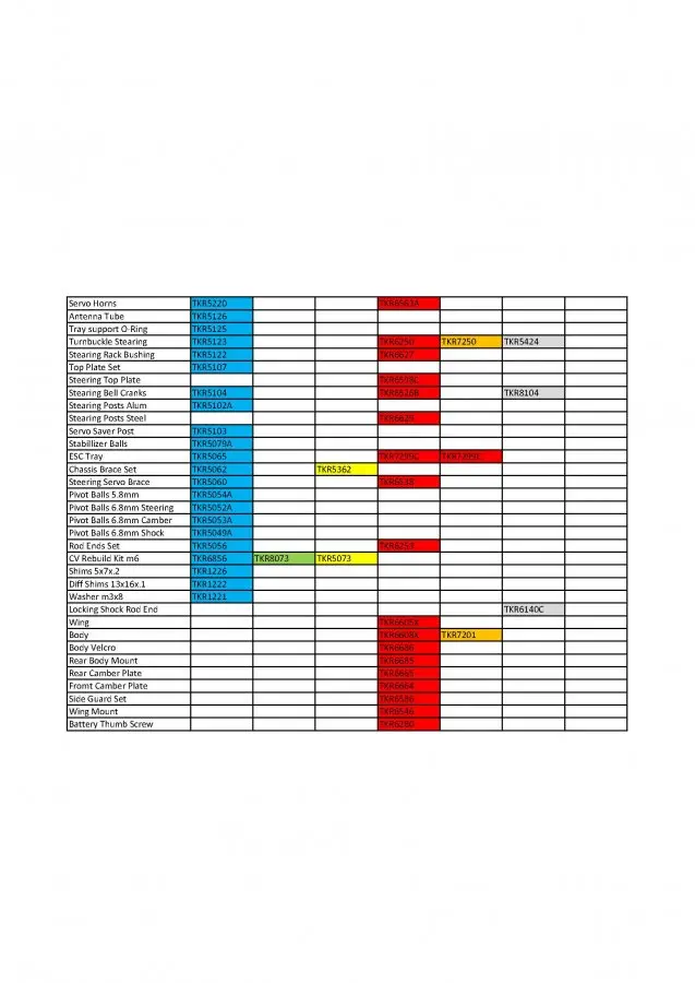

I started a cross reference list. I am unsure if the PDF will upload.
I cant say it is perfect, but this info I got off of the tekno rc website.
