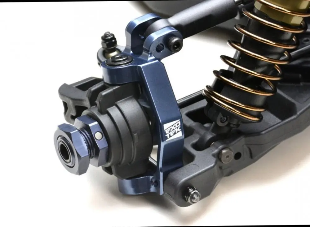

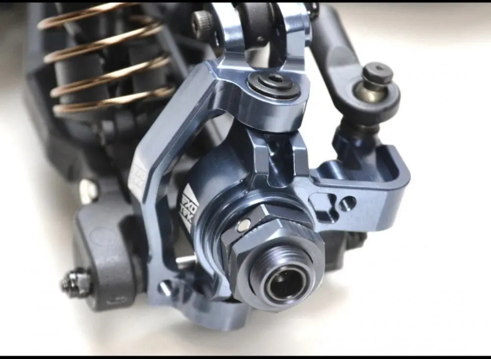

Hello, i want to get Exotek spindle carrier c hub and their steering spindles for eb48/nb48 for sct410. Have anyone make this?
