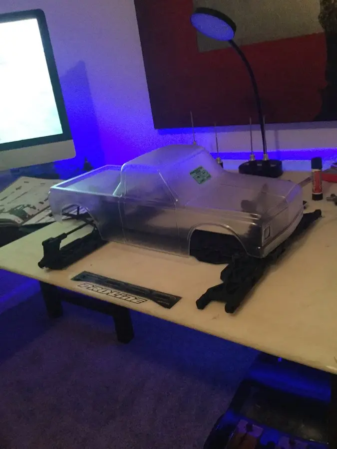

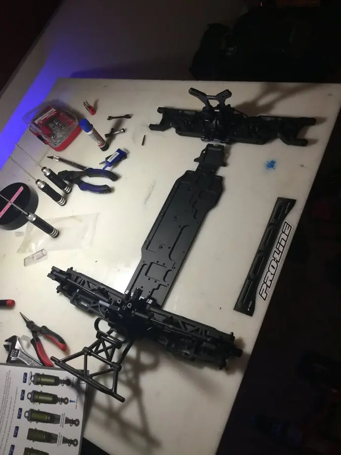

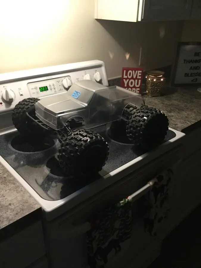

I just did the mt410 kit and I’m more than happy with it. The power to weight ratio is crazy and on 6s it’s a rocket, 4s is honestly more than enough but I prefer 6s and just using throttle control as my temps stay cooler. You can get the Arrma 1/8 box electronics pulled from a rtr kraton/outcast/talion for just over 100 bucks and it’s 2-6s capable 2050kv with tons of power (rebranded hobbywing). I have many different rc’s but nothing compares to this for bashing and just having fun.
